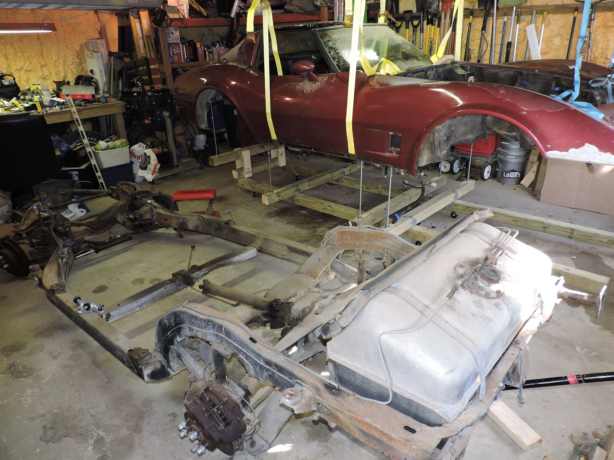

And here it is prepped to separate the body

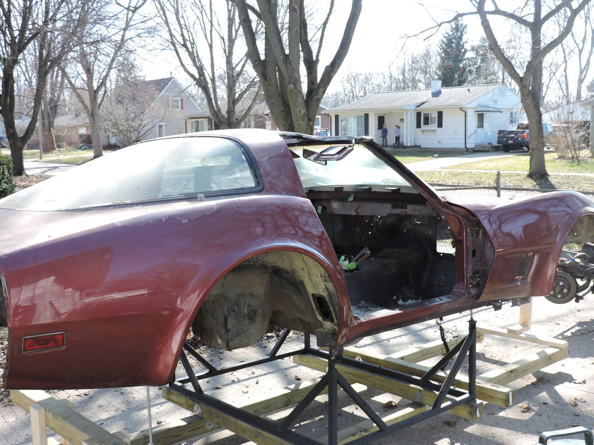

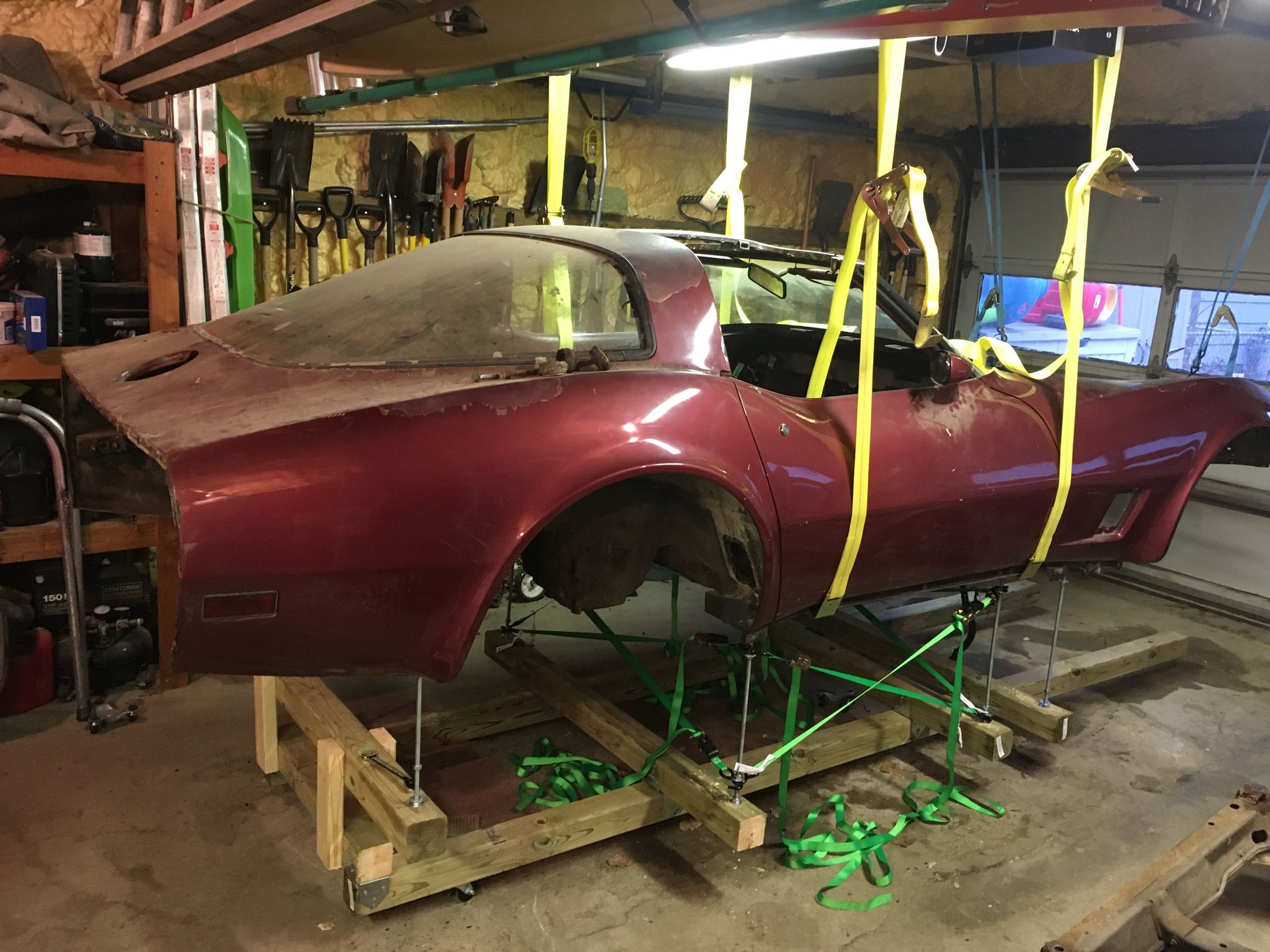

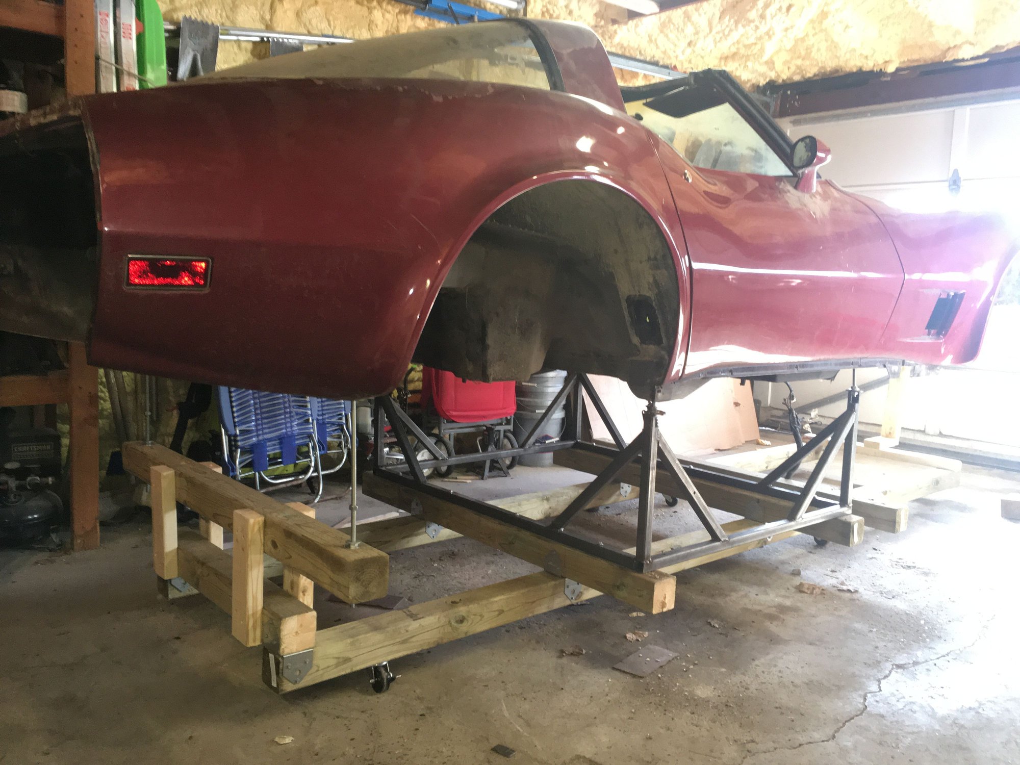

And here's where I am now. The Chassis and the body on their own carts.
Was hoping the threaded rods with ratchet straps cross would be enough to hold the body steady, but it was still pretty shaky. So I had to built the frame in the last picture to replace with and bolted it to the 4x4's Its very firm now, was able to open/close doors and push the cart around, no problems

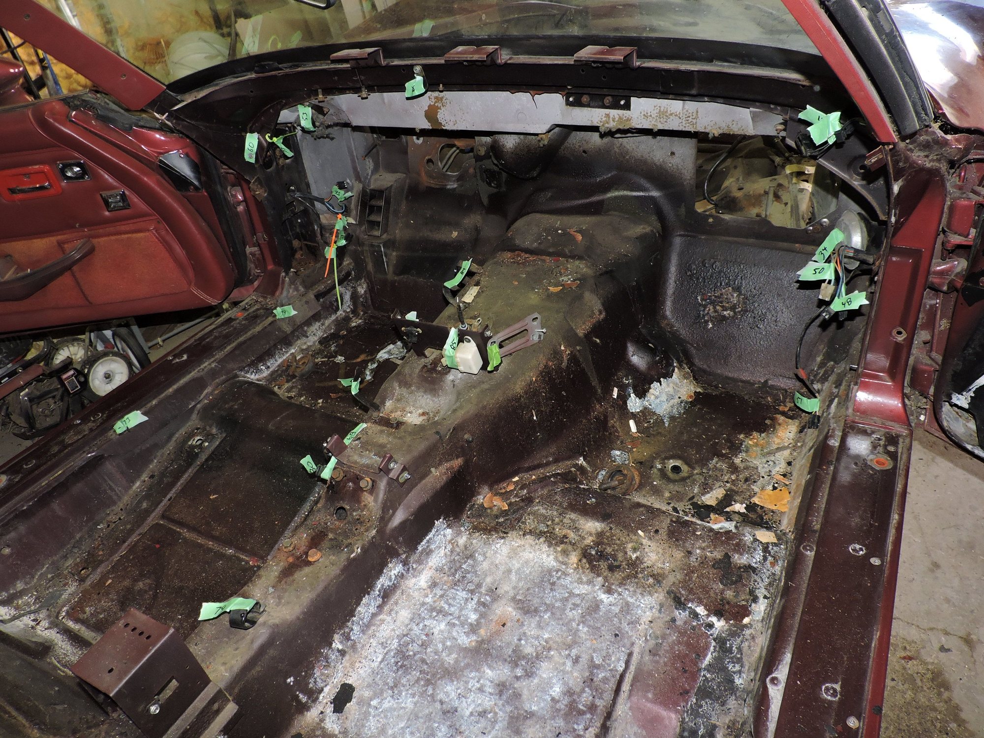

Haven't done a lot, needing some warmer weather to get things outside to power wash. I've looked into the options with cleaning up the chassis, right now I'm thinking of going with acid dipping to strip it then paint, likely will introduce some colors to the chassis and underbody as well...

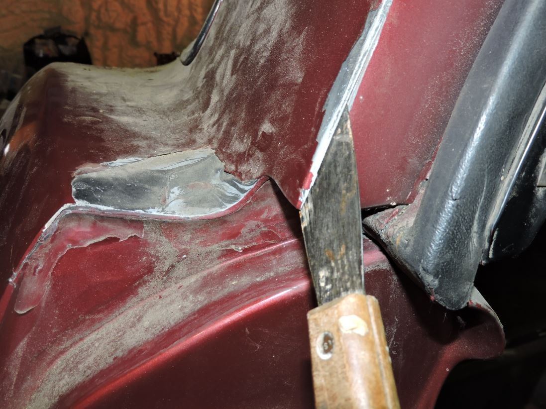

Started looking over the body a little closer as well, trying to figure out what to do there. I'm starting to wonder if I need to remove the fiberglass from the bird cage and get that dipped too.... The rust isn't to bad, but I'm concerned there's going to be some I can't get to like along the top of the rocker channels. as well at first I thought it would be way less time to clean up what I can rather than take the fiberglass off, now I'm not so sure, by the time I pick around some of these tricky areas that are hard to get to and only get 90% of it maybe the time would be better spent removing and re-installing the fiberglass.
I might look at maybe just removing the firewall, that might give me the access to sand blast these areas.

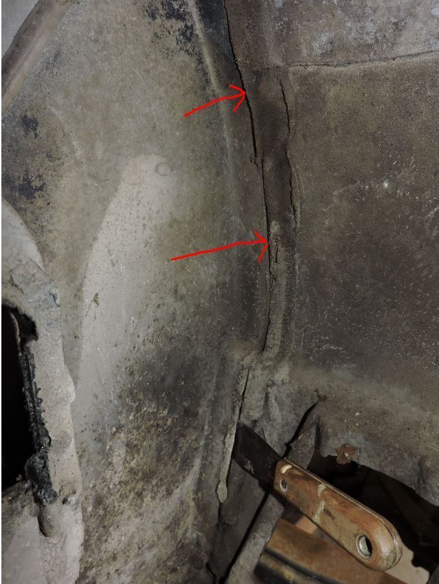

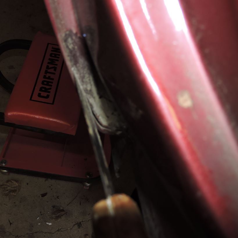

I also have several areas where it looks like the panels have been worked on or are coming apart some. the panel to the left fender is loose all of the way down.

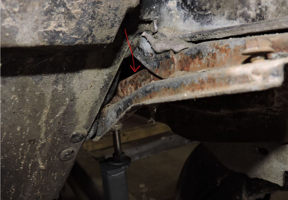

the rear clip has some as well, along the right side quarter panel to door jam

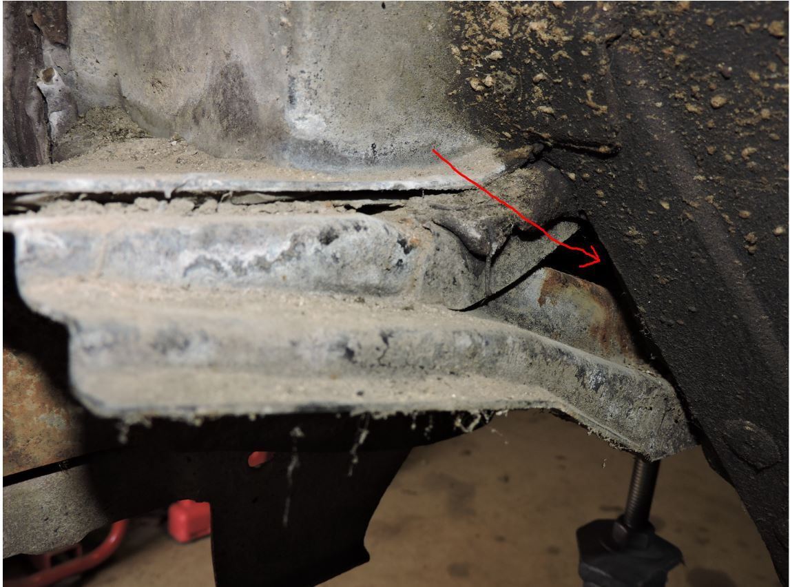

And in the left quarter this support is completely free or the rear hatch panel and has about a 1/4" gap.

I'm surprised that doesn't tip over on you! Those wheels should be out further under the weight where the rods are.

LOL... It looks pretty sketch I know. but its actually really really sturdy. I don't, but I can actually push it around at the doors and it still doesn't come near tipping. I pushed it once and one wheel went over the the floor drain and it still wasn't tipsy. I did it that way so where it hangs out for the nose they wouldn't be too far apart, but in hind sight yeah they could have been out closer to the rods for sure.
Did you see the ratchet strap design? That one never made it off the hanging straps

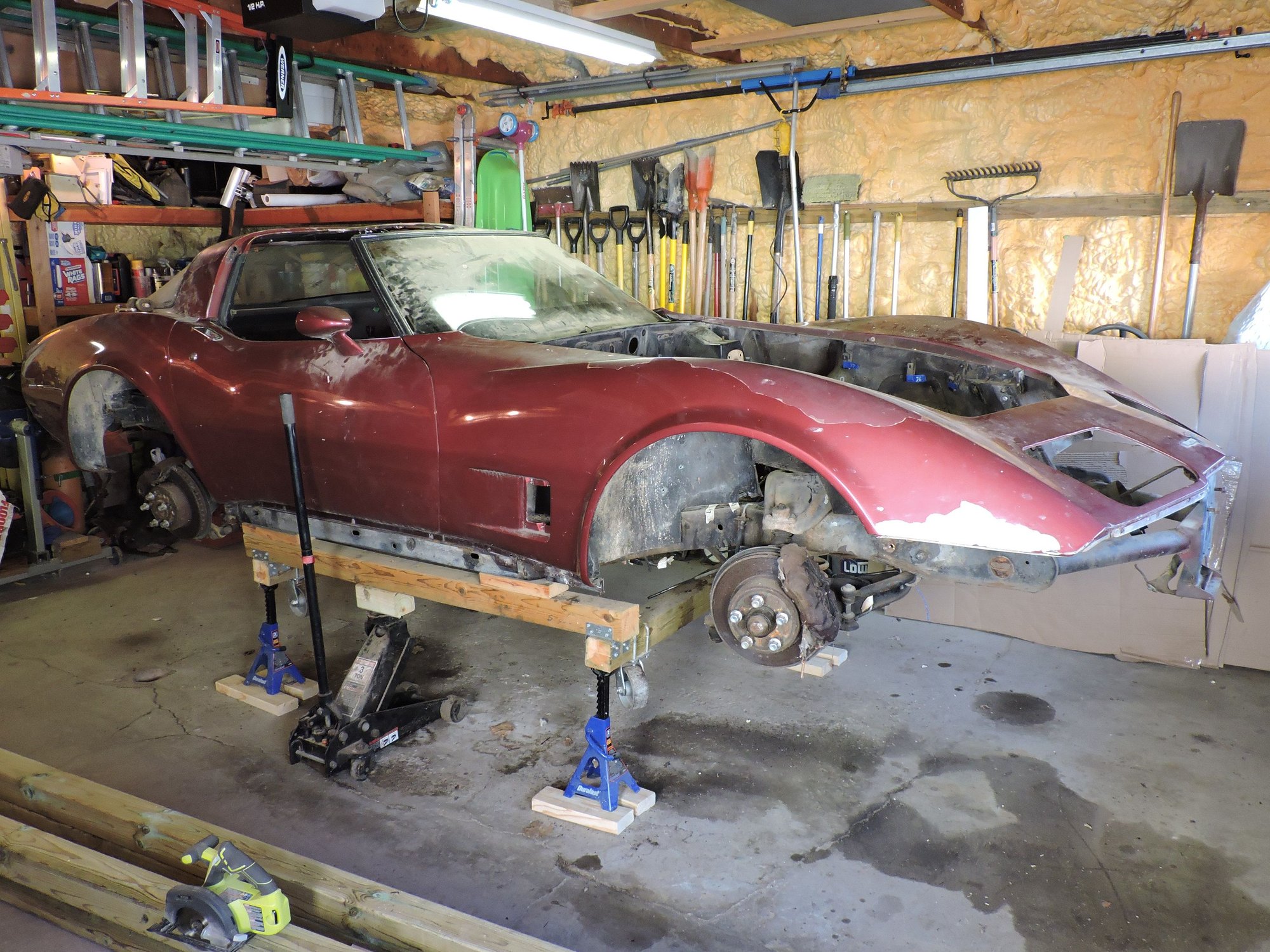

Yes and I closed my eyes on seeing the car on the Jack stands. WTF! Are you a cat? lmao! You have 9 lives? Lmao!

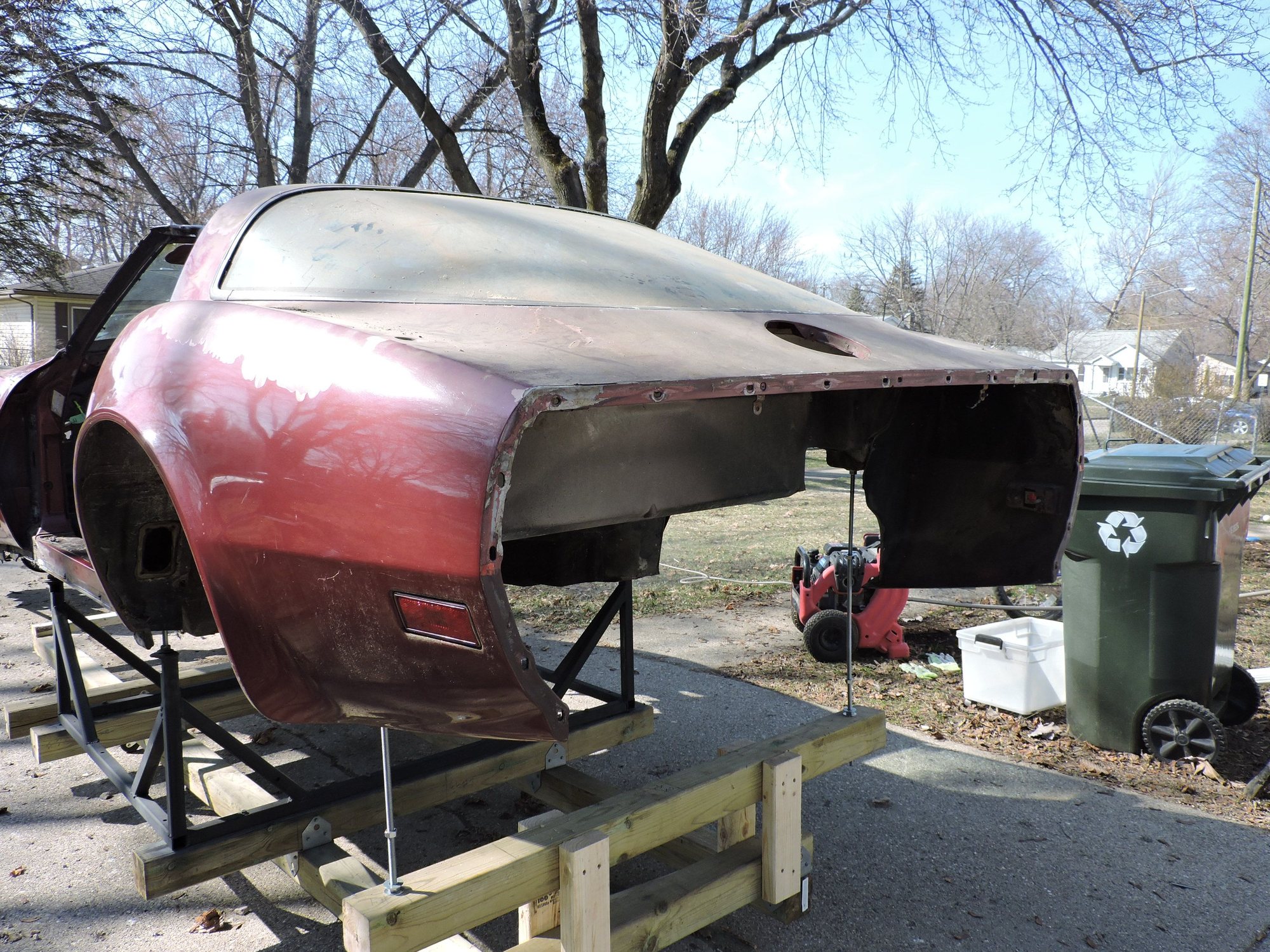

Well took the doors off and got it out of the garage today to power wash the body and frame, first time its been out of there in three years. Was happy with how much I was able to get knocked off even with just water. started picking at different seams around and pretty well convinced at this point it will be worth pulling the fiberglass off the bird cage... wish me luck.

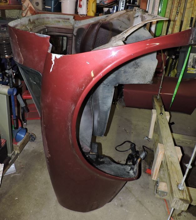

Well it took a couple nights to get it, but the rear clip is off. There's a little more damage to the fiberglass than I had hoped, but not as bad as it could have been for sure. putting it back together will be interesting....
I first worked the rib out in front of the halo off, then worked the latch panels out then the panels around the body bolts. Finally cut through the glue over the halo and as much of the floor pan as I could get. Put a strap around it and started working it apart.

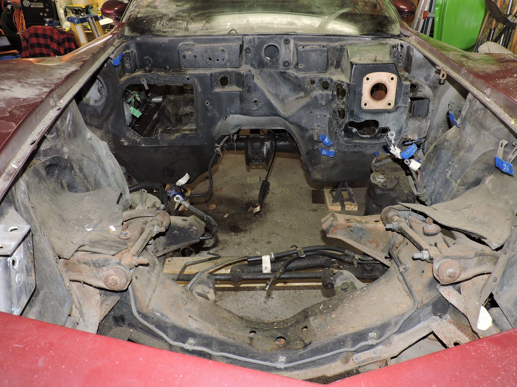

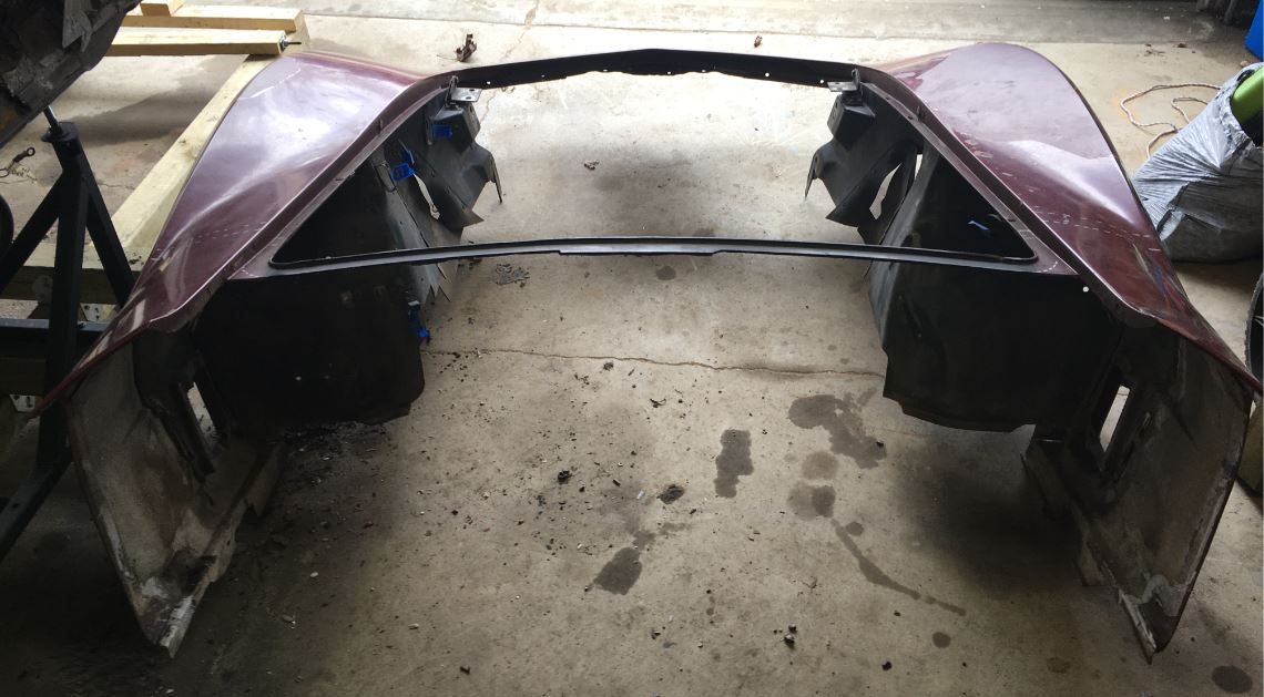

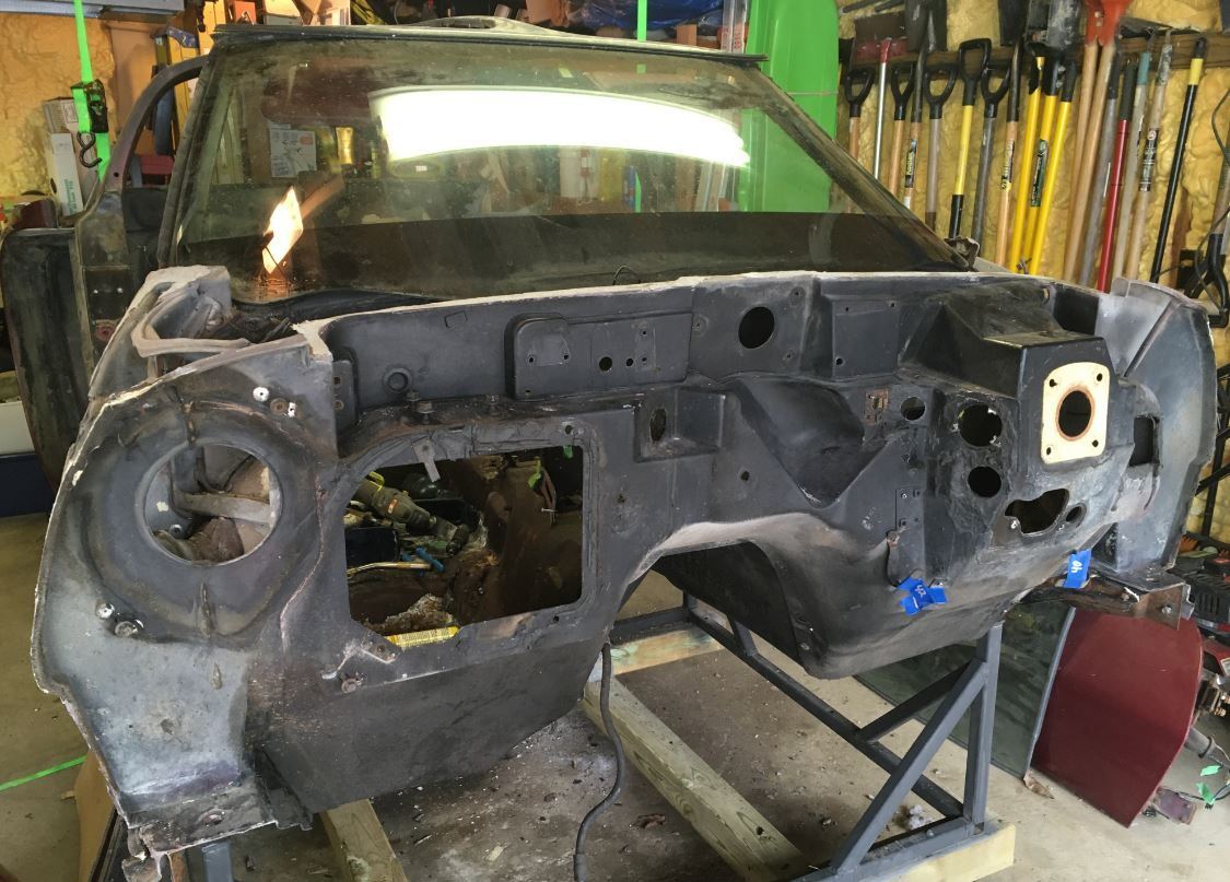

Well got the front clip off now too, here's link to the thread showing more details of the work - https://www.corvetteforum.com/forums...tear-down.html
Now to remove the windshield and firewall and the bird cage will be ready for prep. Next will probably be to strip down the frame so its ready to go as well, but I plan to wait until things get opened back up and caught up a bit before I send them off.

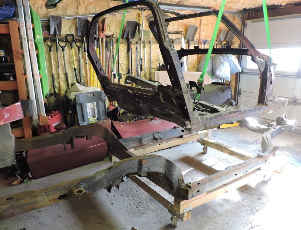

Well tonight marks a major milestone on the project. I removed the last pieces of the major tear down and prepping the bird cage and frame for cleaning and painting. Now to get the rest of the pieces broken down to send as well and start repairing, prepping and priming the under side of the fiberglass lips and firewall.

You went a lot farther than I would be capable of doing. But, the frame & birdcage look to be in decent shape (unusual for a Michigan car!), so now you have great confidence that your finished car will be in great condition for many decades. Don't know what method of metal protection you will choose, but verify that the process won't leave corrosive chemical residue inside the frame/cage....or be certain to neutralize it before rebuild. There are long paint 'wands' that can get paint to nearly all of the insides of frame/cage once the metal is cleaned/prepped. Keep up the great work!!

Looking at the bird cage pictures , it looks to be in pretty good shape. Blasting surface rust off with some sort of material probably would be best. Removal of all the media that gets inside hidden areas is the problem. Liquid rust removal has the same problems, flushing all the remaining liquid and neutralizing the chemicals is most important . if not done completely you'll end up with a pile of tin. The next thing I thought about is powder coating. It is a very durable surface coating that a lot of guys are using on frames, suspension parts and many other items. In your thoughts of powder coating the bird cage, will fiberglass or any bonding material stick to it?
