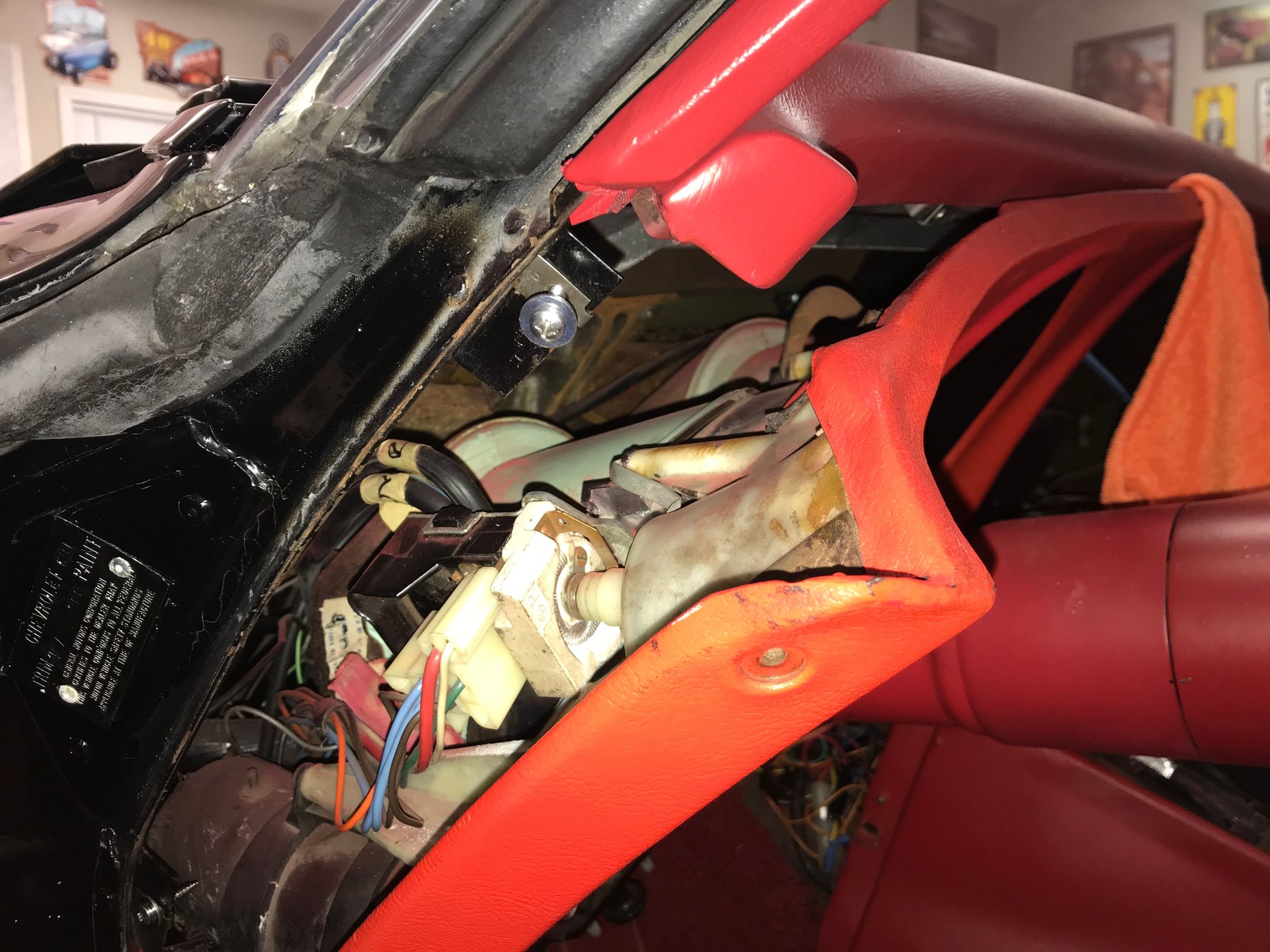

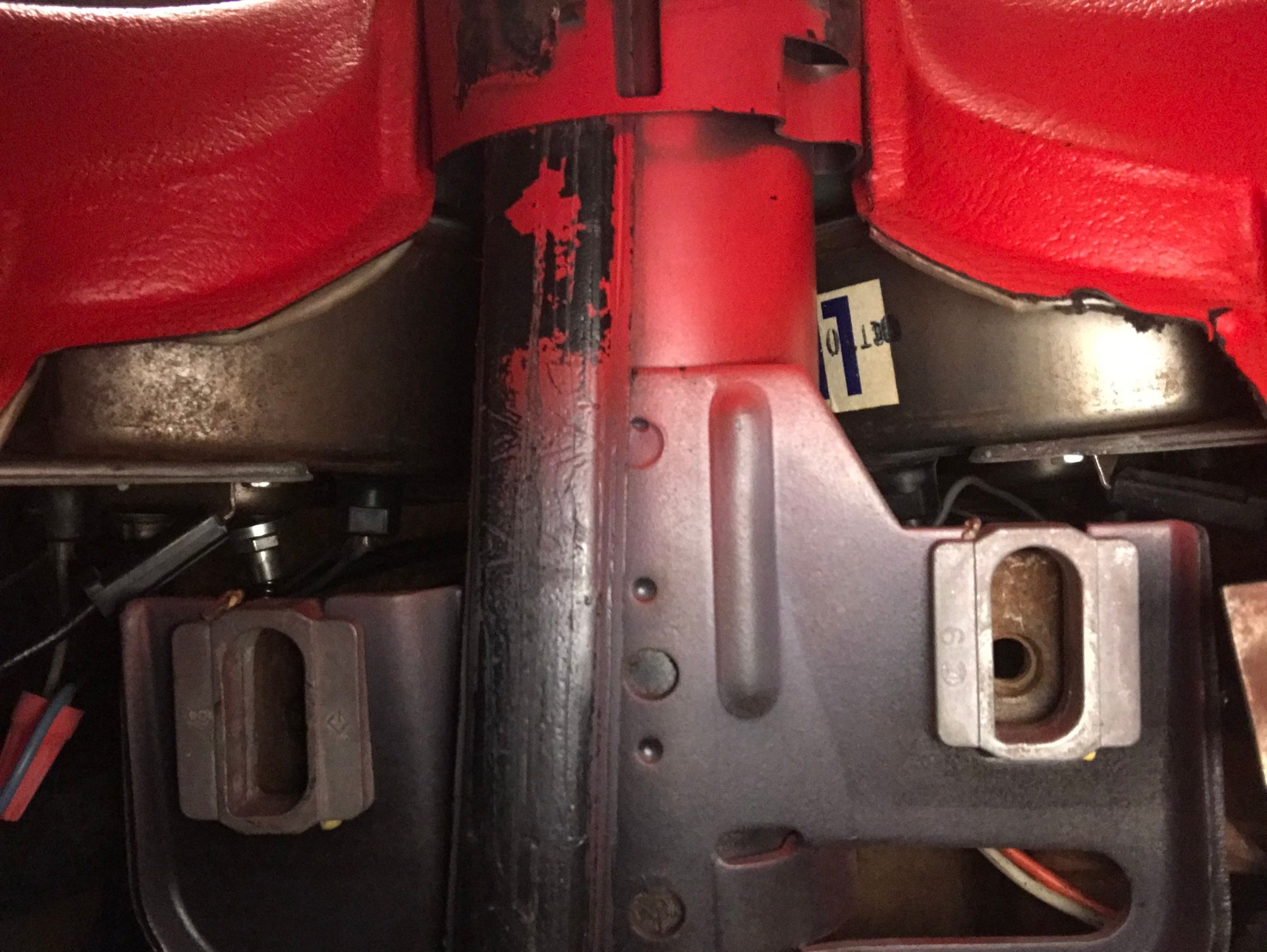

Yes, that is correct. The LH Lower Dash Pad on my car comes loose by removing the two screws along the door jam, the three screws that secure the top of the lower dash pad to the upper dash pad. And, I was able to pull the steering wheel down along with the Lower Dash Pad and reach my hand in through the opening at the top left corner of the lower dash pad. Seemed like easier access to me than laying on my back and trying to reach my hand up through the bottom of the lower dash pad. Just be real careful pushing and pulling on the lower dash pad so you don't crack anything and watch out for the lower corners and edges of the lower dash pad too while you are opening up the top left corner.
LH Lower Dash Pad with the screws removed
Bolt locations that secure the steering column once the vinyl trim cover was removed
