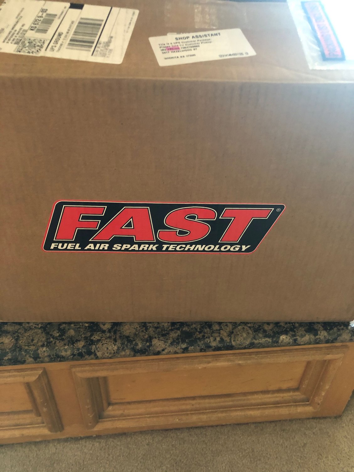

Received my FAST EFI for my C3. Should go in next week or so.
