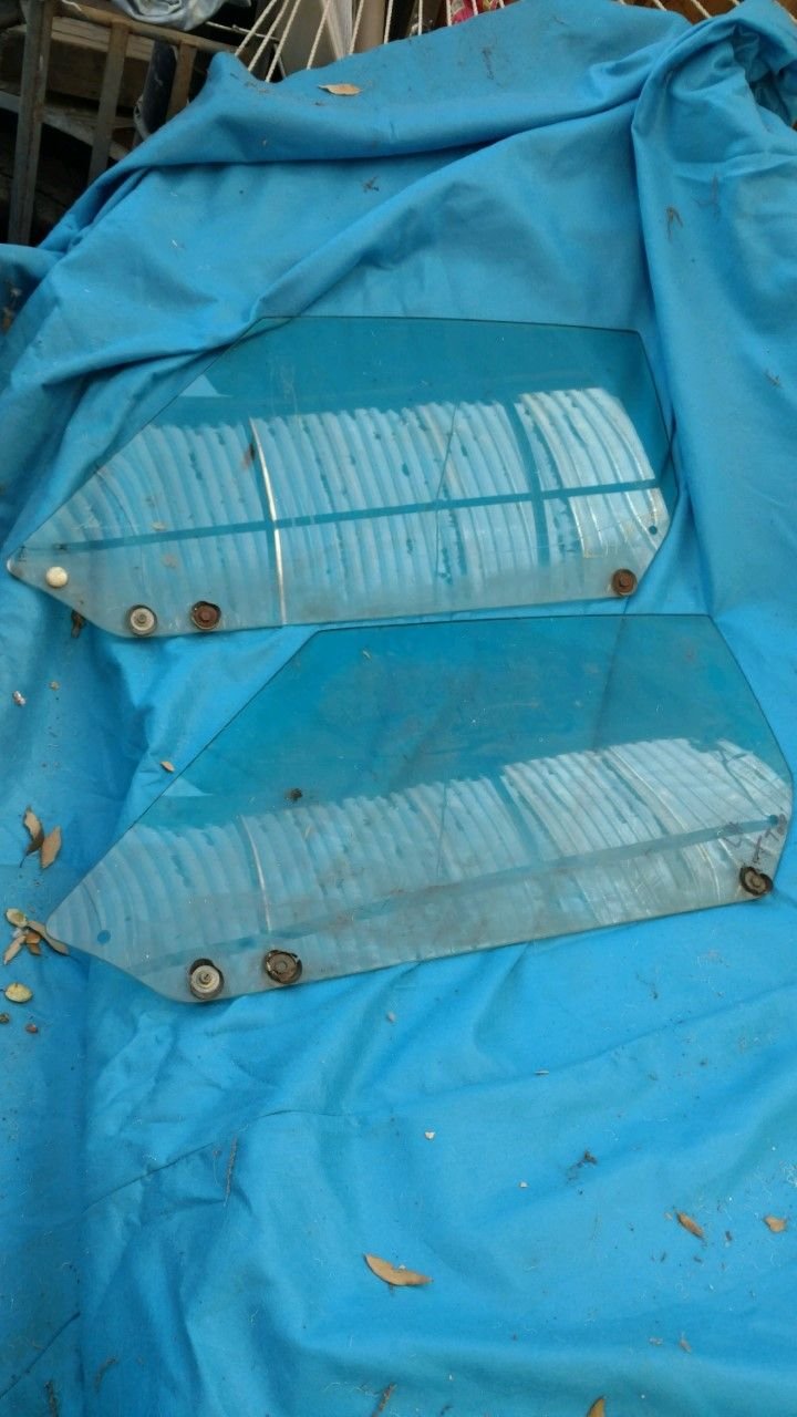

Windows - I have one that has "Astro" written and one that says "t-top" They look exactly the same shape, holes/placement. (see pic) So, what fits a 68-72 vert?

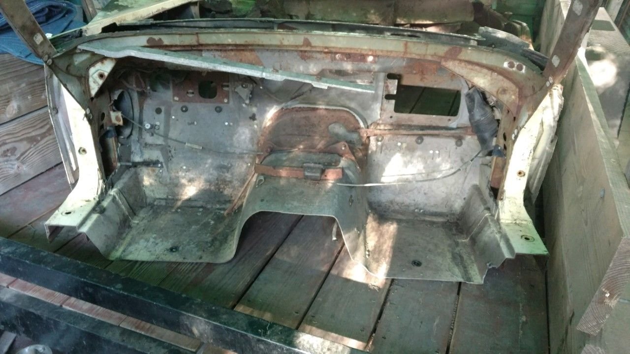

And last question regarding a C3 vert windshield/firewall section I have. The trans tunnel has a plate with what looks like a factory made missing area and depression in the tunnel too. What is this for/from? see pics below

No Targa top glass , like you have there , will fit a convertible.
Convertible glass has an angled rear edge to fit the soft and hard top.
Astro ventilation sticker , well USA was in the space program big time, so a name to tie corvette to the astronaut program .

Early C3 door glasses are marked Astro-Ventilation. Nothing should say "t-top". That said, coupe and convertible doors glasses a different. Your firewall section looks to have to brackets for under dash supports and console support.

An AIM is a good suggestion if I had a dissembled 72 but I don't so please don't take this wrong. On one hand I have a rolling chassis with a body that only has doors and decklid, perfect for a road racer. The other side, which is the basis of my initial question, is that I will have another C3 vert carcass (future drag car) and a ton of duplicate C3 parts. 10 doors - many with guts, 12 door windows, 10 spindles, 3 radiator supports, 6 hoods, 14 front bumper brackets, 6 dash speedo/tach, 6 driveshafts and much much more. So, I want to keep just enough for one car and sell the rest. The trick is what to keep such as bazza77 helped me, it appears none of the glass will work, so sell.
