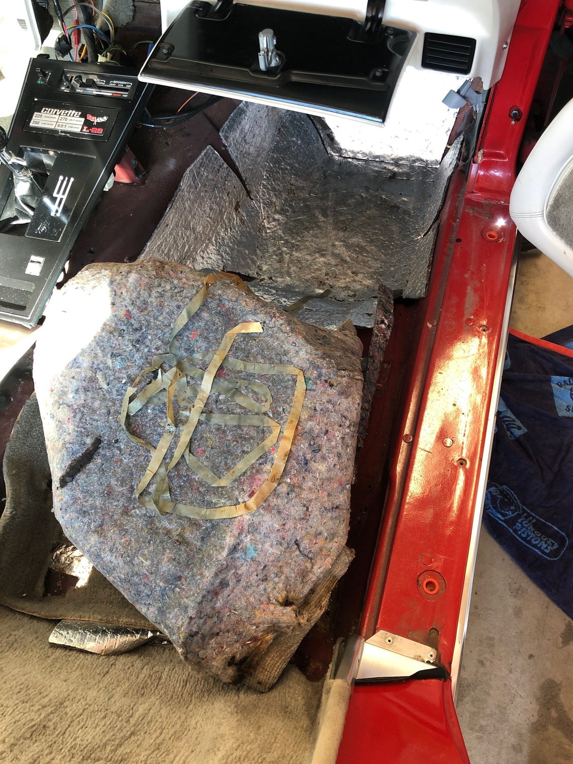

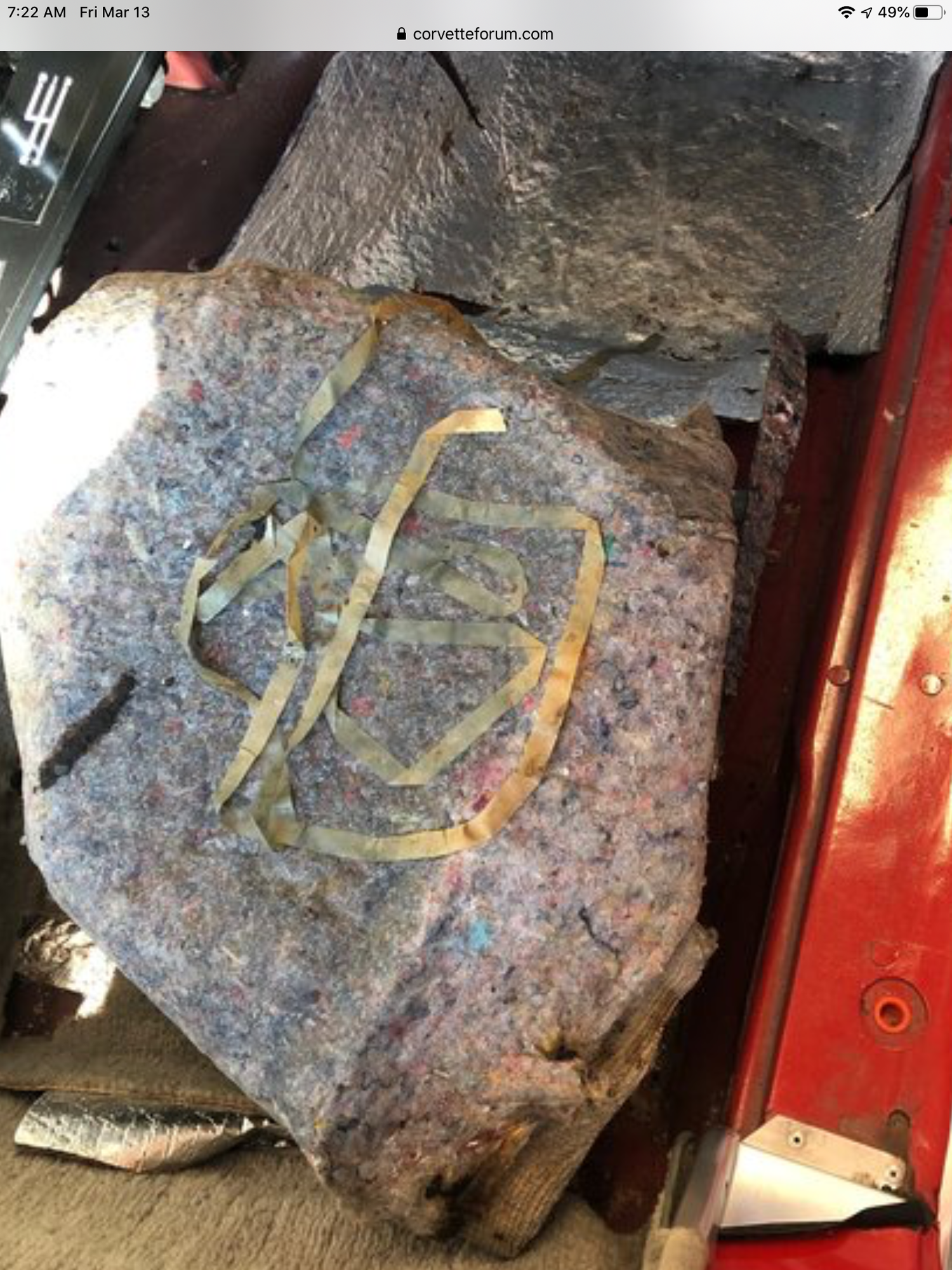

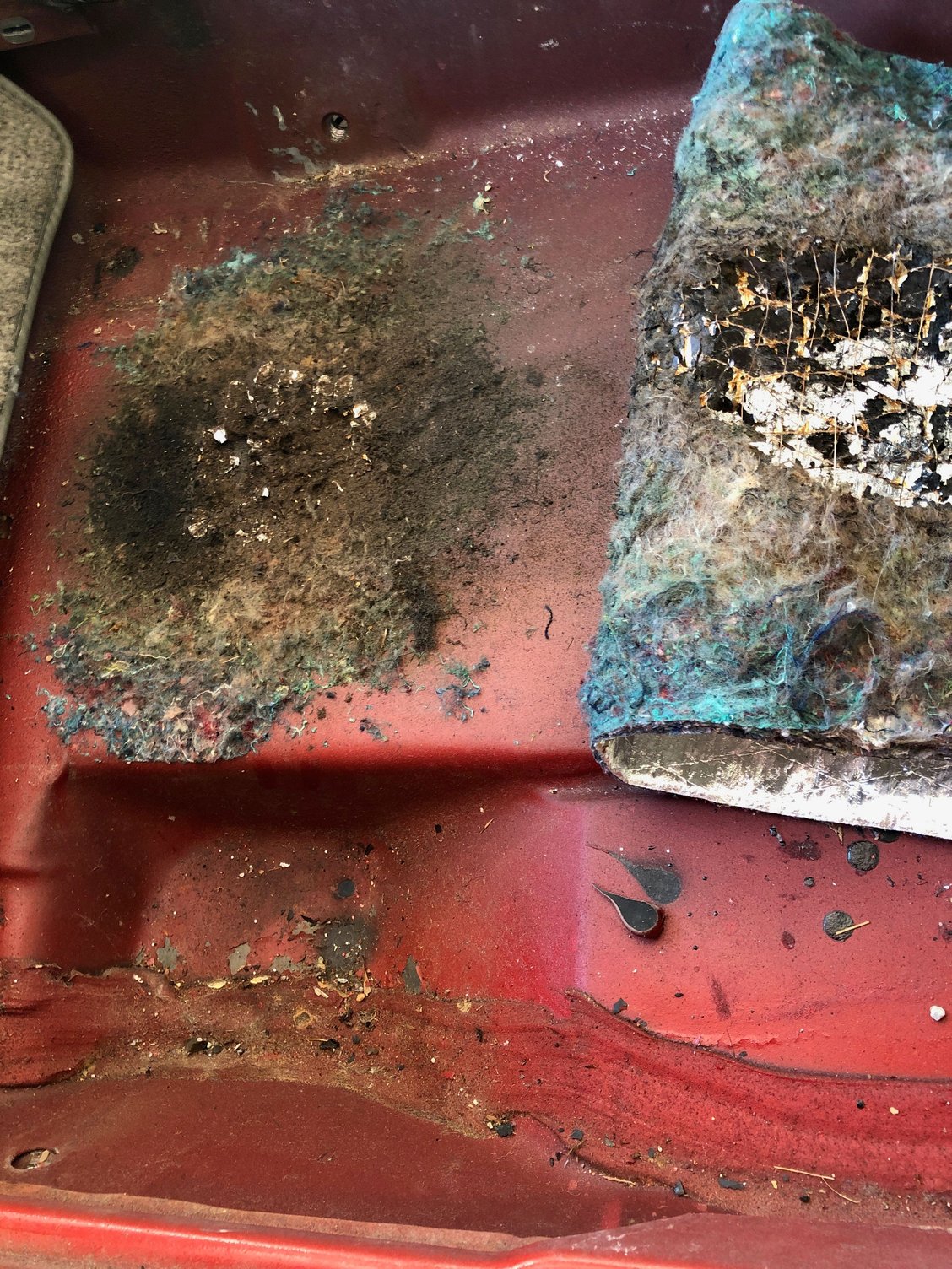

I used alum foil and spray adhesive mine
maybe these pics help?

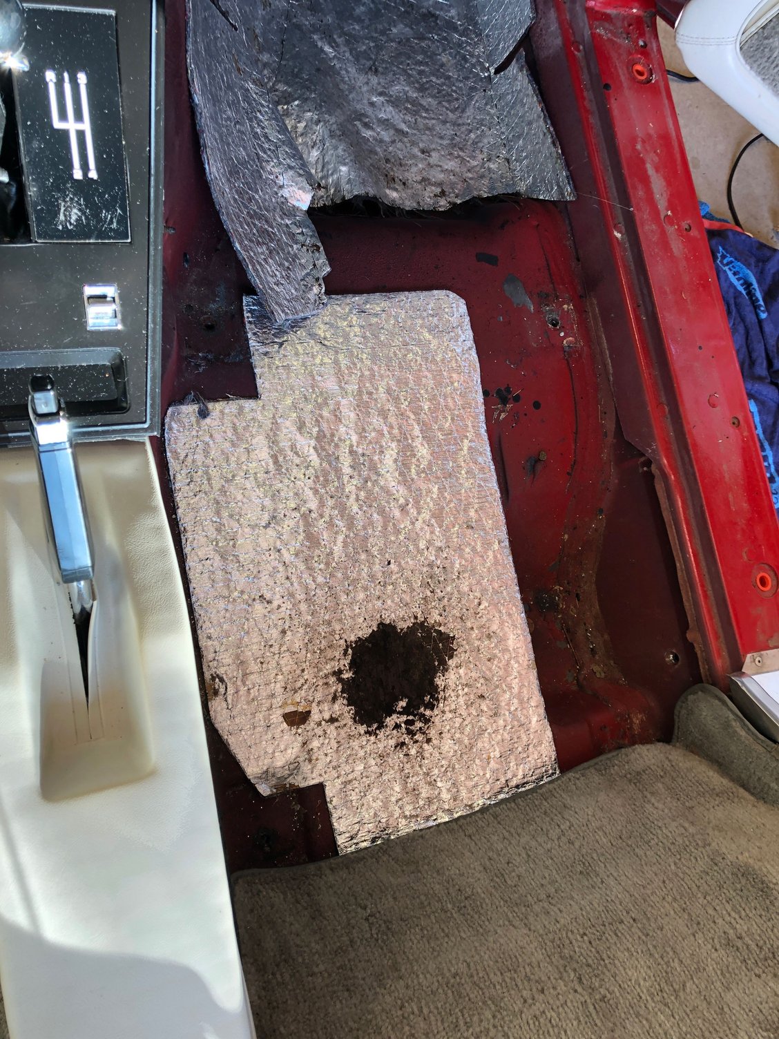

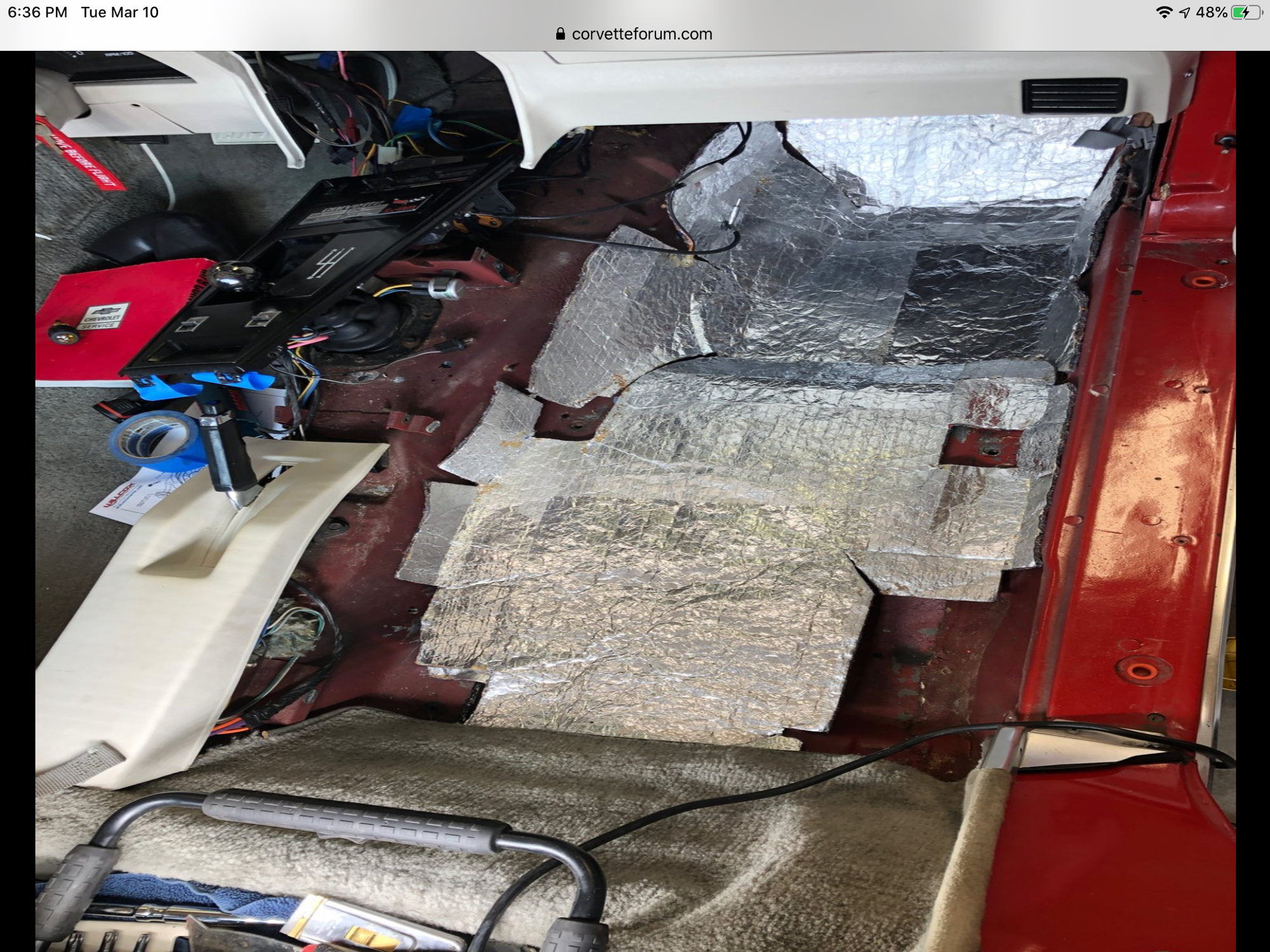

Heres another
mines 79

Thanks Interpon for the pictures. After manipulating the Underlayment, it does seem to fit with the foil side down. However, like you have it installed, it seems to fit more naturally with the foil side up.

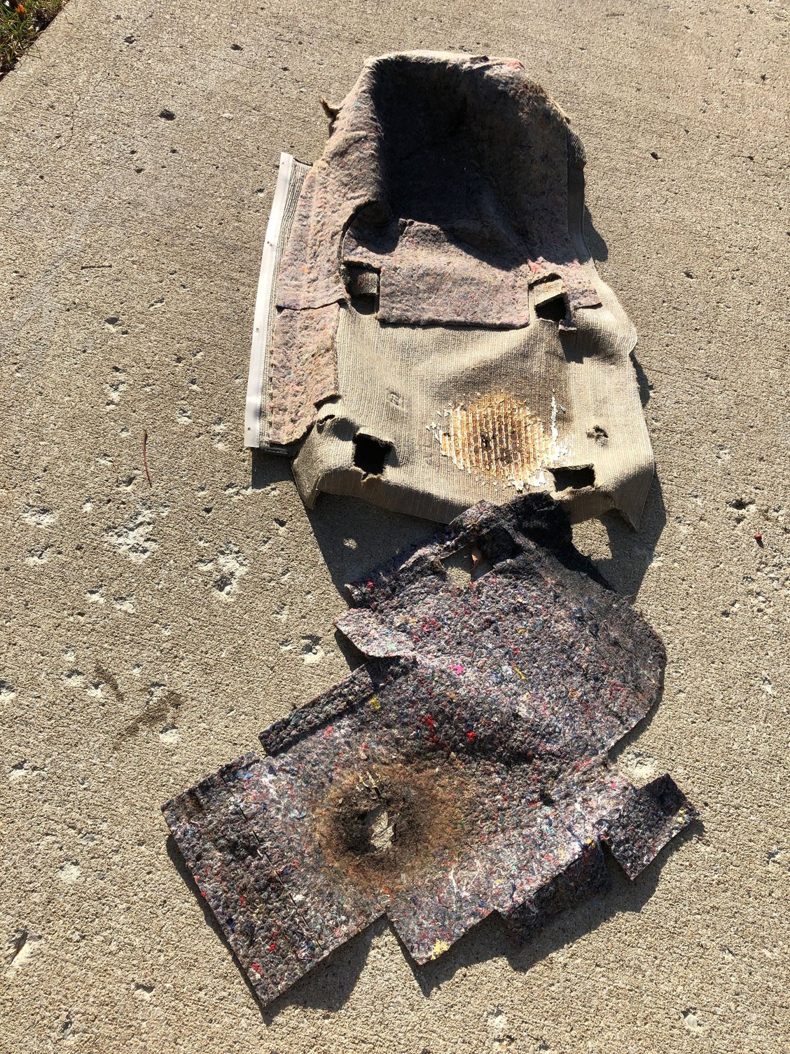

i am 99 percent sure the carpet i took out was original..even the painted rivets and backing from factory tape sealing the vents..i noted the sloppiness when i removed..also where the cat burned the floor was like peeling tape
Matched to backing of factory foam in the heating ducys..ripped out from leaking heater core

forgot to say..i had rattle as well where cat is..now is a great time to add some heat and sound insulation..dont need to cover it all just certain areas..dont put behind pedals...really quieted down..
Amazon..not too pricey..worked great only used on passenger side as i was redoing heater core
