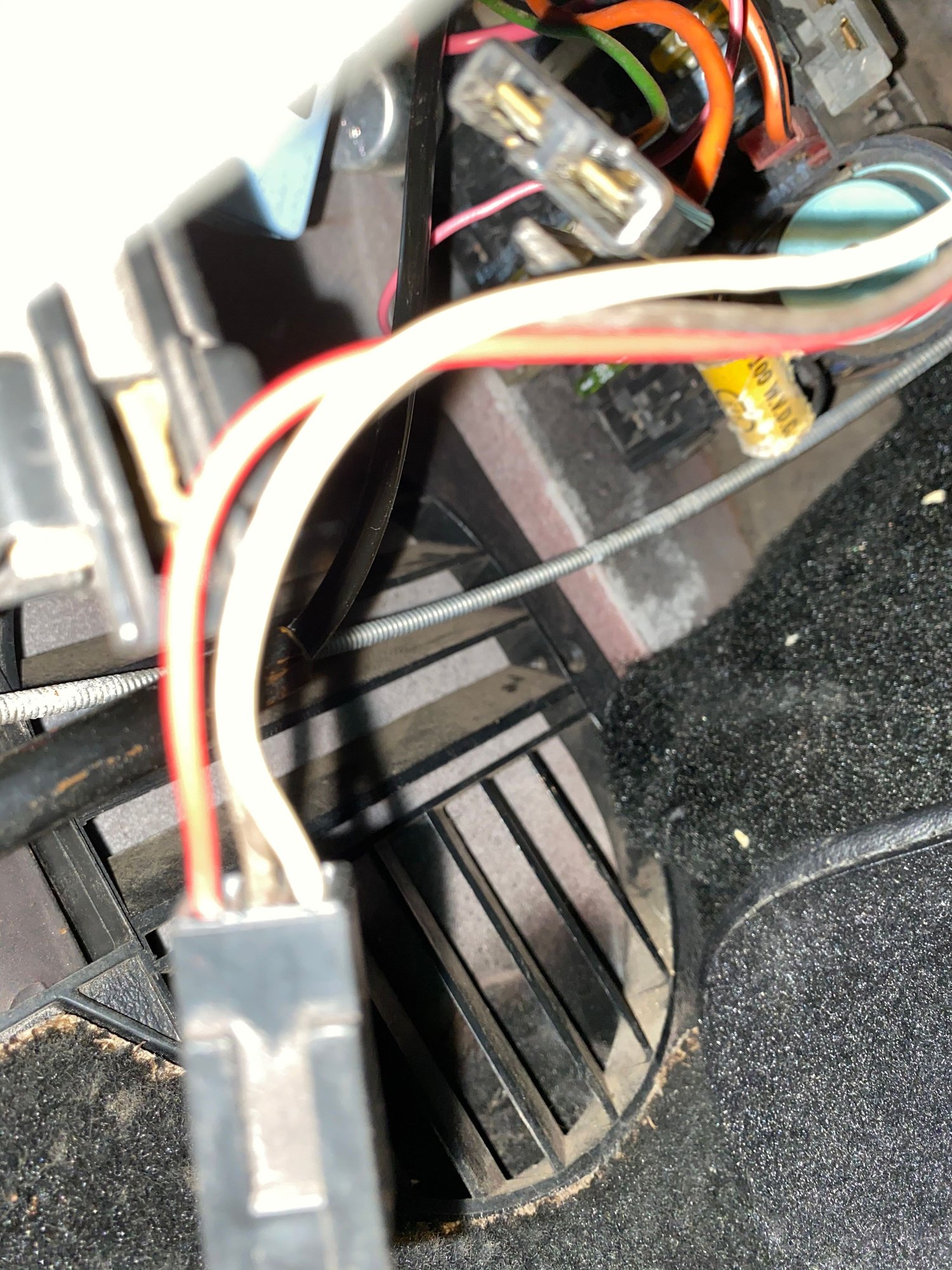

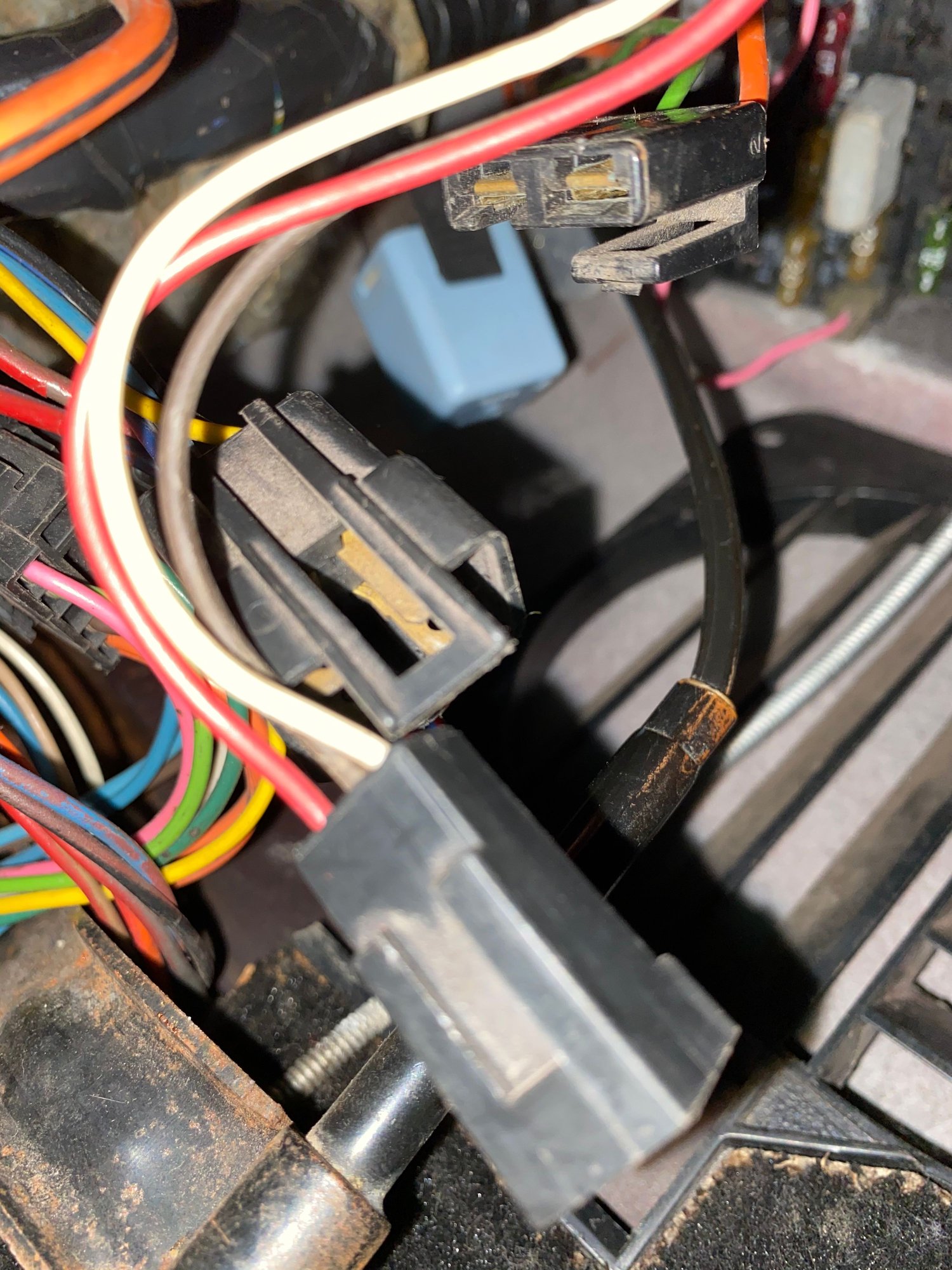

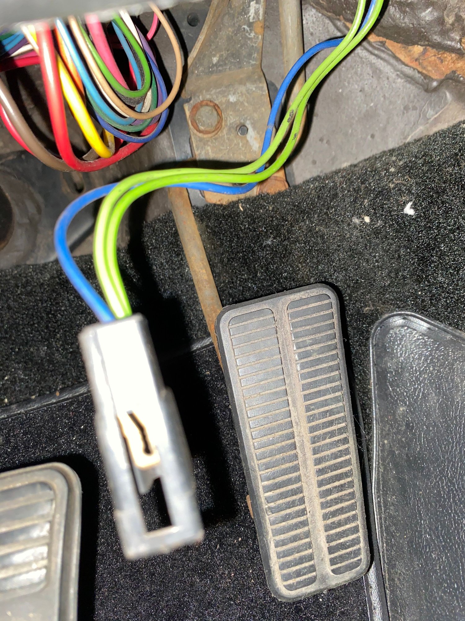

You all win. I did kind of assume bigger problems. It’s not a fuse. The engine has be reworked. Lots of stuff so while messing with fuse box see all these wires unplugged. Want to do stuff on my own but don’t know where to start

Well, start with a wiring diagram.
http://wordpress.keystonestatecorvet...m/?page_id=118
And then order an owners manual, shop manual, and assembly manual.
All of the vendors carry them (be sure to get the GM version), even RockAuto. You can find OEM manuals on eBay, too.
I think that the flat connector goes into the key buzzer.
http://repairs.willcoxcorvette.com/1...p-buzzer-info/
Congratulations on the car. Looks sharp!

Willcox Corvette offers a free .pdf download of the 1978 Corvette Electrical Troubleshooting Manual. This manual is 1978 Corvette specific not like the standard GM line diagrams you may find online.
LINK: https://drive.google.com/file/d/0B28...JrTURuMGs/view
Note, The flat connector Bikespace points out is on page 18 and is in fact for the buzzer. C122 is the connector. #14 Orange & #20 Lt. Grn as an example of how GM called out connectors.
And it looks as if your buzzer unit is missing, see the empty Long White connector on the right side of your fuse panel.
