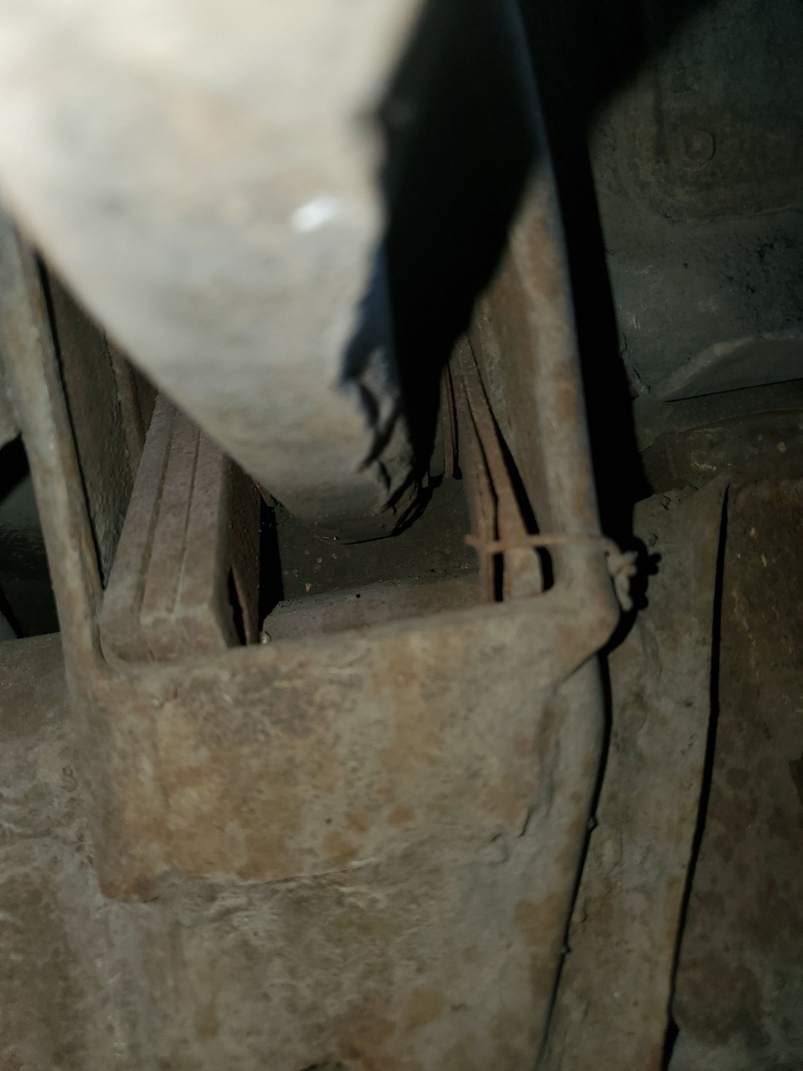

Old Mar 22, 2020 | 02:12 PM
RockyL32's Avatar
RockyL32
Joined: Jul 2004
Posts: 1,194
Likes: 111
From: If your not the lead dog the view never changes Boise, Id
I don’t think the bushings look bad. Here are a couple pics
