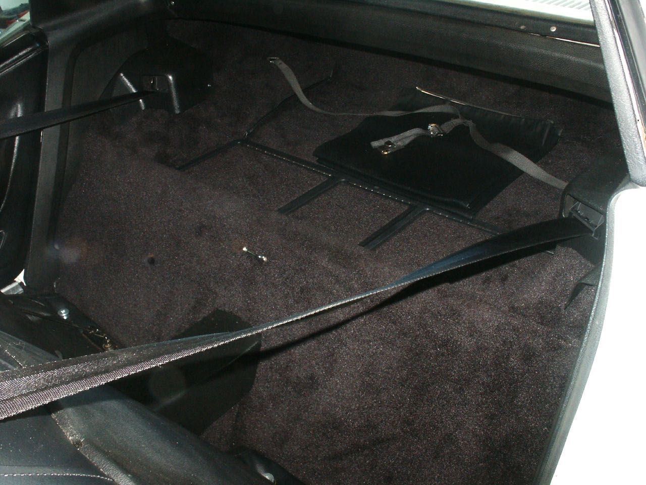

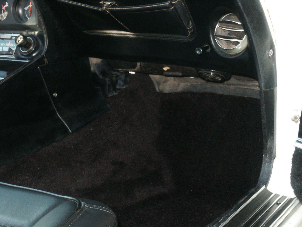

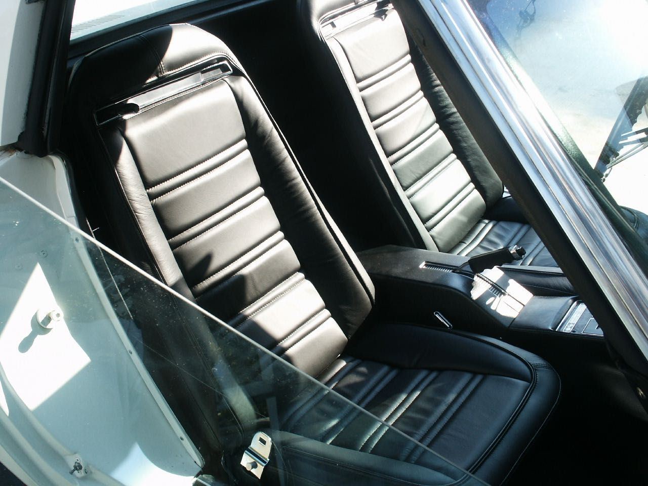

My 73 is original that I bought in Dec. 1972. The seats are leather except the sides and back. I replaced mine with new foam and seat covers from Willcox. The door panel was the same material as the dash and console with the cut pile carpet on the bottom. I liked the wood grain on mine, but had to replace it several years ago.
My original was a darker wood grain than some of the replacements you can buy. Mine looks about the same color as my original.
I made my own inserts from some walnut panel that I had.
I got my carpet from ACC auto custom carpet and it was a perfect fit. You just have to trim around the console and the door edge. Was not a problem, just be sure that you test fit around the console before you trim.Here are some photos of my restored interior.
Here is my interior after:
