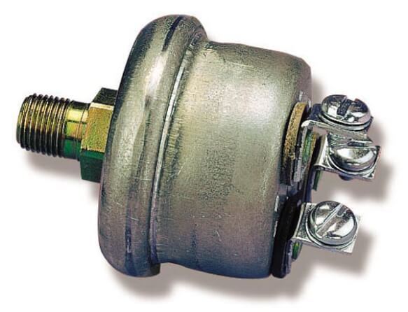

Wire the relay in the storage compartment- along with an inertial fuel shut-off- then right from the battery (via the relay) to the fuel pump in the back.. Then just run a wire from the fusebox connected to the ignition terminal. You do not want to wire it to accessory-ignition source (radio/wipers) as the the pump could run when the car is not running in accessory position. Some will recommend an oil pressure shut -off as well. When the engine isn't running (no oil pressure) the pump will be off.
https://www.ebay.com/itm/FORD-INERTI...MAAOSwiLdV9frs
https://www.holley.com/products/fuel...s/parts/12-810
