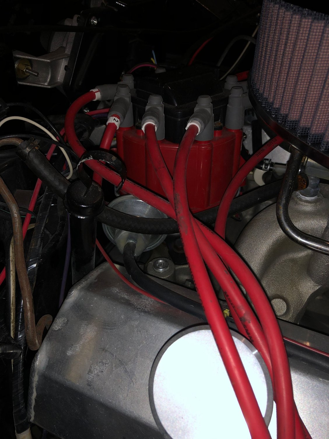

So I have the MSD HEI Distributor with no separate filter setup now. I’ve never had this out driving any distance on the road. Is this something I need to look into or check within the MSD details?
As for the capacitors, still on the fence. I don’t have a radio now and I would assume the RFI wouldn’t be an issue with today’s radios but am not sure.
I'll say this for MOST modern radios -you shouldn't have problem- unless you do a lot of AM radio listening. However -there are some junk radios sold today that are almost impossible to install without getting noise- no shielding is used- cheap cables etc. The Corvette is notorious as the fiberglass does not shield like metal- hence the ignition shields used on many years.
The MSD is just looking for good clean power- IIRC the manual says to power of battery to reduce interference. The battery is the best source for electronics as it stabilizes the voltage and is a great filter. If you are not having any issues - I wouldn't worry about it.
