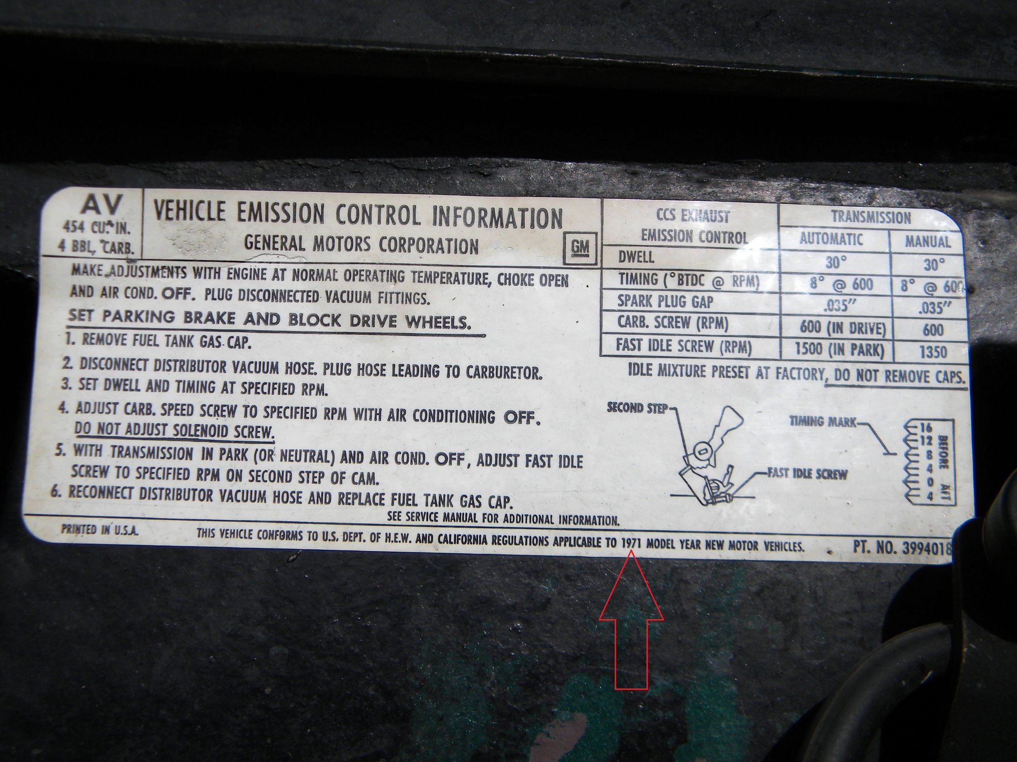

Does your '71 still have the Emissions Sticker? Try 600 and see if you like it.

If you need to have it idle at higher than what the emissions sticker specifies (and your engine is stock), you have a vacuum leak [somewhere], timing issues and/or carb tuning problems. There are MANY reasons for having such problems, but almost all fall into one of those three categories.
