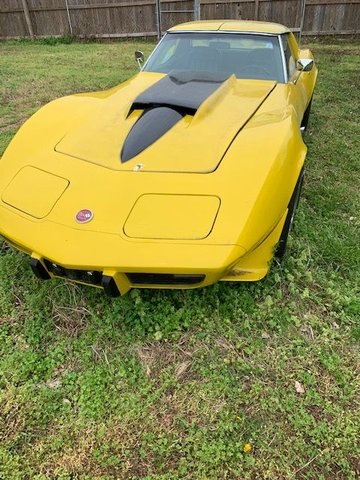

My first question is this: Obviously someone has put a newer front bumper on this car at some point. How hard would it be/what is the process of getting a chrome front bumper back on this car like the '71 originally had?

Welcome, your car looks like it's already in decent shape. Check out Door Gunner's posts, he's the expert in the re-chrome-bumpering C3's.

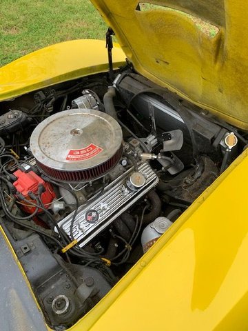

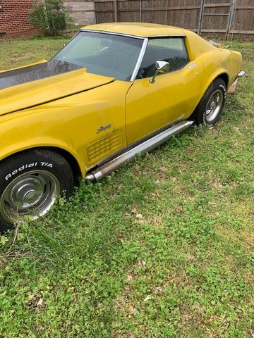

I also have a 71 both chrome bumpers; I like chrome as much as anybody ... but yours looks pretty good as well. Changing it will be a lot of work & expense. Why not clean it up & fix whatever's needed and just enjoy it. Dunno what your motor is but it's far from original. Heads are '86 or newer with aftermarket distributor.& aftermarket intake ... not bad at all but not OE. Rear exhaust outlets have been glassed in to suit Non-OE sidepipes ... looks aok but that ain't OE either. Again, don't sweat the bumper, just enjoy!

The hood is also an add on, you are missing the grill and wiper door. Few more $$$ to replace all that.

That is a 75-79 front bumper and hood surround. Possibly whole nose with 71 fender egg crates retro-fitted. Best way back to chrome is wait until a whole nose falls in your lap.
