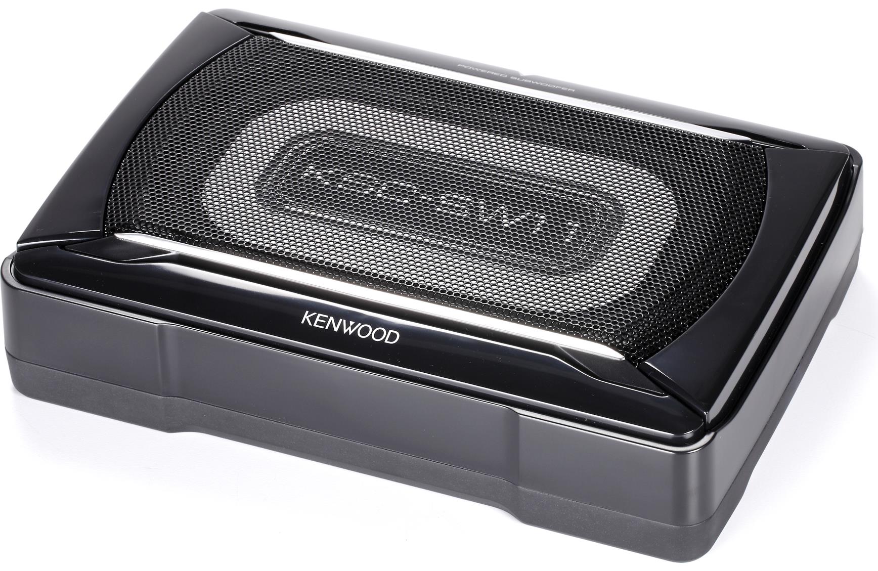

You can get a sub that fits into the jack well.
I think it's Kenwood. It's self contained and really works well.
Kicker and Pioneer also make one .
Kenwood KSC-SW11
Compact powered subwoofer
Item #: 113KSCSW11
In stock
  • compact aluminum enclosure with 8-1/4" x 5-1/8" sub
  • 75 watts RMS power amplifier (150 watts maximum)
  • preamp- and speaker level-inputs plus wired remote
