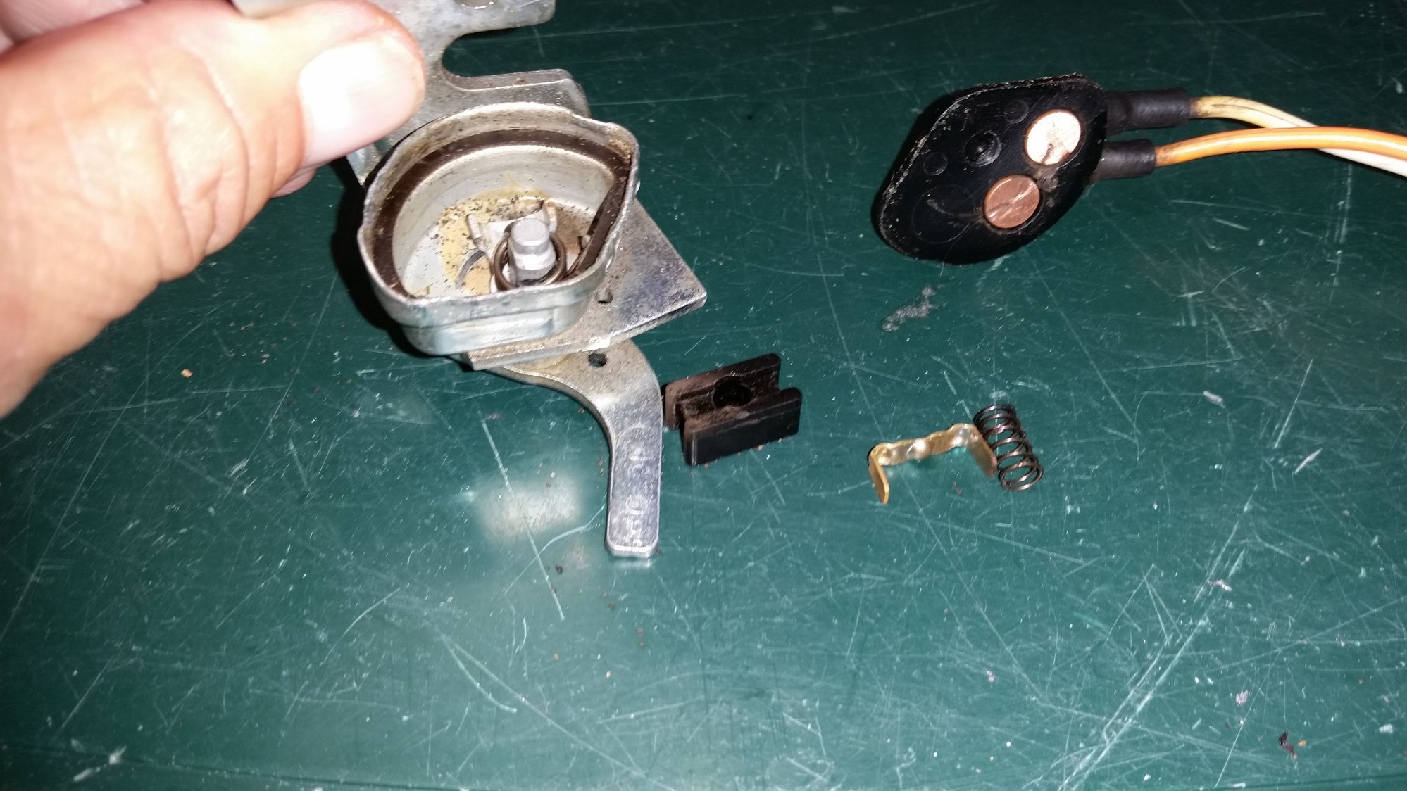

Oh, bummer. Can you show us a picture of the innards? Maybe as a group we can come up with an idea to use some suitable micro-switch, from some other application, as a substitute...... maybe there is even room to install that newer "plunger" type to actuate with the 68 lever??? Just tossing ideas out. I'm lucky, mine has been ok since I replaced it 35 years ago.....
looks like maybe I did get it together correctly but it just wasn't going to work

As long as the contacts are all clean and you assemble it correctly, it should work just fine. It is best if you put some dielectric grease on the body contacts. This will prevent contact burning from arcing when electrical contact is made, and will allow the switch to live longer before your next "cleaning".
