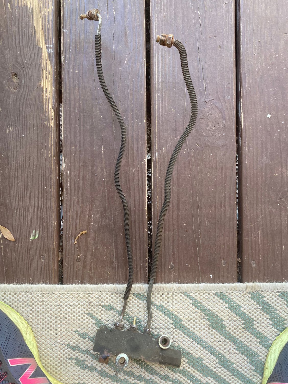

I’m new to corvettes. Have a 77. Replaced brake lines and having trouble getting fluid back through the lines. Do I have to reset the proportioning valve I order to get fluid through? Can I manually reset this or do I need to buy a new one? Any help thanks!

The shuttle valve is likely off-center, if the vehicle had a brake fluid leak in the system. If the distribution block is removed from the vehicle, remove the electrical switch and use a 'probe' to re-center the valve (Plan A). If it is still installed in the vehicle, bleed the calipers that are working, then STOMP (quick & hard) on the brake pedal 2-3 times. Often, that will re-center the valve and you can then bleed the other calipers. If that doesn't reset the valve, you will have do execute Plan A.
P.S. When bleeding brakes, depress the brake pedal slowly, so that the difference in line pressures WON'T move that shuttle valve off-center.

If you want to see the inside of that and the tool that locks the little piston, click on my profile, then photo album, then brakes.

Just went through this with my 78 and I used the technique that 7T advises and used Heads Up page as well. Mashing brake worked for me so I didn't have to get that tool. Seems my proportional valve did not have that center valve but I would have to look. But Heads Up offers some excellent help with bleeding M/C and related topics.
