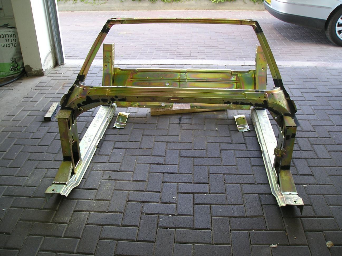

Hi guys, I'm from Italy and I'm restoring a 69' coupè (frame-off restoration). The birdcage is very damaged with heavy rust and fix it will require a lot of work (front clip and firewall removal and fiberglass cutting around body mounts n.3) for a questionable result, so I'm thinking about replace it...I know it's an hard job too but I hope with a better result.
Lliving in Italy will surely not help me because most of these birdcages are in the US and for me will be impossible to give them an accurate look and of course an international shipping will cost a lot of money. Find it in Europe isn't so easy but I will try and I hope to have some luck (about it if you know someone in Europe that can have a good birdcage please give me the contact of course also for US ones!)!
So before looking for a good birdcage i have a some questions for you :
Are 68-72 birdcages different from the others?
If yes which are the differences?
Can I easly adapt a 73-82 birdcage to my 69' body?
I'm worried about reinstall front and rear clips and obtain the correctly aligned body shape...is it very difficult? Any tips and tricks?
Thank you so much and happy Easter!
P.S. The birdcage in the first picture isn't mine, comes from the web only for example...

68-72 birdcage frames are in the most part, the same. 73-74 are somewhat different, but mainly in the lower windshield are. This will not effect anything. But you will need to use a 73-76 windshield, I believe. Replaceing the complete birdcage is very time consuming , but it can be done. The search function is your friend. Good luck.

Thanks! So also windshields are different?

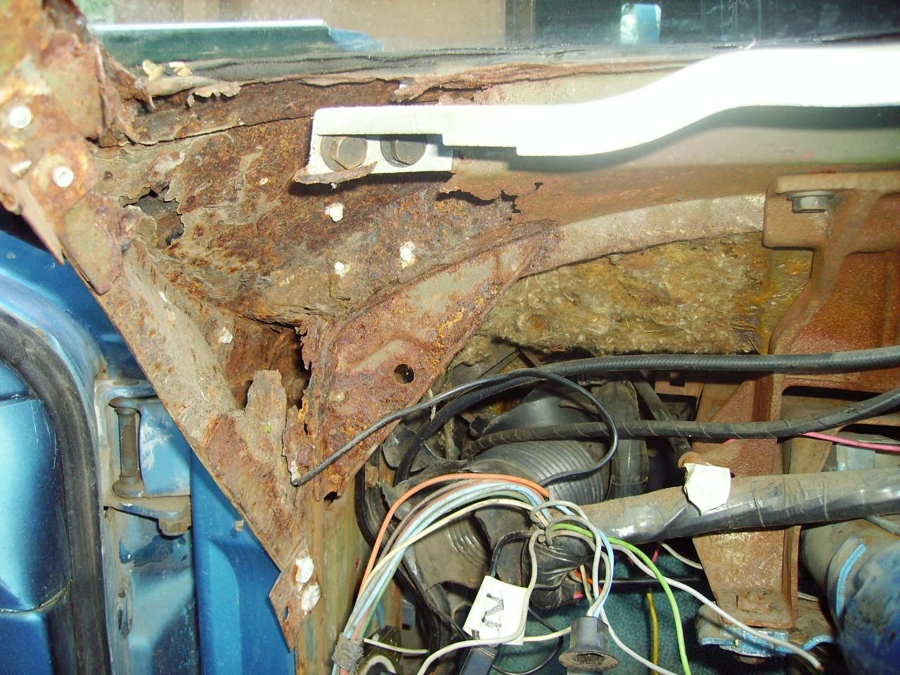

I know that the metal where the wiper door mounts up is shaped different on 73 & up, as they do not have the wiper door. With a little extra metal you can build it up so the wiper door will mount up like normal, so you can get around that. The aftermarket patch panels are the 73 up shape. I have one of each in the garage, and bare. If I can't find a picture online and you need it, I could always take one for you.

If you are seeing primarily windshield frame damage, I just finished cutting a half dozen patches for my 68 windshield frame rust and need to get my welding buddy who has some specialized low heat input equipment to weld them in. My windshield frame was solid elsewhere with no flex what so ever, so this is a judgement call as to how bad is bad, IMO, and when to repair and when to give up and replace.

Thanks guys! the windshield frame is gone, totally rusted, I've already found a good one but unfortunately the area where should be attached is totally rusted too

OK not good there. Now you'll need to pull the windshield next and see what it looks like under there.Then examine the bottom of the vertical pillar where the body bolt is.
And post more pics. The question is how much is rusted and how much is still good and solid. Then you can decide: Is it patcheable? Do you put in a huge section? Or do you replace the entire thing?

I had similar rust in the same area, as well as the outside lower windshield corners and several spots on the upper windshield frame. I looked at replacement pieces but they are very expensive. I have a mig welder with limited welding expertise. I took my time, used a fair bit of 18 gauge steel and cardboard for patterning and did all the repairs. Took some time cutting fitting and grinding but in the end it was all worth it.....besides, as long as you maintain your measurements etc it all gets covered up. Good luck

what are the #2 and #3 body mount areas like ? also the sill panel that runs under the door to both of those mounts ?

I have a solid lower windshield frame area , if that is the only part of you windshield which is rusted out. I will post some pictures for you.
