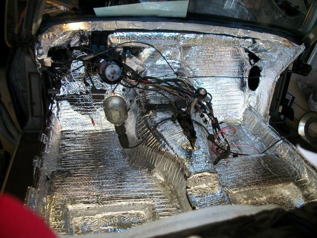

I'm no engineer, but my understanding is you are not trying to block the heat but dissipate it across a large area. This eliminates hot area and allows the metal to absorb and cool across a large section.
So I use the
Amazon Amazon
It's 10 mil thick and pretty each to shape, Connected the pieces with aluminum tape.
To firewall insulation

Actually, you are trying to block the heat from coming thru the firewall and into the passenger area. On the floor, you are trying to reflect radiant heat AND block convection & conduction heat. Metal foil which faces the heat source is a good way to reflect radiant heat. Insulation materials with lots of air-space in the material works really well to block heat transmission.
P.S. Folks pretty much waste money putting heat insulation in the storage compartment of a C3 coupe. The exhaust pipes are not close enough to do much transfer and there are compartments in the way before it reaches the interior. But, sound deadening is badly needed back there.
