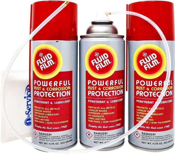

depends on the treatment, oil based stuff you just spray on the surface and it soaks in and prevents further rusting. The paint style has to be prepped first like sand blasting or wire wheel. The aerosol styles you can usually jack up the car and they come with a long spray straw to get into the frame.
My buddy likes fluid film, I need to buy a big kit like this myself
https://www.ebay.com/itm/112271354573

Personally, I spray all my cars with Fluid Film. I do have a yard, garage and a compressor so doing it myself is not a big deal, but if you go to the Fluid Film site you can probably find a shop in your area that provides the service. The down side is that it has to be done annually, but if it keeps your car from rotting out then it's just another toy expense that you should build into your budget.
I used to spray the used motor oil cut with diesel annually on the undercarriage, but that was a messier proposition in applying it as well as living with it afterwards. In today's "green" world I don't think that you'll find too many garages offering that service anymore, but if you do it should be cheaper than the Fluid Film.
The fluid film is just a biodegradable wax that will wash away with time. After motor oil or Fluid Film is sprayed on your undercarriage, it will drip the excess onto the ground. It's no fun to have your parking space filled with lil puddles of oil, but it's no big deal with the Fluid Film.
EITHER is 1000 times better than what you're currently doing.......
