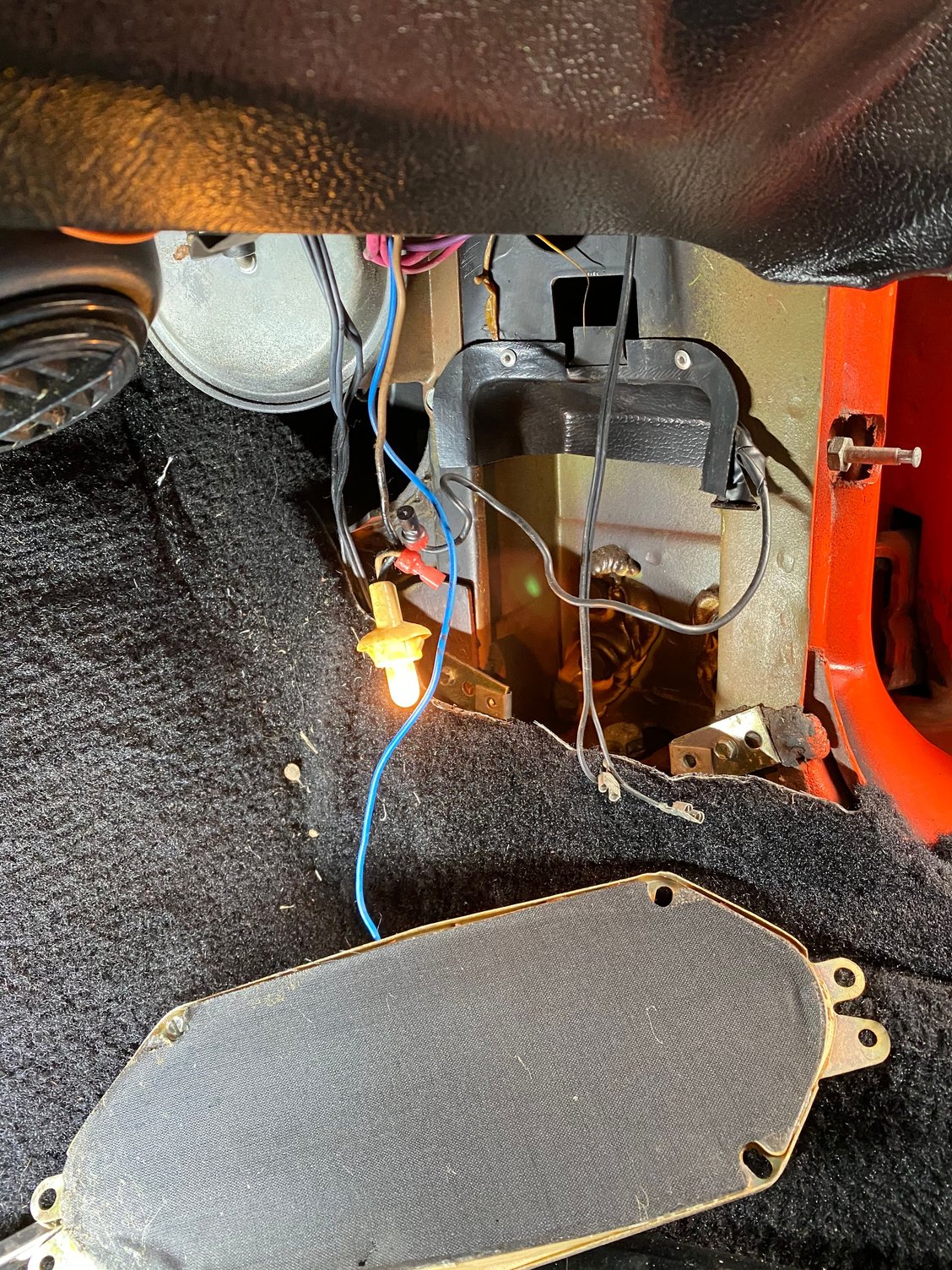

Not a lot of room here. What have you guys used here with good results? Just pulled out this old speaker. There is a light just hanging, seems to be missing a bracket.

You are correct on the missing bracket for the bulb

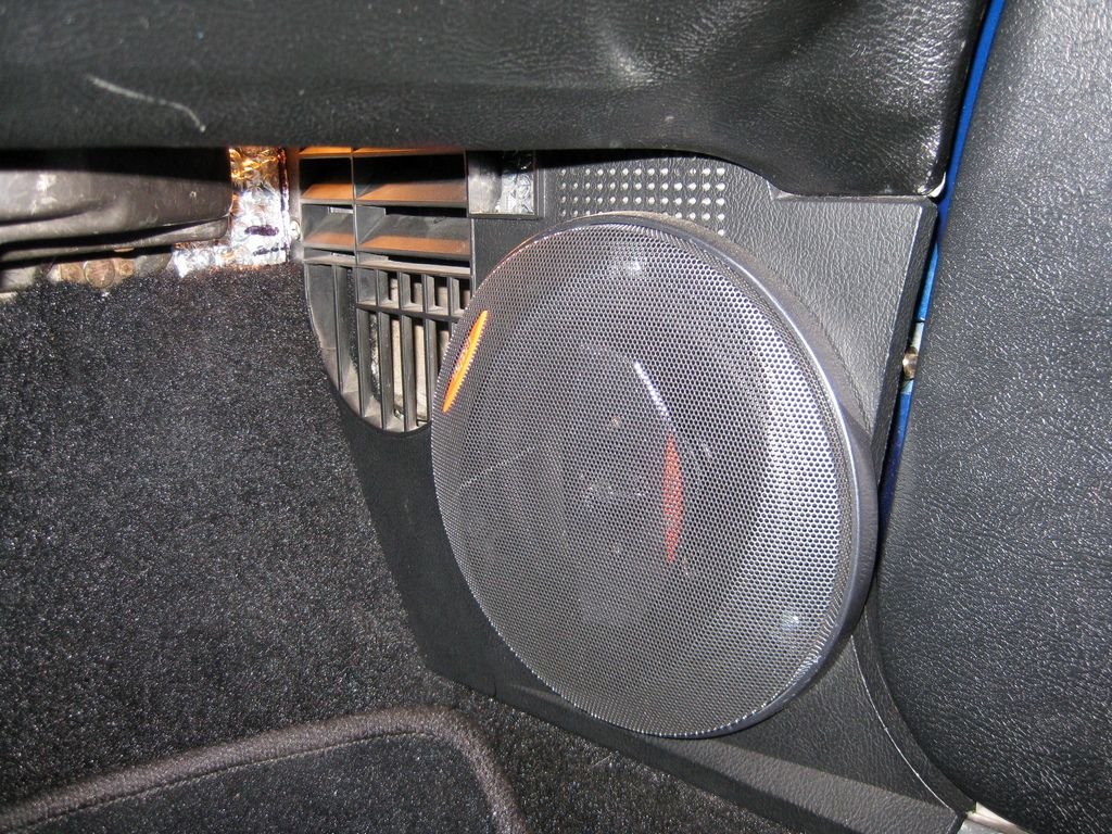

I managed to fit some Boston Acoustic 6-1/2" speakers in that location. The magnets were the perfect size to fit in the recessed pocket your picture shows.

Yes, there should be a bracket on the backside of the dash knee pad for this light.

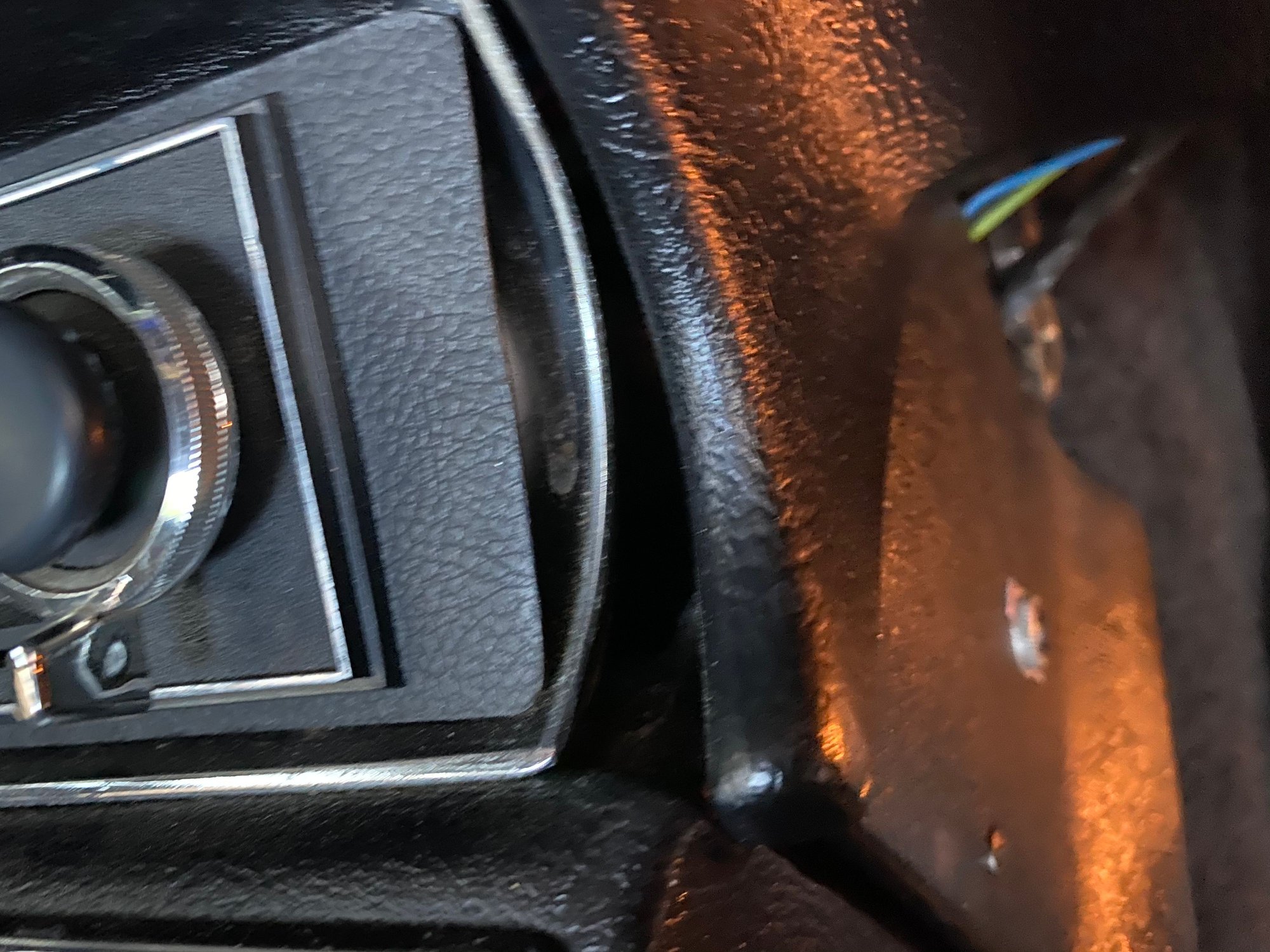

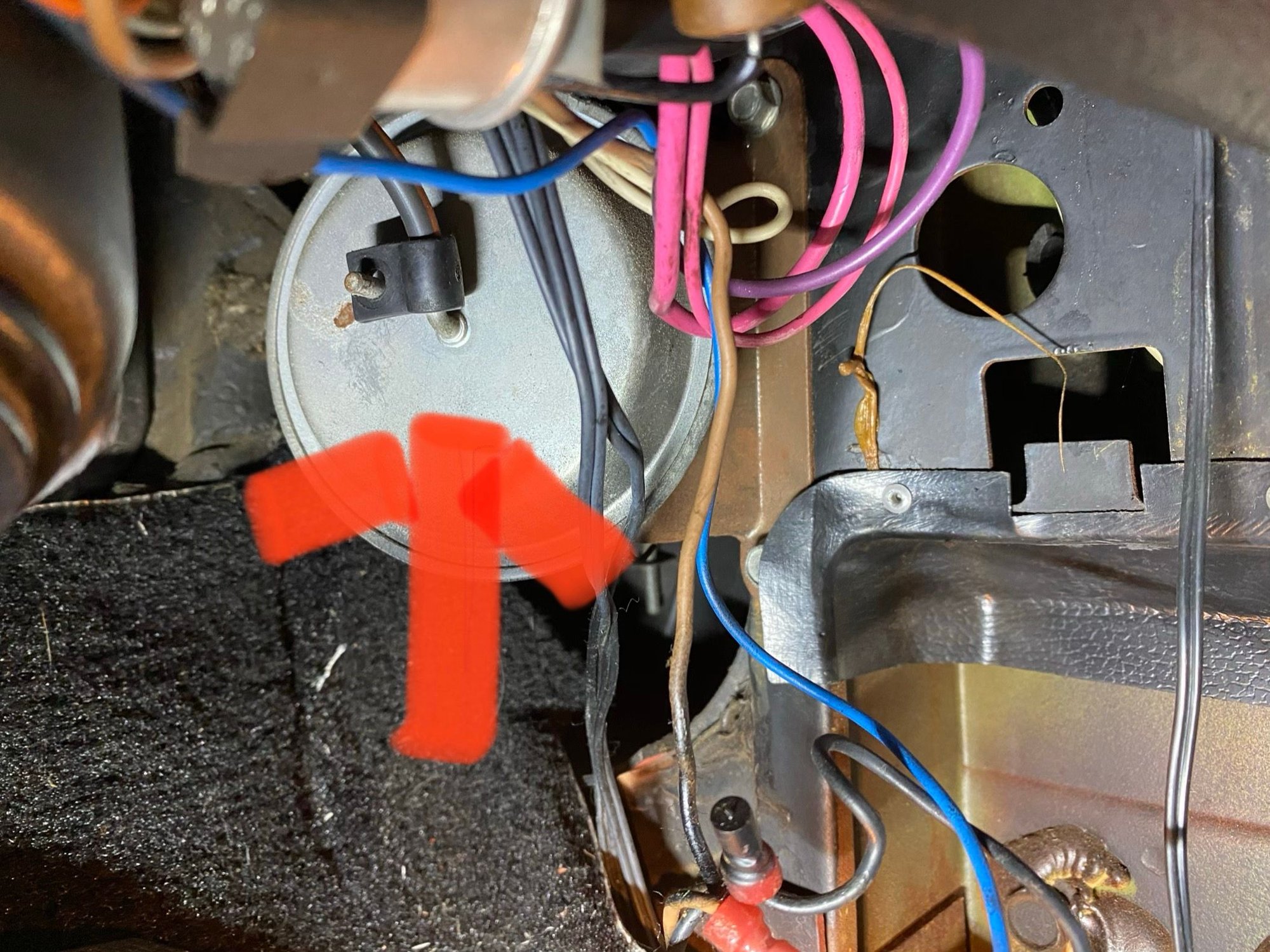

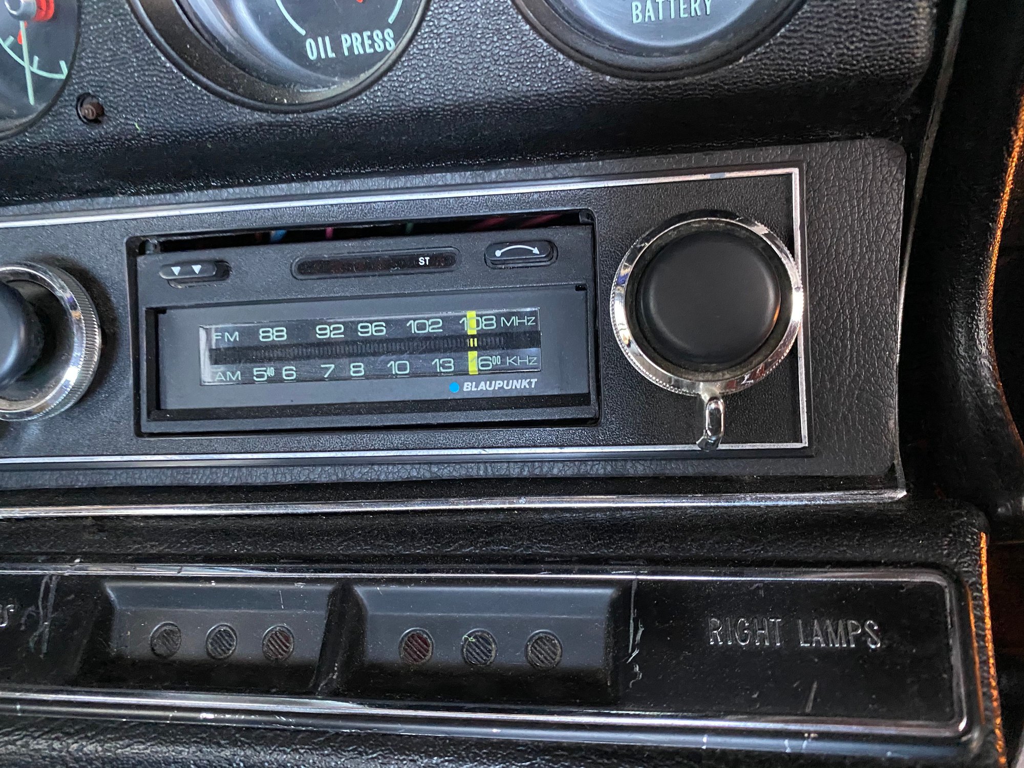

Dc3 and 7t1 Vette,thanx for your responses. I was gonna try and find a speaker that actually fit behind the factory grill. Didn’t want to cut it. If cut are replacements available? Looking at your pic DC3 I am missing the top slanted grill too. Is the grill piece and bulb holder available through the vendors? Also I don’t have a deacon radio. Car came with an old Blaupunk radio. Just took another look at my grill. Looks like someone already cut it. This round thing sticks out. Any idea what it is?

Looking at my radio a little closer it looks like the opening has already been cut. If so might as well just update the radio.

That 'round thing' is a vacuum servo to operate the cabin air inlet door [behind it]. You want to keep that....

Thanx, but I wasn’t planning on removing it. Just wondering why it sticks out. I saw a pic of another car and I don’t think it was sticking out.
