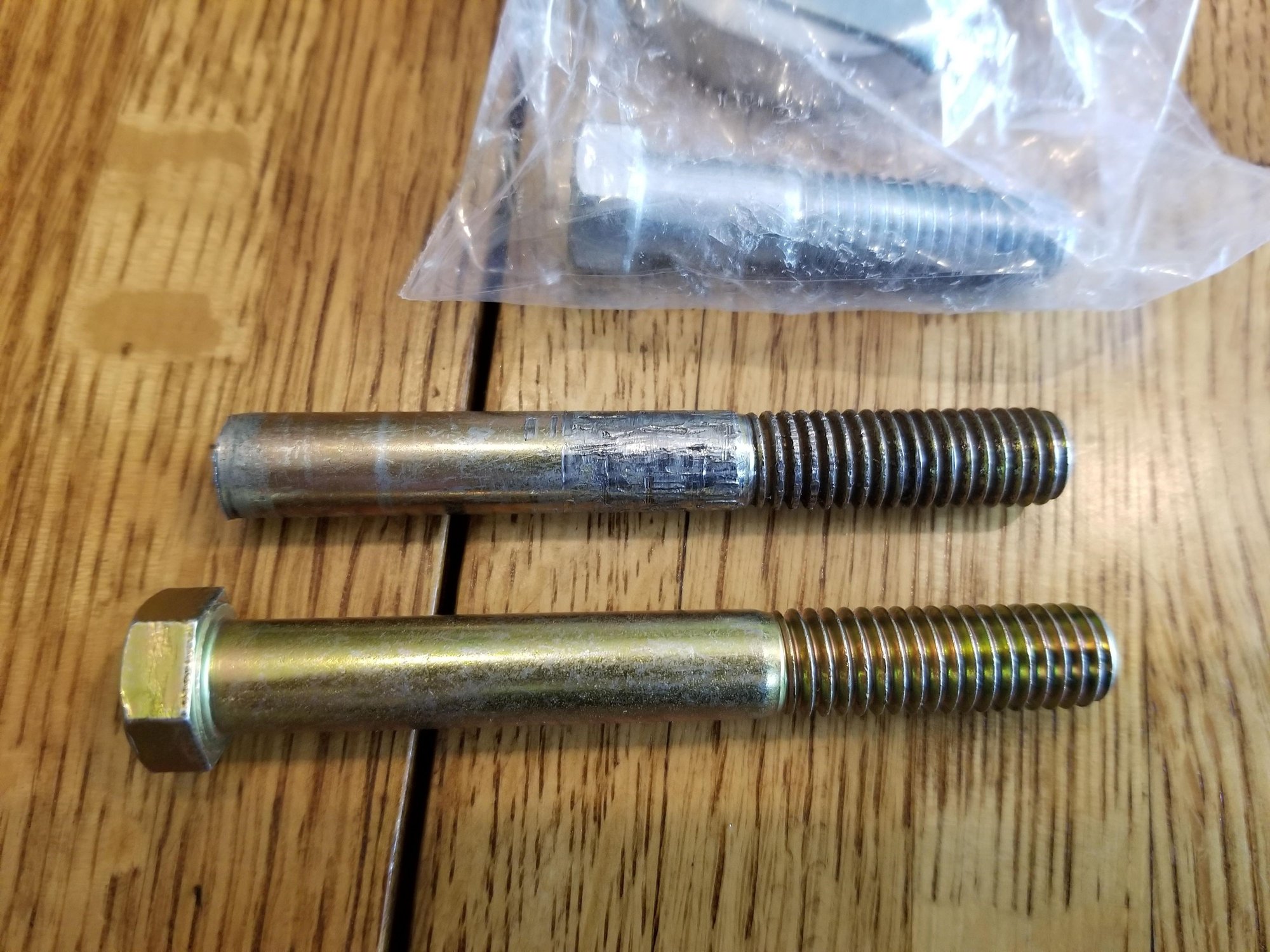

Because, in my infinite wisdom, I decided to go with longer new mount bolts, and bought 8 Grade 8 bolts at 3 1/2" length.
My thinking was, that it would give me more ability to get things lined up, and also allow me to keep them loosely attached while I went to the opposite side of the car and lifted that side up to replace those mounts.
Trouble is, the longer bolts still have the same 1 1/4" of threaded length as the stock 2" bolts do. (see 1st photo below)
Sooooo...... my stuck #2 new 3 1/2" bolt was actually due to me driving the bolt so deep that the un-threaded section drove into, and bound in the nut, thereby causing the nut to eventually break free and spin.
Doh, Doh, and Double-Doh!

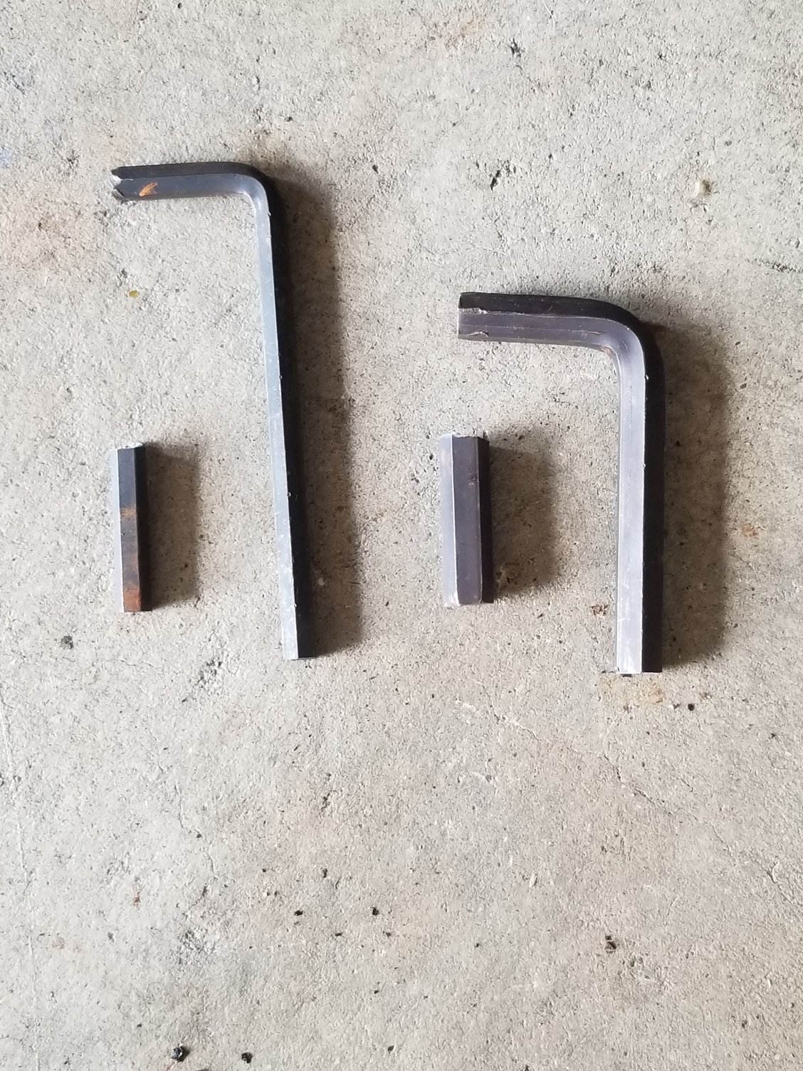

Now that the bolt is out and I can see what the root cause was, my idea is the wedge some metal pegs (maybe some donor cut pieces of old allen wrenches?) into the gaps on either side of the cage to ensure the nut stays put, then put a tack weld on each to keep them in there for the next eventual removal. (see 2nd photo below)
I think this will still allow the nut to have enough "float" that it will align properly to the body and bolt when lowered.

Jamming a couple of "engineered shims" into the cage (a couple sections of cut allen wrenches), and then a quick tack weld on each, and the nut was good and secure, enough to take the torque of the #2 passenger side bolt when buttoning up that side.

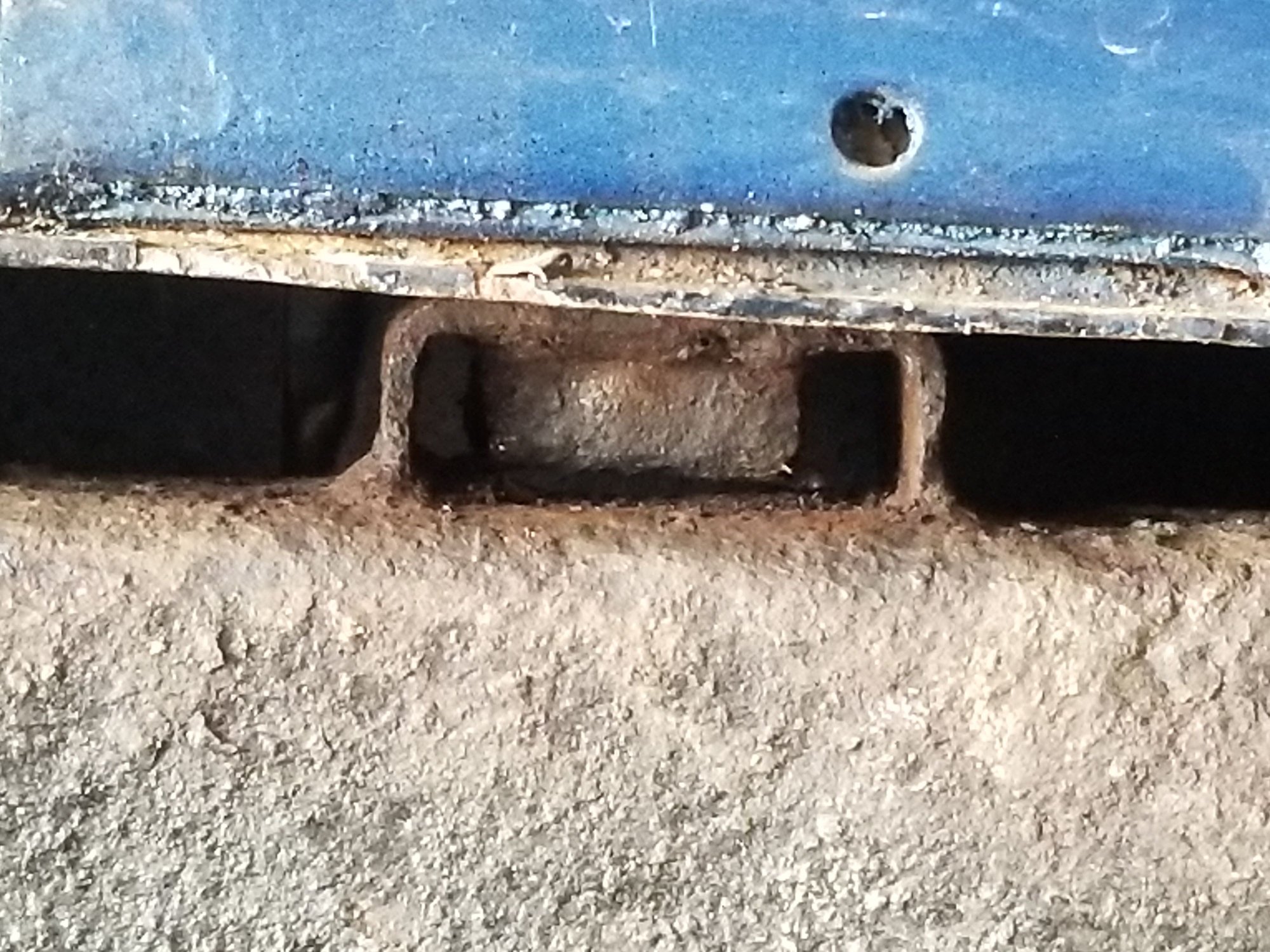

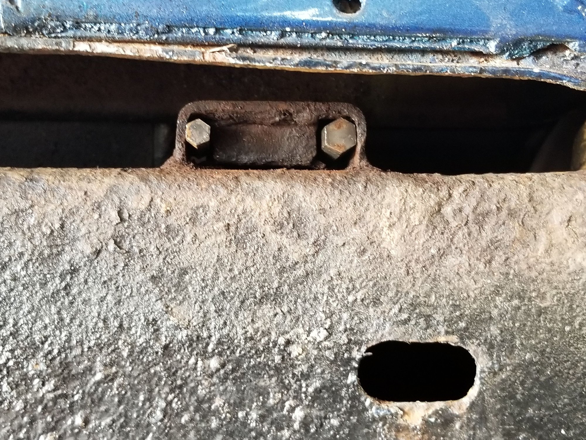

Here's some photos of my work-around plan for the spinning mount nuts.
Since I was able to remove the cut-off bolts by jamming 2 screwdrivers in the gaps front and rear of the cage nuts (where the flanges had flared open), I figured this would be a good permanent fix.
Since I only just bought a base level wire welder, I wouldn't be able to tackle a complete replacement of the mount bracket and cage nuts.
First picture shows the gaps AFTER I bent them home with the screwdrivers.
Knowing that those cage flanges would likely flare out again under bolt torque, I fabbed up sections of Allen wrenches that would wedge in the gaps and keep the cage closed. (see 2nd and 3rd photos).
I then took my new wire welder and tacked those in place, since I don't ever want to have to do this again!
Not the prettiest of fixes, but given the fact that I had very limited access to the area, and just non-professional equipment, I think this is a respectable repair that doesn't compromise any integrity, and only maybe borders on Bubba territory.
