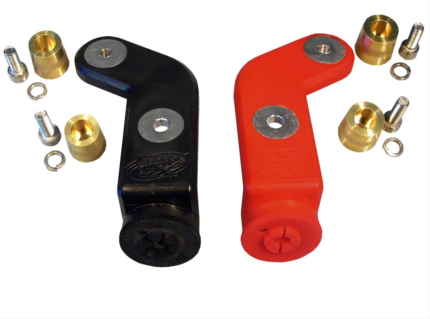

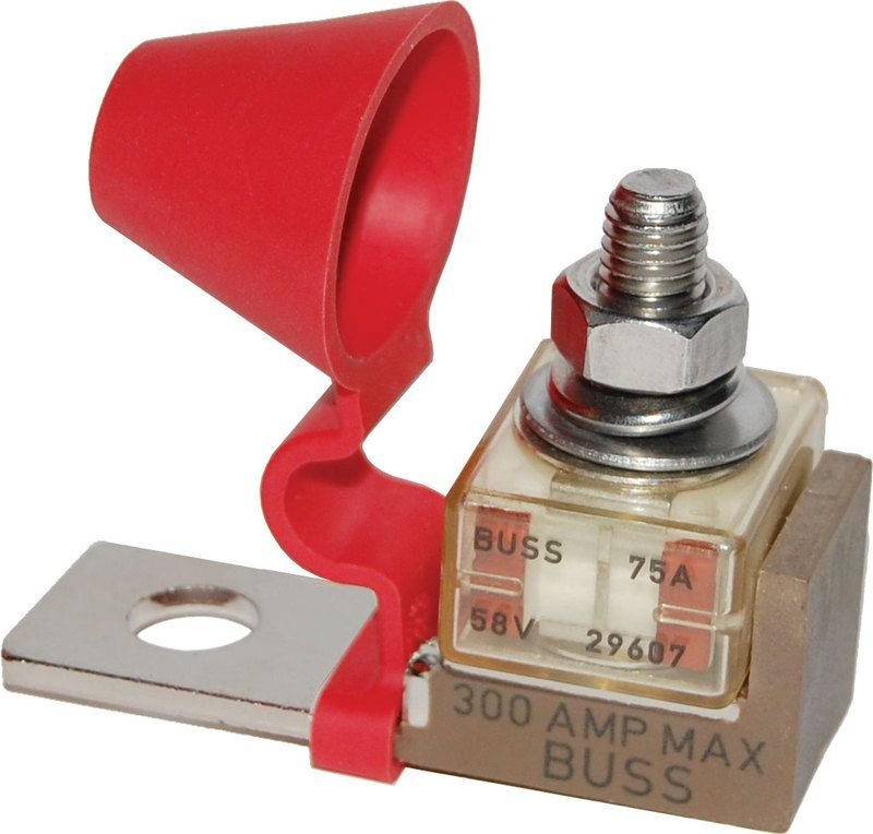

One of these will be way faster - and less damage than the time taken getting to a cut-off switch-
Battery Fuse-

True,, but that fuse will shut power off even when your in house sleeping, saving you that extra 0.003 of a sec to disconnect it,,,

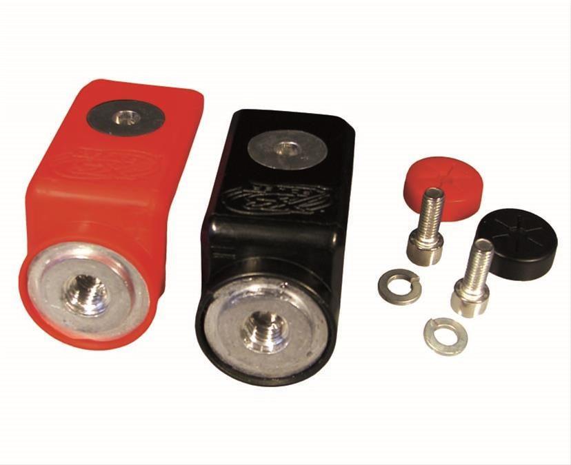

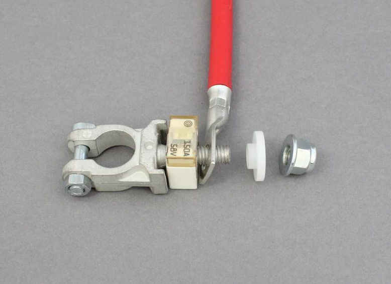

WOW .003 is impressive- Doug Kalitta's has only 0.0609 reaction time...
There are several different ways to accommodate side posts-
To not a good weekend..

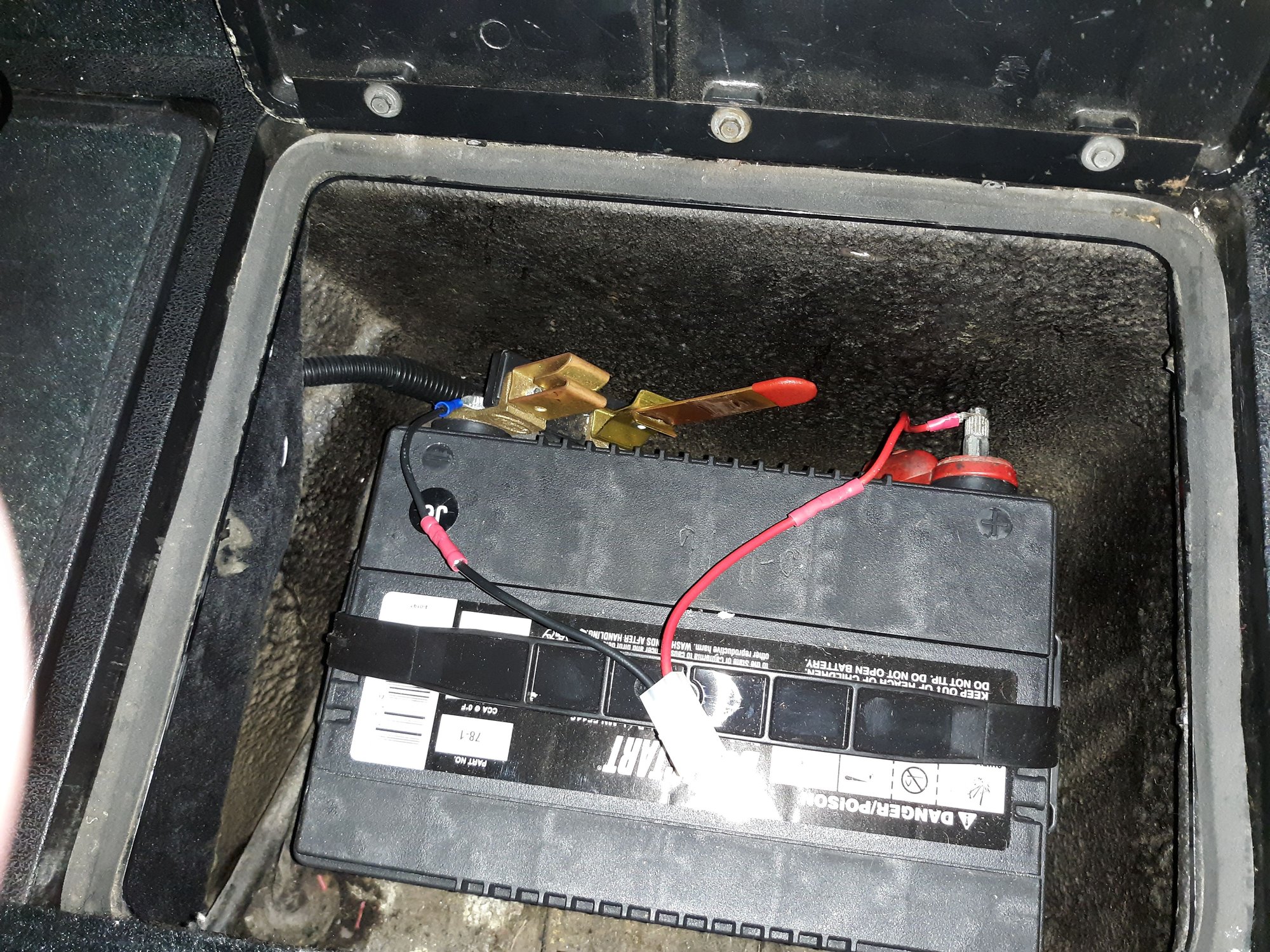

I turn my cutoff switch off every time the key goes to off.....just in case the battery decides it wants to drain itself, that way Im not stranded
