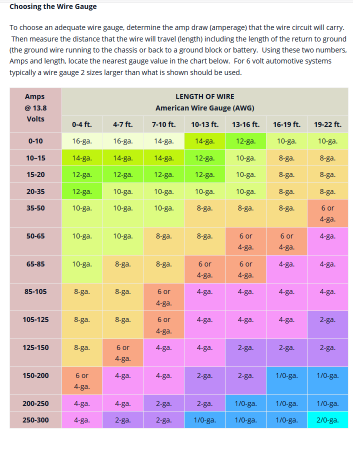

Originally Posted by Richard454
One of these will be way faster - and less damage than the time taken getting to a cut-off switch-
Battery Fuse-
Sorry, Not a fan.
Sure it may be good for the catastrophic accident with a short, but I have had smoking wires from several cars over the years and it is always a small wire pulling too much current. A 16 gauge wire will burn way before the 150 amp fuse blows.

Originally Posted by Vibguy
Sorry, Not a fan.
It's NOT the small gauge wire pulling too much current-it was either the wrong size wire or not fused correctly.
A fuse's job is to blow way BEFORE the wire melts- see chart below
There are dozens of post just on the C3 section where somebody connected the jumper cables with polarity reversed or battery cable reversed- the battery fuse would have saved several hour of replacing fusible links and/or smoked wires perhaps even a towing bill.
For LESS than $40- including a spare fuse - I can NOT see why you are not a fan- cheap insurance.
