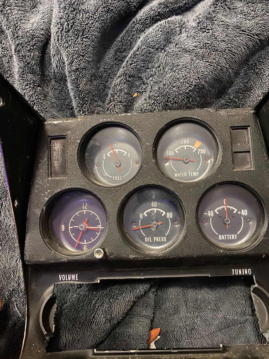

Im looking at ordering a dash wiring harness from Willcox, how we the gauges I have in my car look like it maybe be from a 1974? No manual oil gauge. Would I need to order a 1974 harness in that case or still order a 1973 dash harness. And anyone know where I can get the resistors for the fuel and oil pressure gauge?

Sorry,
it is a 1975 center gauge cluster

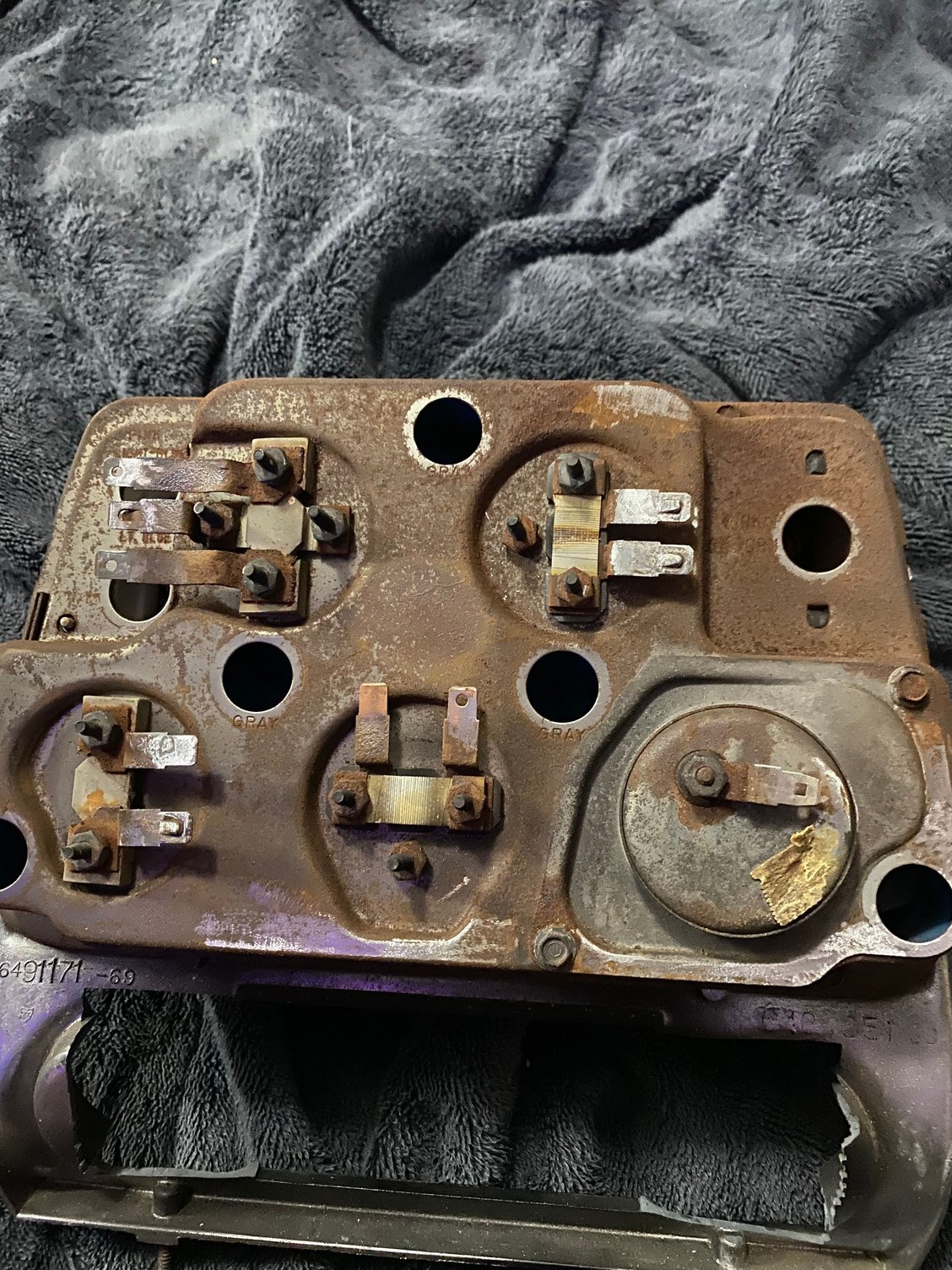

It looks like you have a 73 gauge cluster with the exception of the oil pressure gauge. See the attached pictuer of teh back of my stock 73 gauge cluster.
Fran
