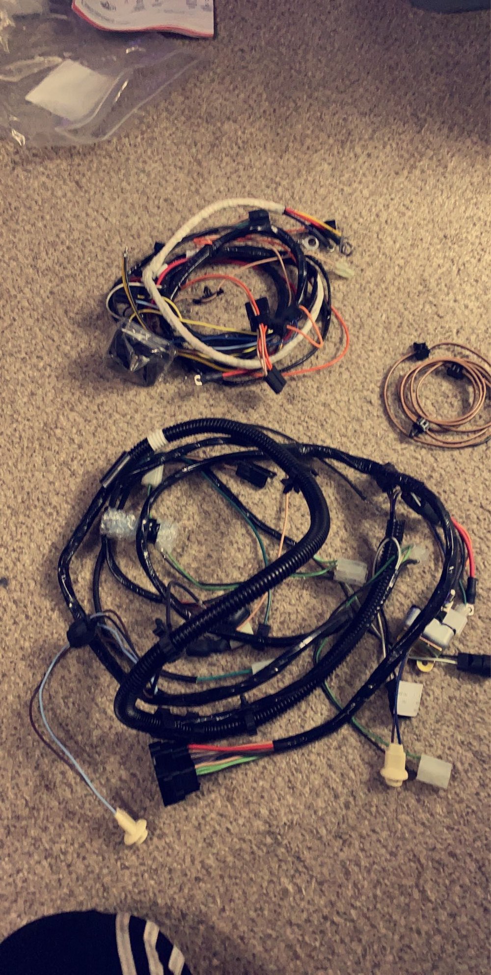

Got these in today, excited to install them tomorrow. Any tips/advice ?

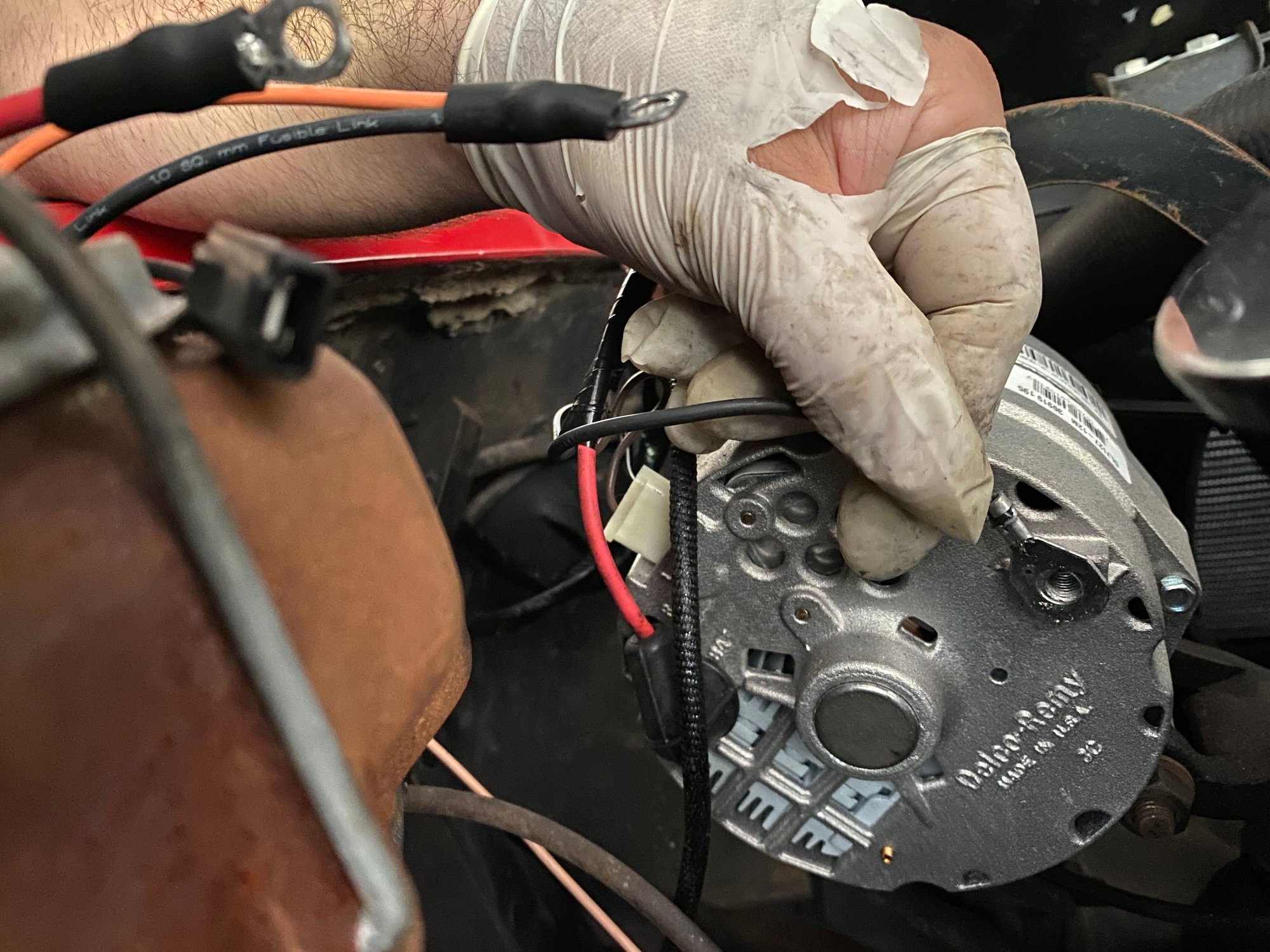

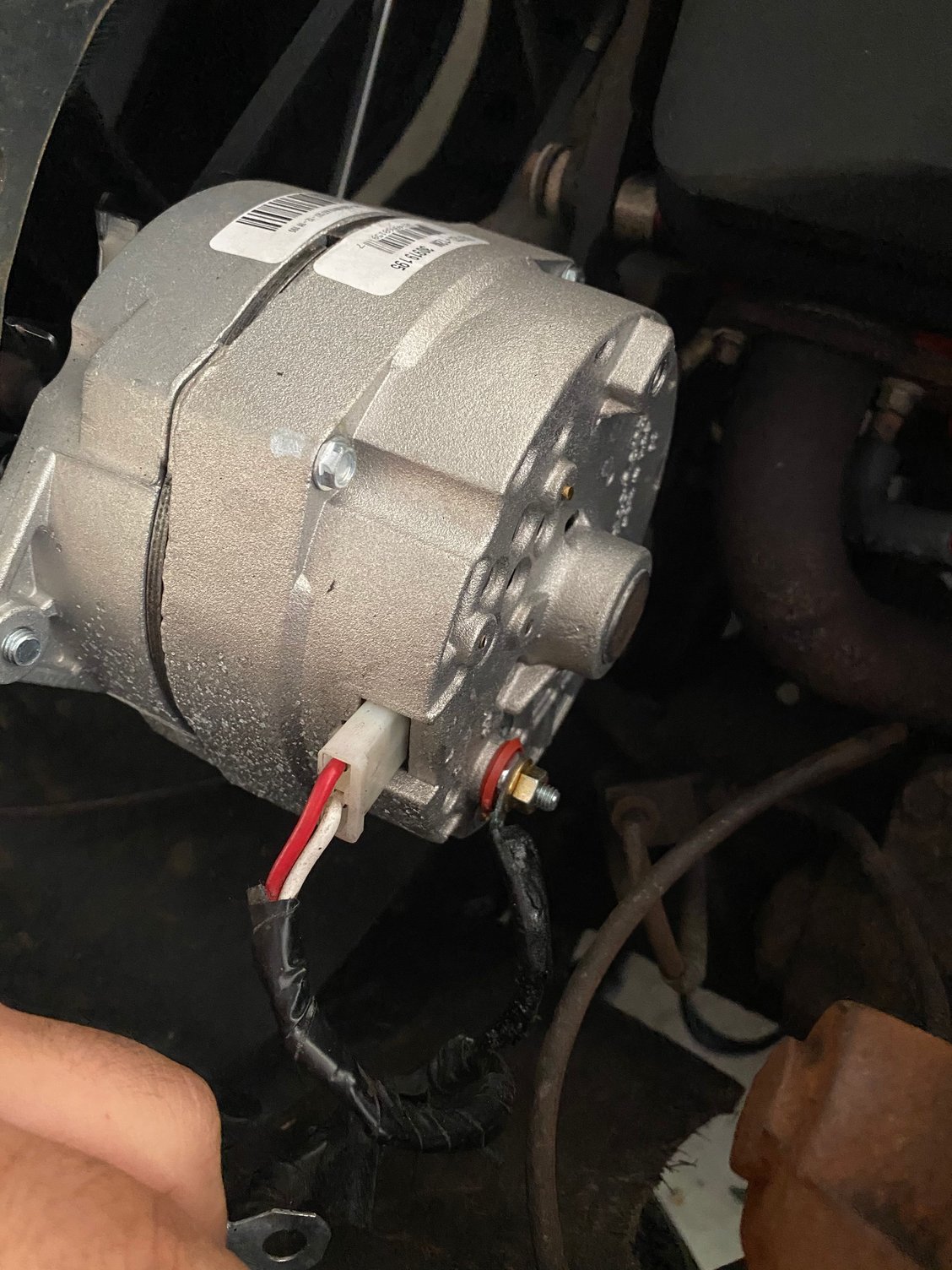

the alternator wires look different on my new harness VS my old one.does the boot go over where the previous wire is in? I see a lot of burnt wiring around this part, is bad wiring causing this ?

On mine
Plug goes in the plug hole
Red with boot goes on the post on the back. The boot just snaps over it
Black is ground on housing
I would attach plug and red and see how far the black ground reaches. That's a pretty big female tab

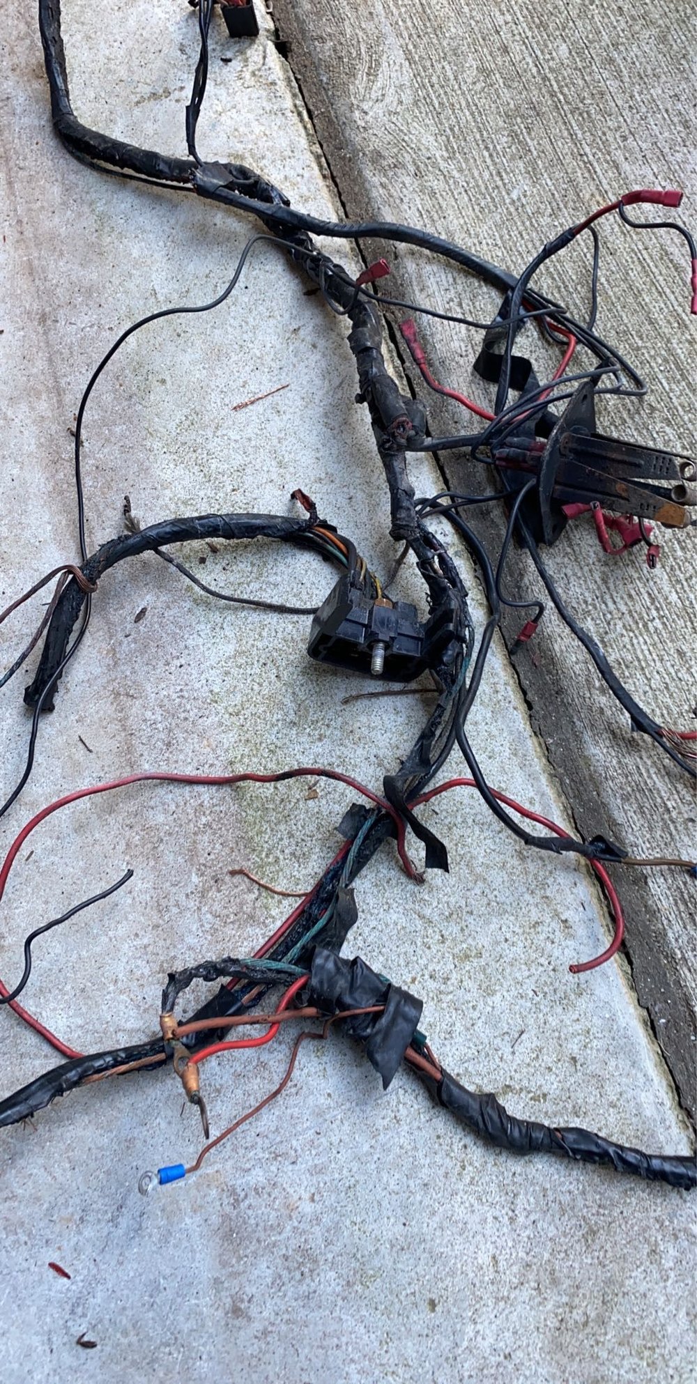

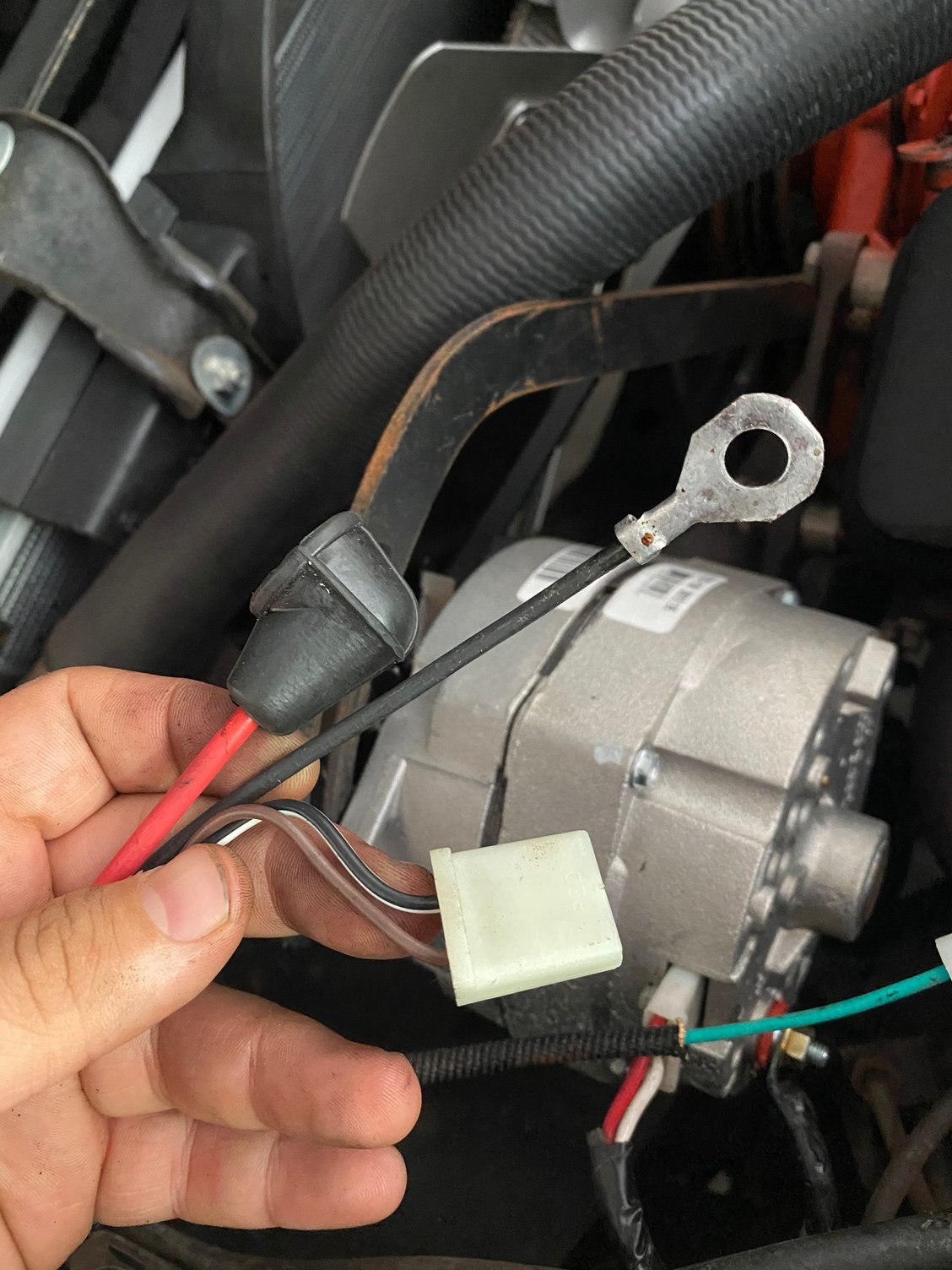

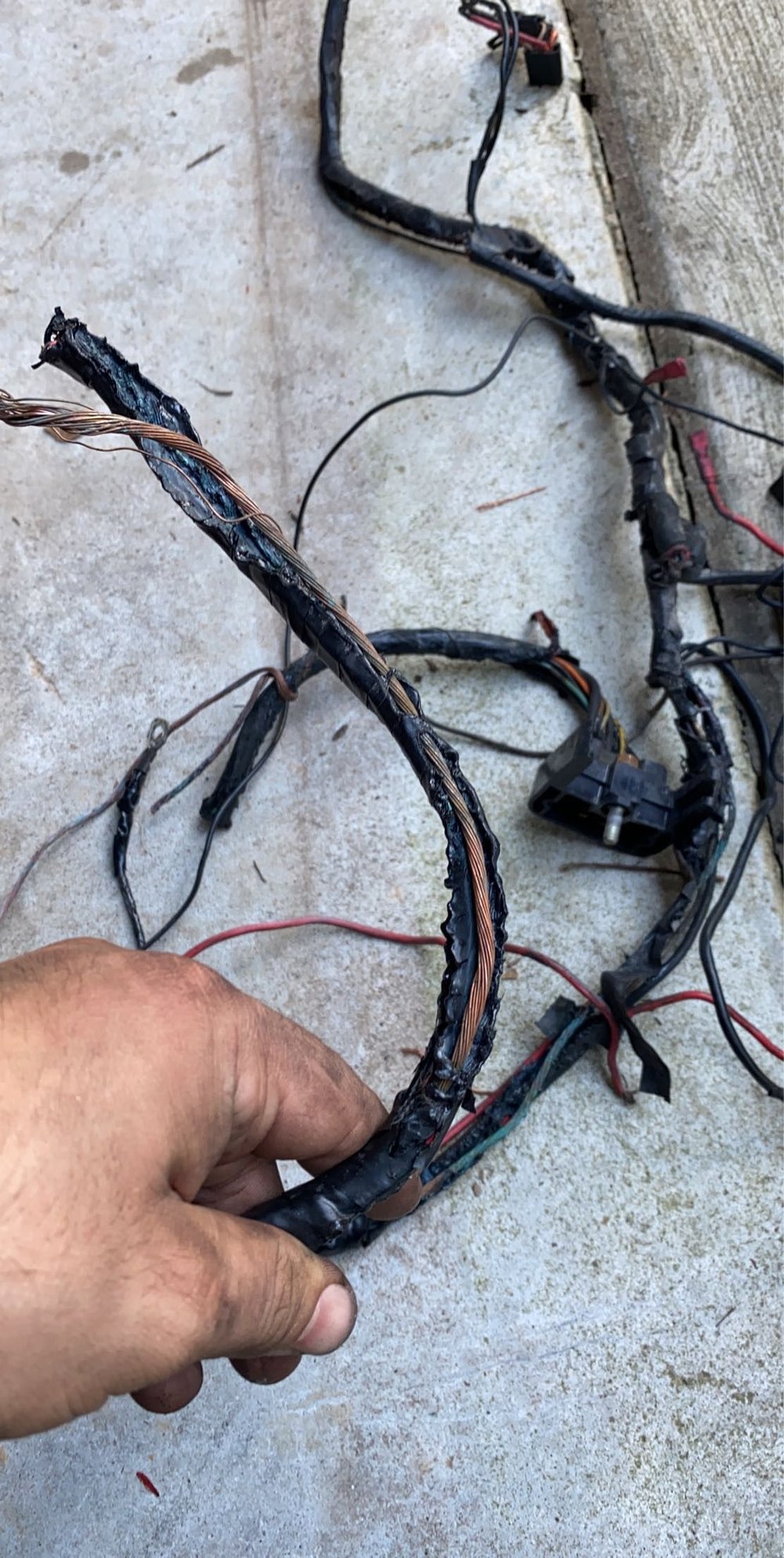

Ended up finishing the front lamp harness. Nothing was grounded, all other grounds were just dangling. Had to cut the screws from the horn relay and put in a new relay. Added some new parts I know need after being under the car.
I just have the ground wire for the alternator, can I just buy a bolt and bolt it to where the hole in the picture is?
thank you guys for your help.

as long as its a blind hole and the case is grounded, yes. just make sure its a really short bolt

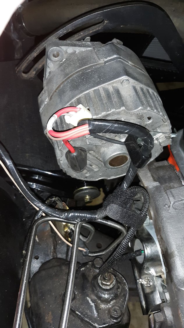

My front harness was from Letric Limited, and appears to be similar to yours. Here's my wiring:

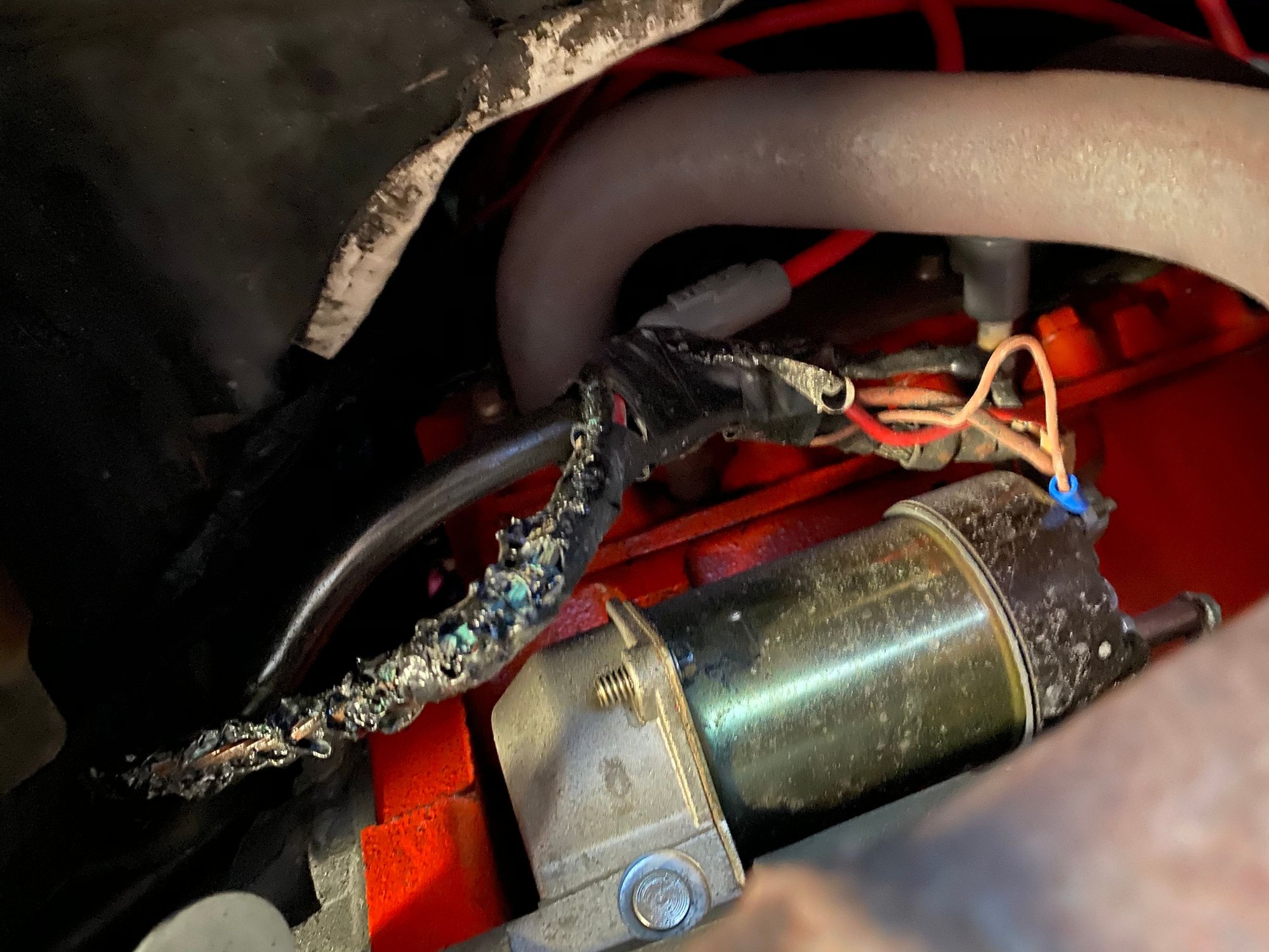

Finally four around to finishing this job this weekend. Had to remove starter for the wiring, the ground cable and both battery cables were all hooked up to the top terminal on the starter, hence the wire being burnt I guess. The alternator also had no ground, again burnt wiring.
