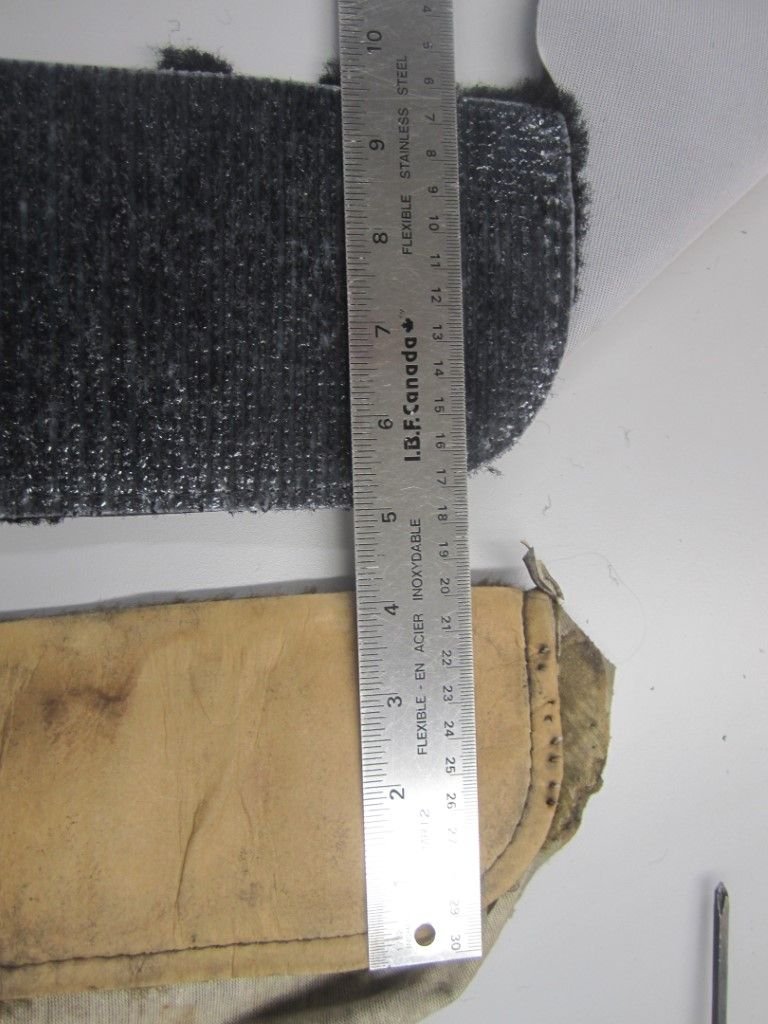

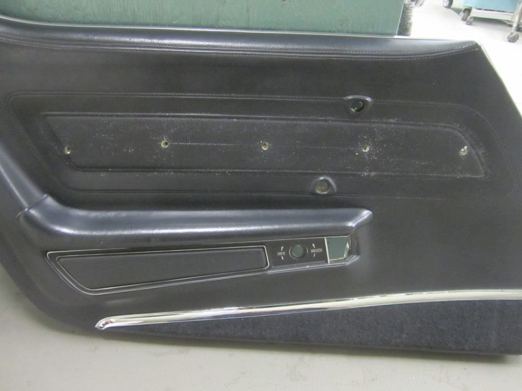

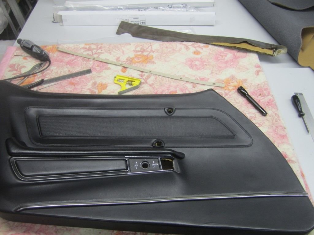

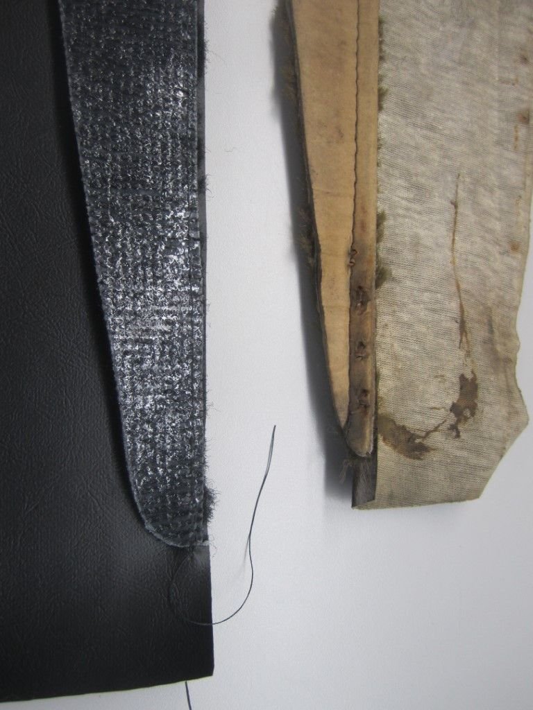

A couple of things to keep in mind
The replacement door carpet was not very close to the original in size.
We held the new carpet in place and traced where it would cover, then made a cardboard copy of the chrome trim piece and fit it to the door making sure it would cover the carpet piece.
Used that to mark and drill the holes, then trimmed the carpet to match.
you can see the cardboard template in the back there
Same thing for the upper wood grain piece, the "guide" bumps in the repro panel were not even close
And the wood-insert sticker wasn't even close to the right shape
https://www.corvetteforum.com/forums...or-once-2.html
Anyway converting them is fairly easy if you take time and they look good (if that's the style you like)

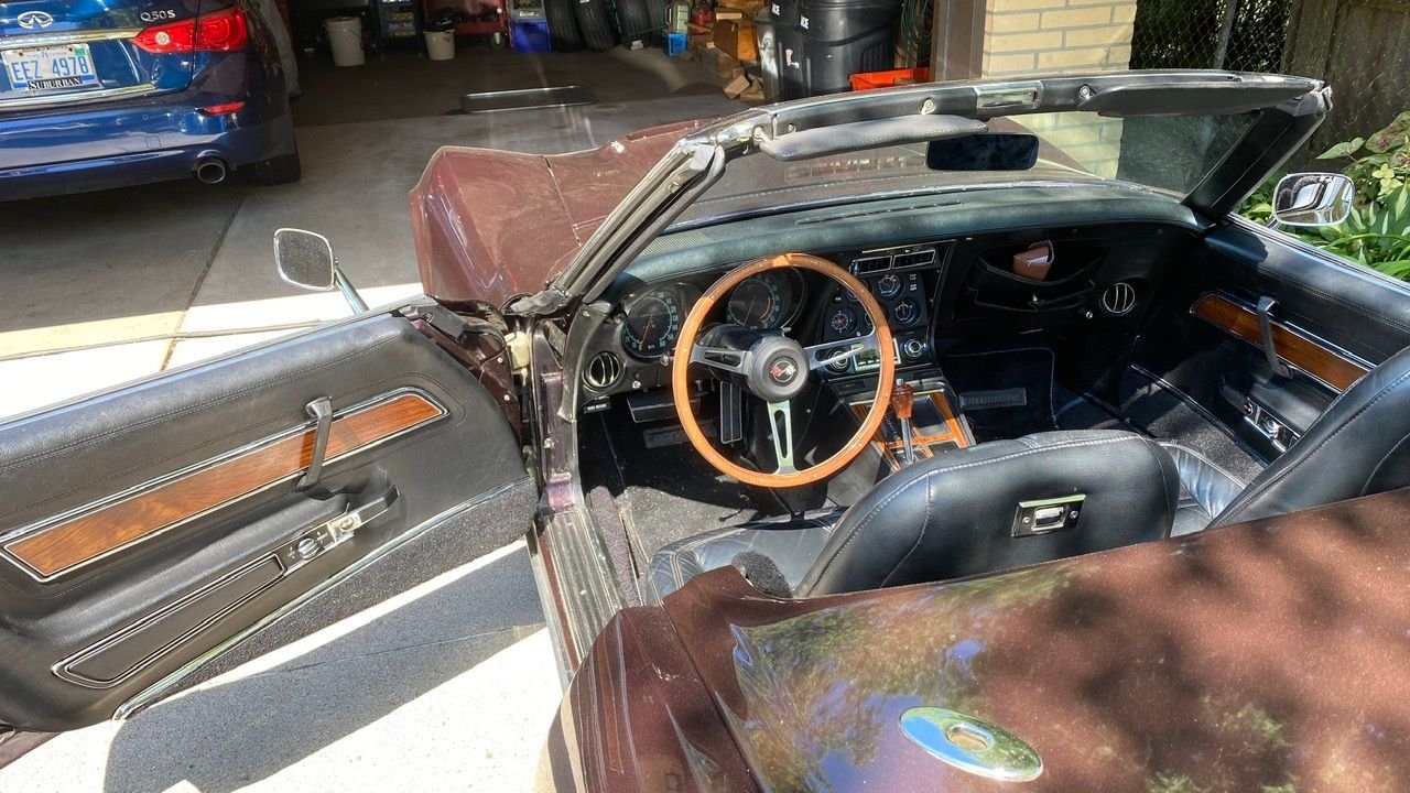

Here is my upgrade to deluxe.

get the sunglasses out of the map pocket. stretches them out. interior looks good.
