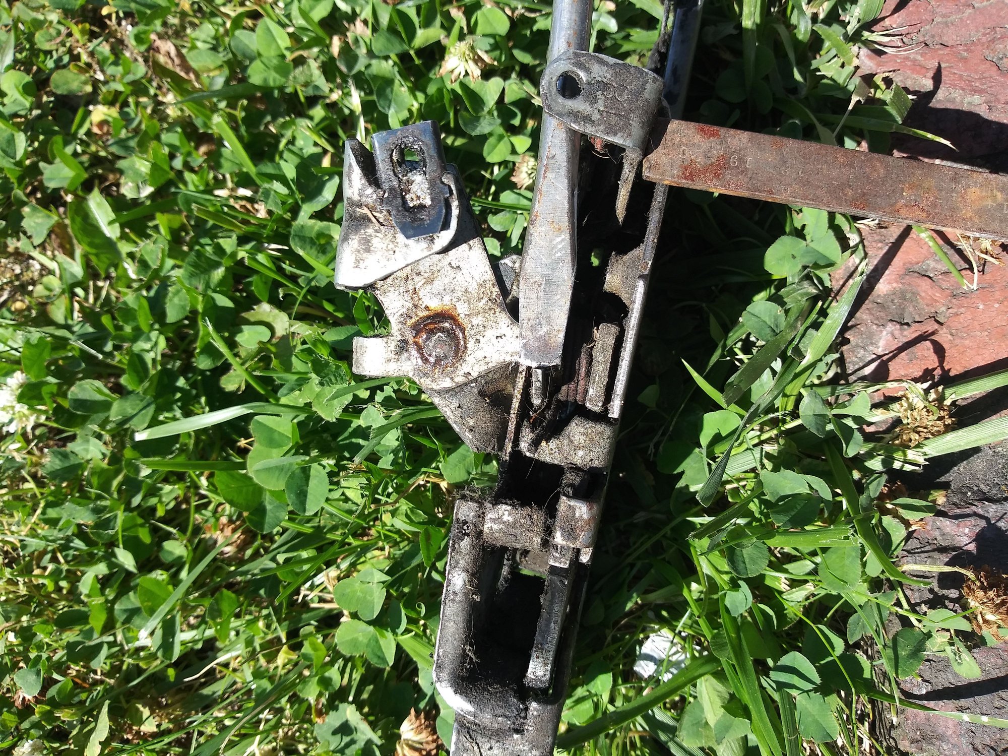

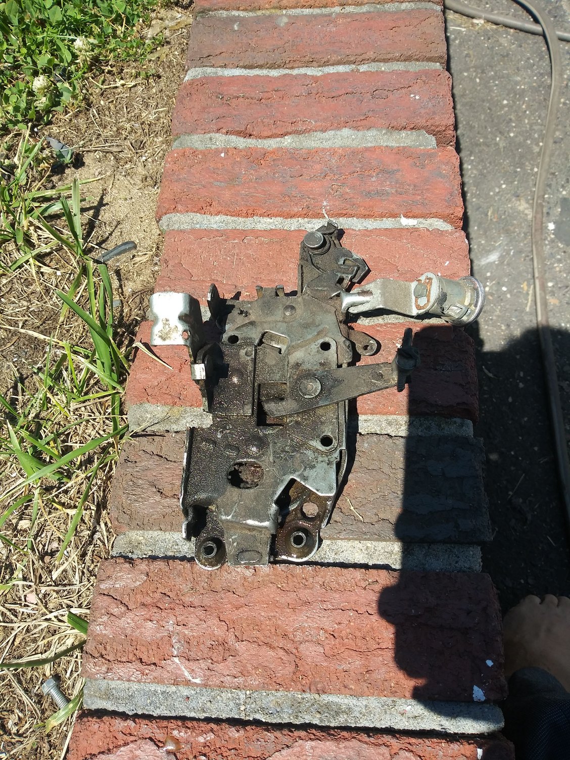

ok, here is basic door latch.
In this last shot can you just see the screwdriver tip touching the piece you have to push down .

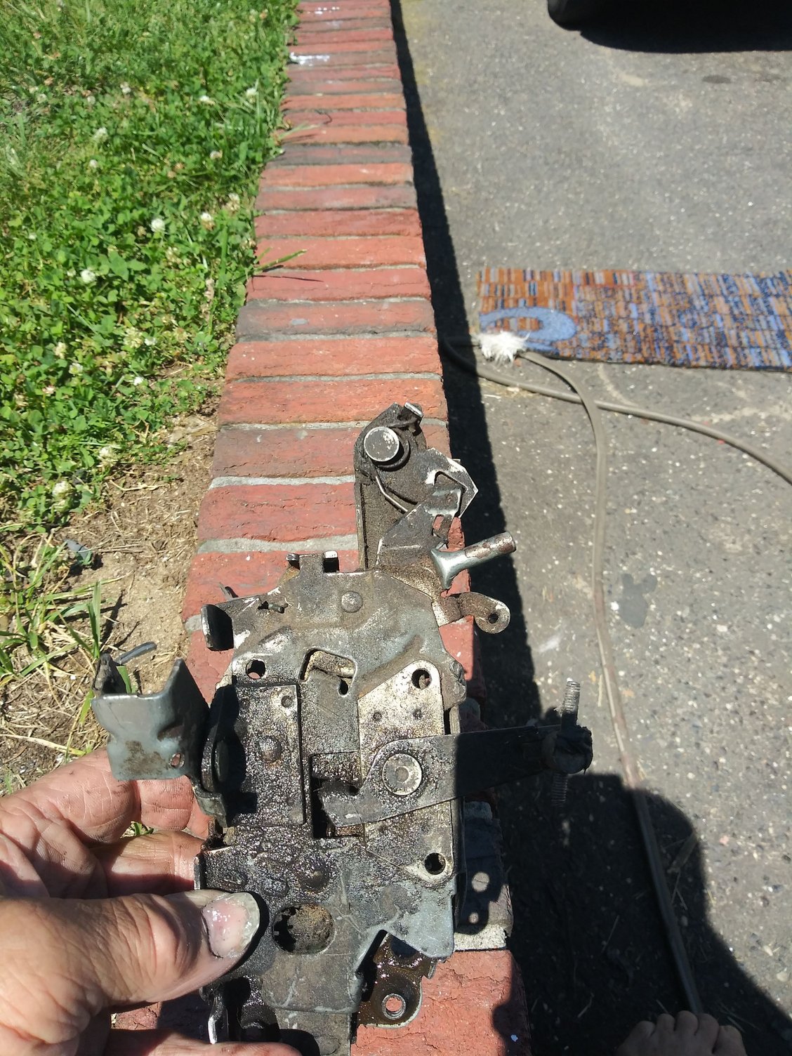

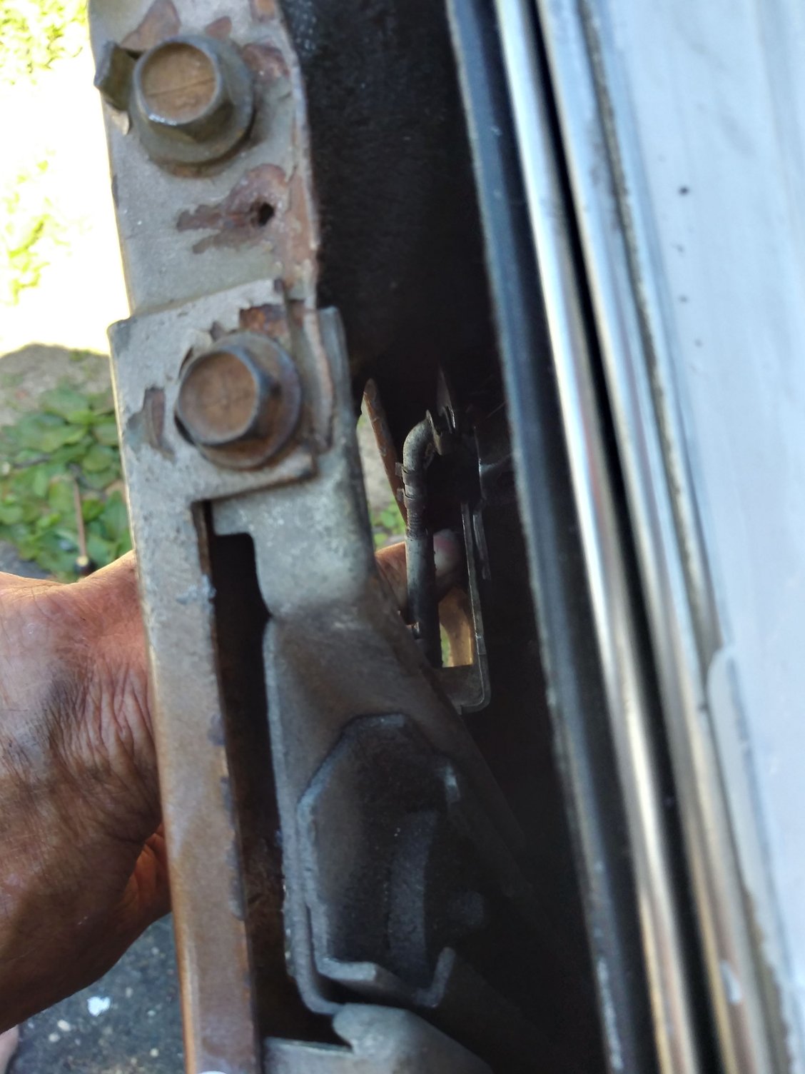

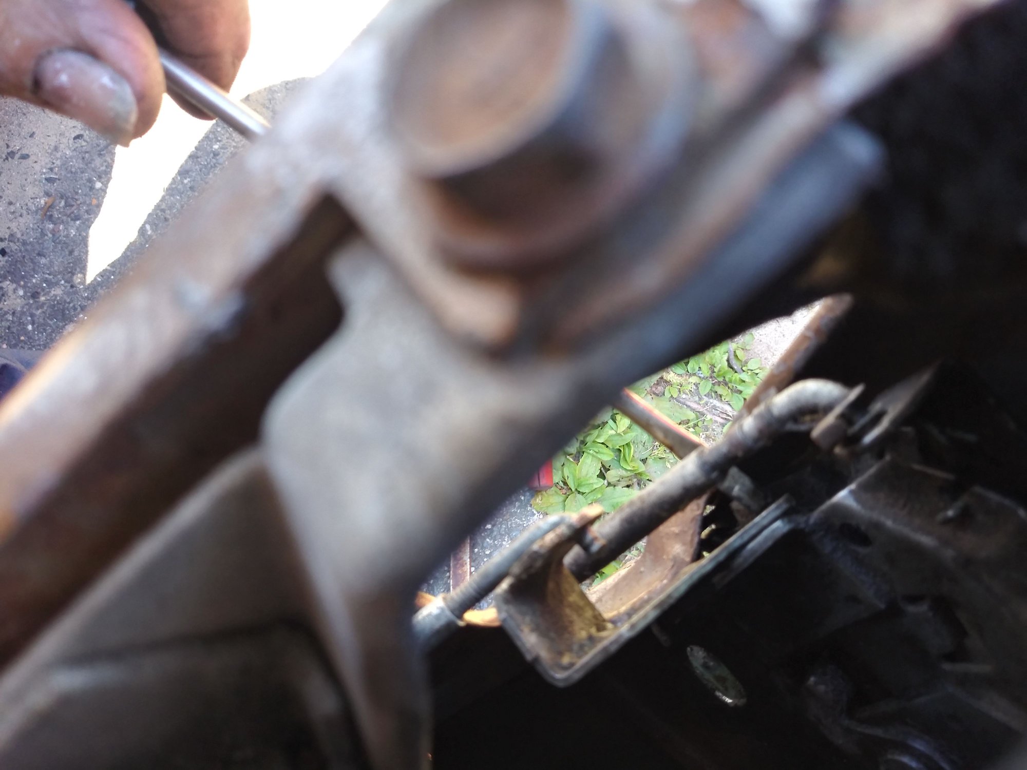

Okay this is now the right latch.
Top pictures screwdriver pointing the unlatch piece. The bottom pictures the angle the screwdriver has to be fed into from above to hit it. You have to sort of thread it behind the lock Rod coming from the inside door lock. The last pic and post 3 YouTube sort of see the window you have to thread the tool down through to get to the last point.

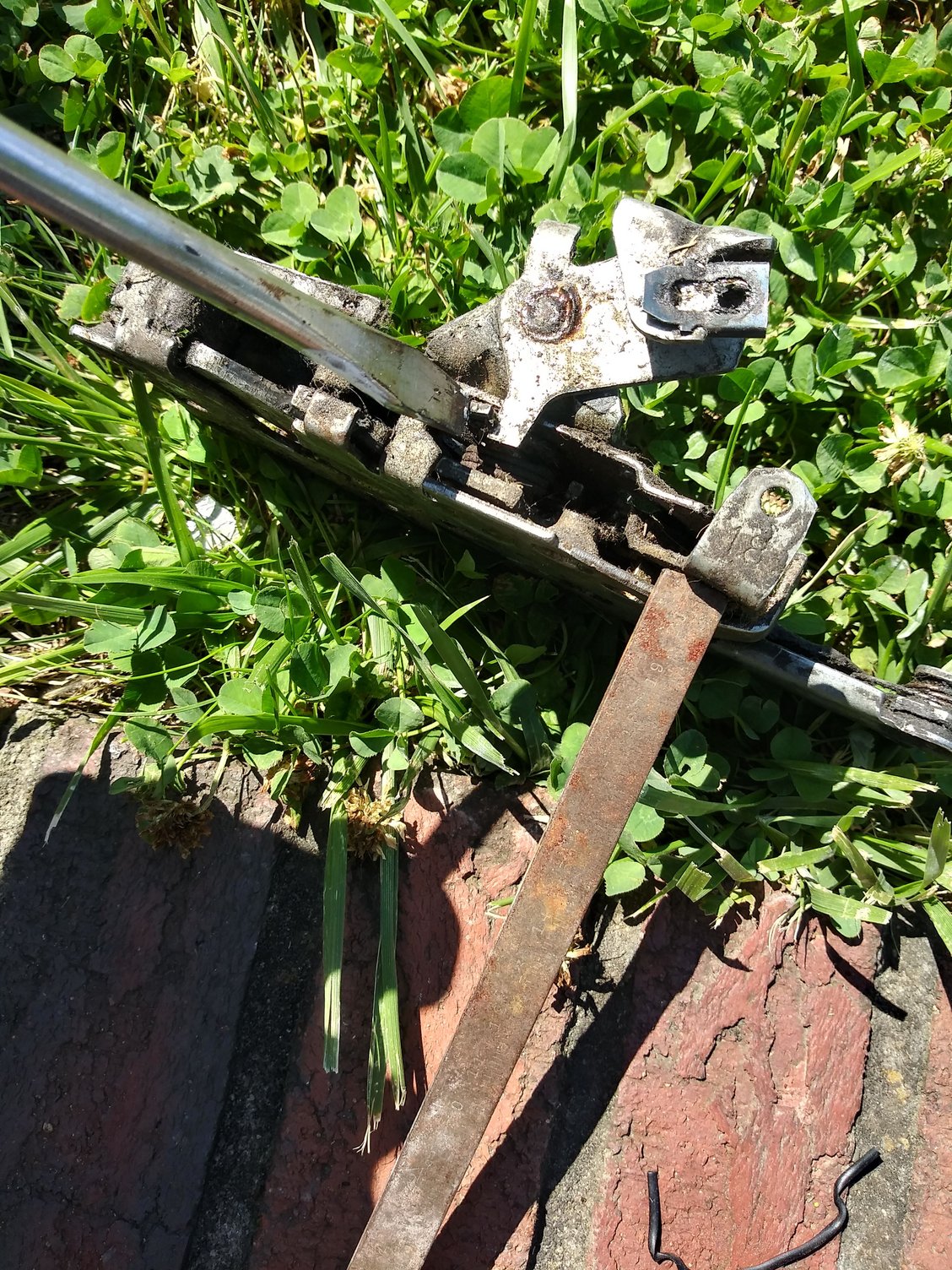

One more detail. It has to be unlocked. First pick you can see the door lock hanging off the side of the lock actuator. Second pic is up in the locked position. The window to feed tool through. You are going past the inside door lock lever. Bend a hook in a coat hanger. Hook it under and pull up on that lever.
