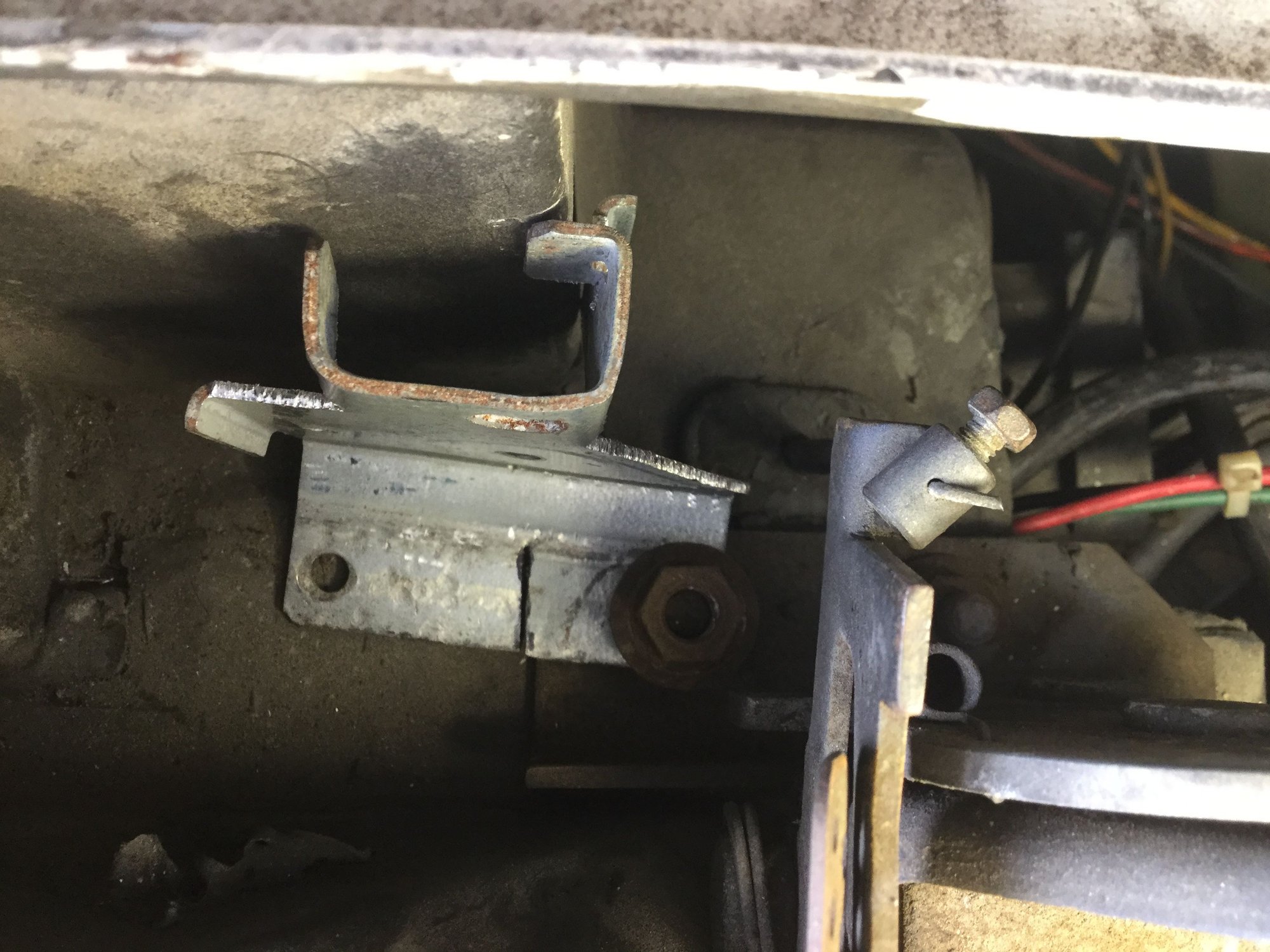

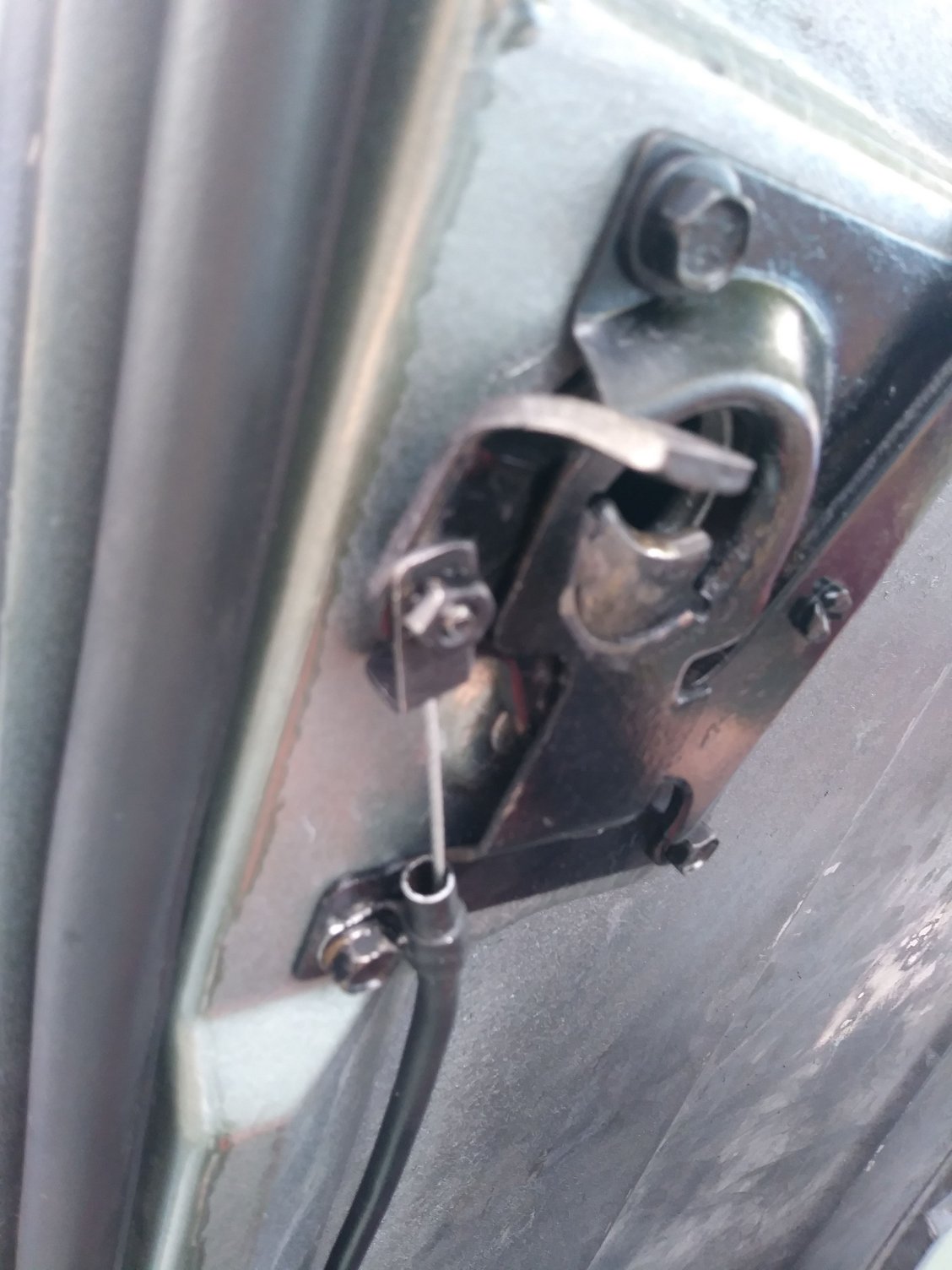

Sometimes you come across something you just don’t want to throw away...well I had an old dishwasher part thought may come in handy one day....It did.
Parts are wearing on my old ‘77 and afraid one day hood release cable could break so came up with a plan. Something similar could work for you.

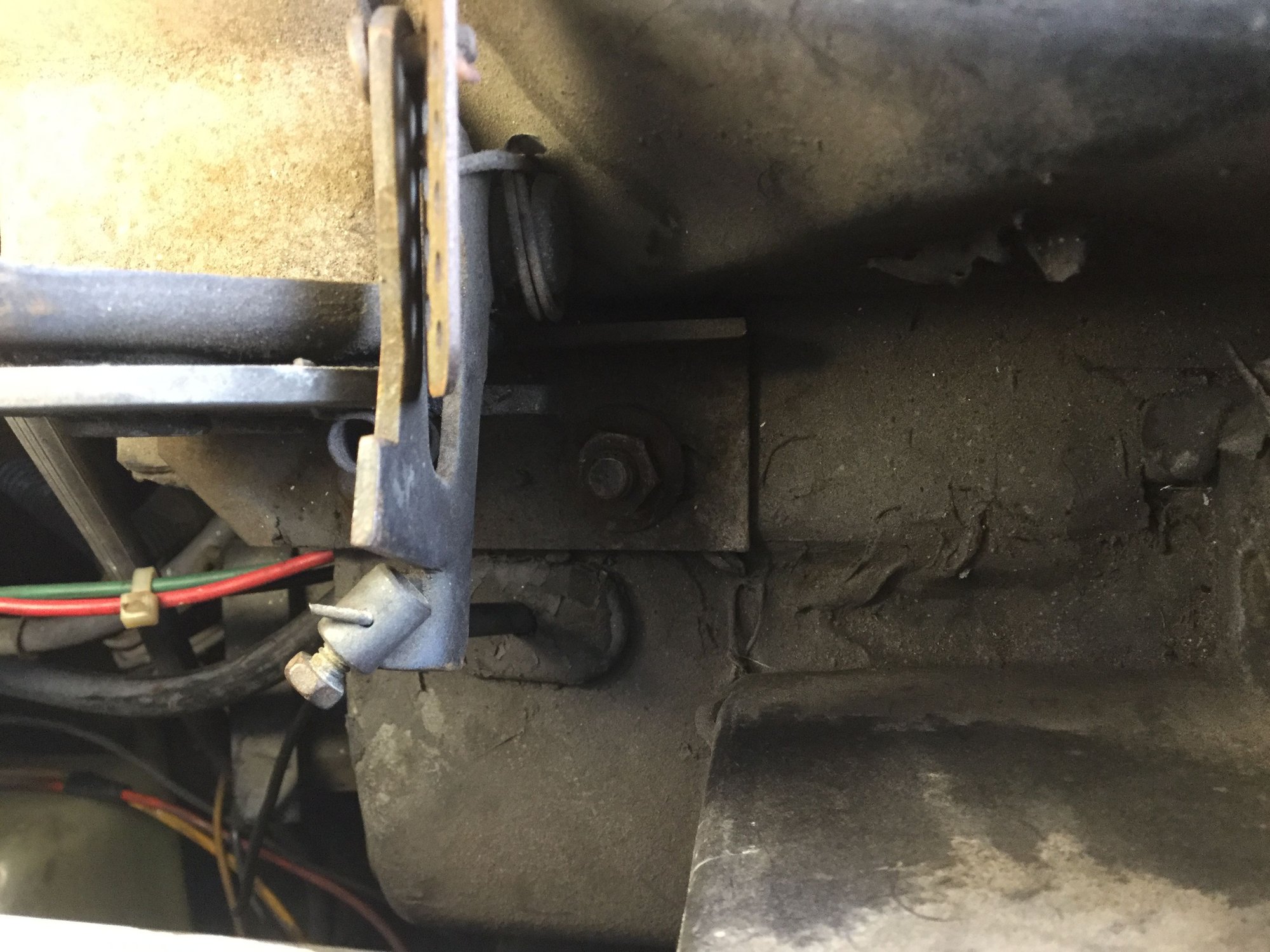

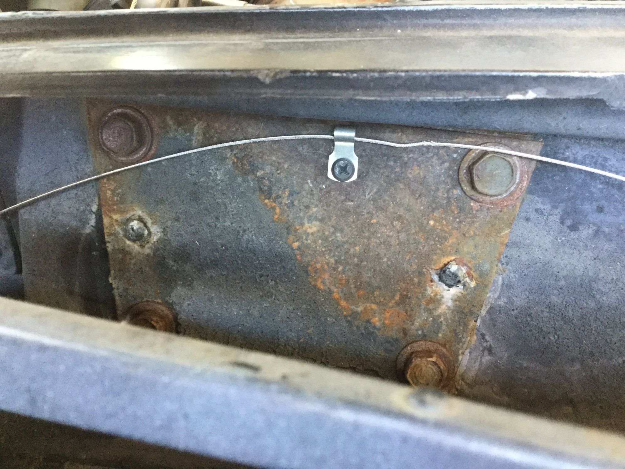

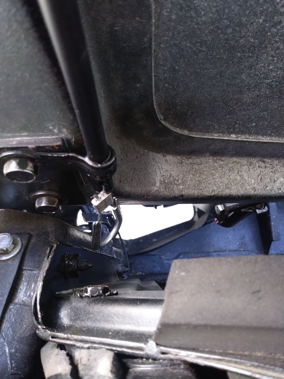

Couldn’t let other side lose out so wired it up with thin cable.
Room to mount along with original cable
Easy pull for each side
Should not get tangled in wiper arms
