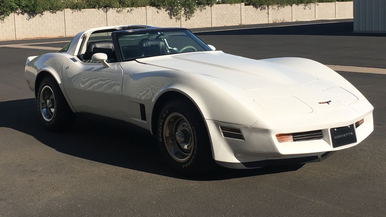

I know the photo has nothing to do with my question but I’m proud
