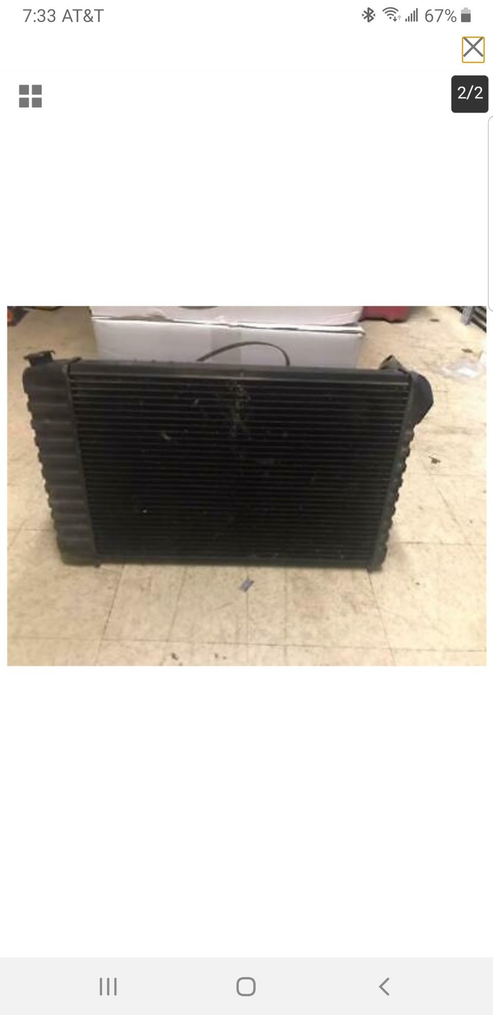

Old Jul 7, 2020 | 08:27 AM
dennis's Avatar
dennis
Joined: Sep 1999
Posts: 1,970
Likes: 91
Old Jul 7, 2020 | 11:05 AM

Charlie, the copper radiators have a miniscule date on them (see the excellent pictures from Dennis--above the MK9 tag is a date--April of 71 I believe) That dating is not included in the NCRS 70-72 judging manual because it has only come to light in recent years. The MK9 tag is not a date--it is a tag that indicates which radiator it is. I had a 71 LT-1 radiator that was EXTREMELY tired, and used the upper bar and side tanks to have a radiator shop graft them onto a new copper/brass core. It is absolutely correct in appearance, works perfectly, and cost a total of $320. To me, that was worth the price to have it correct.
