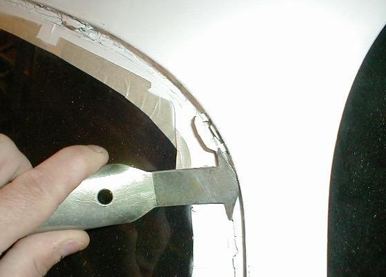

look around the 4:45 minute mark here and you can see how the clips works. The guy is just using a 90 deg pick but there are "special" tools as well
explained here
http://www.beldenspeed.com/beldenspe...gma-bodyheldon
one of the tools commonly used
M
