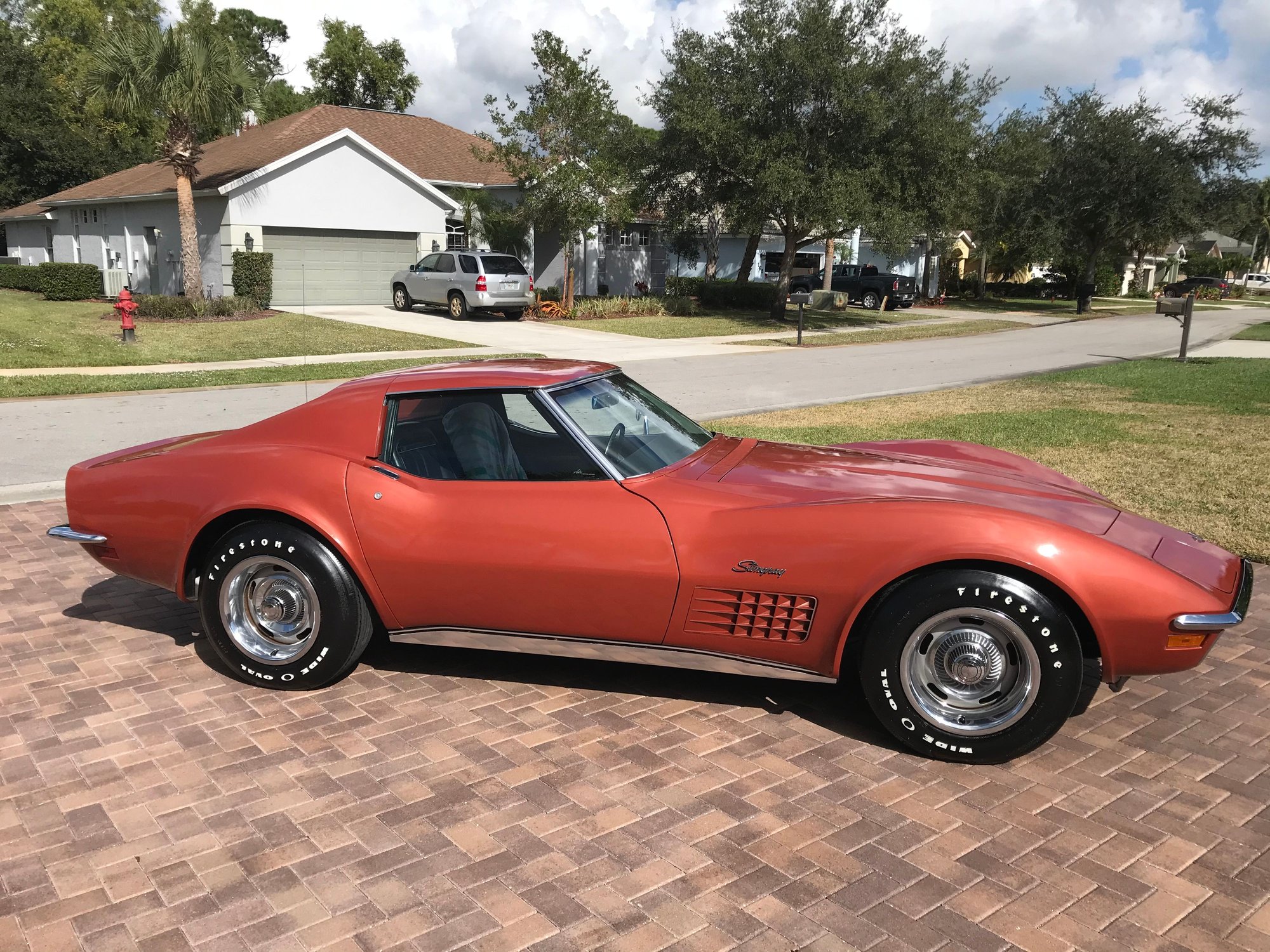

Hi,
I'm torn between adding vintage AC to my 70 350/350 4 speed 44,000 miles original paint car or selling it to find a car with AC.
Can anyone tell me if the install would permanently affect the car or if at some point it could be returned to it's original state and if anyone has done this could you tell me how efficient the AC is.
I would hate to ruin such an original car it runs, rides and drives awesome so I would also hate to sell it.
Pat

I like originality too. Particularly having the original engine and trans. The rest could be duplicated if you so desired with date correct parts.
I added Vintage Air to a few C3's. The last install was on a 68 convertible. Vintage Air works great in Louisiana and is close to a "must have" here and I suspect cools better than the original R12 A6 compressor setup. When I finally sold this 68 to move on to the next C3 adventure, the buyer did not want the Vintage Air as he lived in Minnesota. So, we worked a deal that I would uninstall the Vintage Air and put this 68 back to a non a/c Corvette. I gave the buyer a credit and I got to keep the Vintage Air for the next C3 project. Not a big deal other than labor to "uninstall" the Vintage Air. The only what I would call invasive work is you have to cut the fiberglass firewall a small amount to fit the VA evap unit. For this 68, I merely refiberglassed the cutout and trimmed back to the original opening. I suppose if you pulled out the all the dash and the new heater core, and looked hard, you could find my repair, but after sanding and painting it was hard to see.
So, yes I say Vintage Air is the best way to go and yes it is reversible.
Vintage Air instructions are online at their website if you want to see how it is installed.
Hope this helps, Nice Corvette!!!

Thats a great looking car. If you are concerned about Originality you could store all the parts that you remove in order to install Vintage Air (or a similar brand).
My Vintage Air worked well in my '34 street rod...I did take my time installing it.
First...you should see how much you can sell your car for as is.
IF you have to take a loss you would do better to put Vintage Air in your car (IMHO).

I see you live in Florida. Do yourself a favor and install the VA system in your beautiful 70 coupe. The chances of finding a car as nice as yours with low mileage is slim. I installed a VA system in my black/black 66 coupe. It cools much better and more efficiently than my factory 68 setup. One of my buddies installed a Classic Air system in his original 70 LT1. He can now comfortably drive the car all months here in central Florida. Keep the car, add the AC system. Jerry
