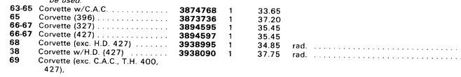

Can anyone shed some light on questions regarding BB radiators? I have a (what was described to me) 67 BB radiator.It has the filler neck on the pass side positioned straight up.Is this the same as a 68 BB?
I also have the oportunity to buy a (advertised) 68 BB radiator with no filler neck,using,I resume, an expansion tank. no numbers are available.According to my NCRS book,68 BB radiators all did not use an expansion tank,but 69's did. Anyone want to jump in? thanks

'67s and '68s used different radiators:
The '69s used a variety of radiators which were also used through '72 but not shared with '68. The early C3s suffered from potential overheating issues due to the new nose shape and more severely slanted radiator mount. I'm thinking the '69 design using the expansion tank was a response to this problem. Whether a '69-'72 radiator will fit in a '68, I believe, would depend on the mounting frame.

Yes the 67 will work I have the Dewitts 67 BB ( and that is how they ar sold. You can’t use a 69 or later in a 68, it’s too wide and won’t fit between the frame rails) which is also for the 68 small block 327 automatics (but they both need the BB radiator support if you were doing a conversion) Are you looking for a functional radiator or the NCRS version. I have the filler neck and just run the overflow hose to the overflow spout on the expansion tank
I don’t know what that list is from but it doesn’t apply to what’s available now
