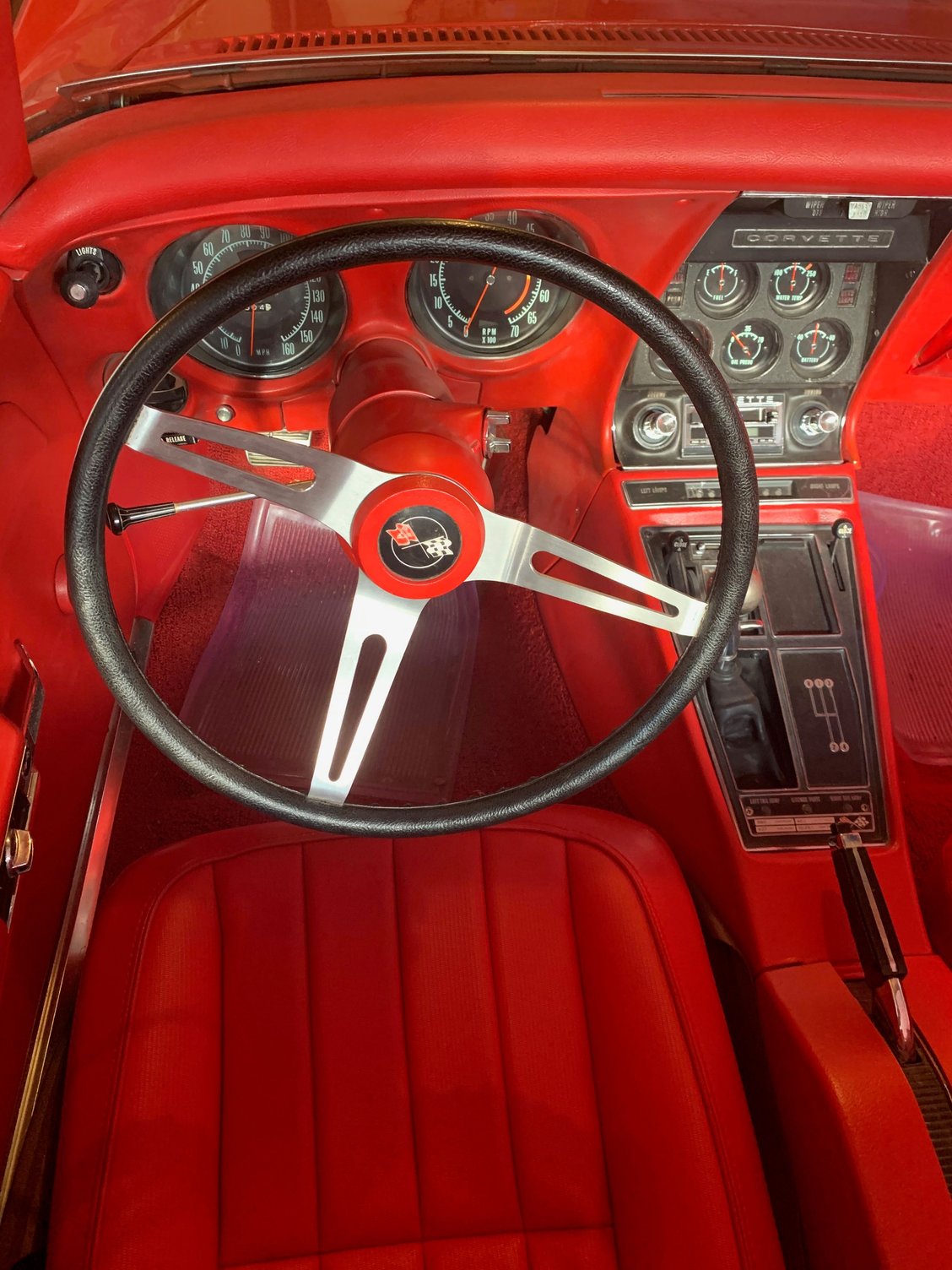

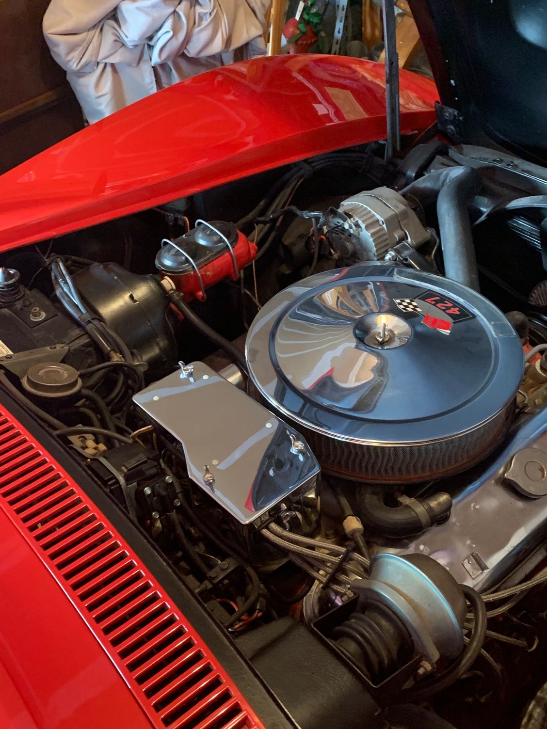

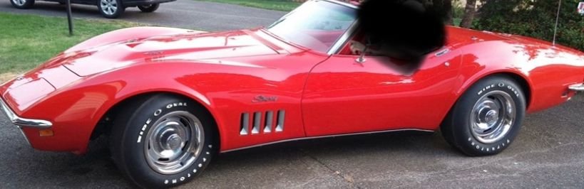

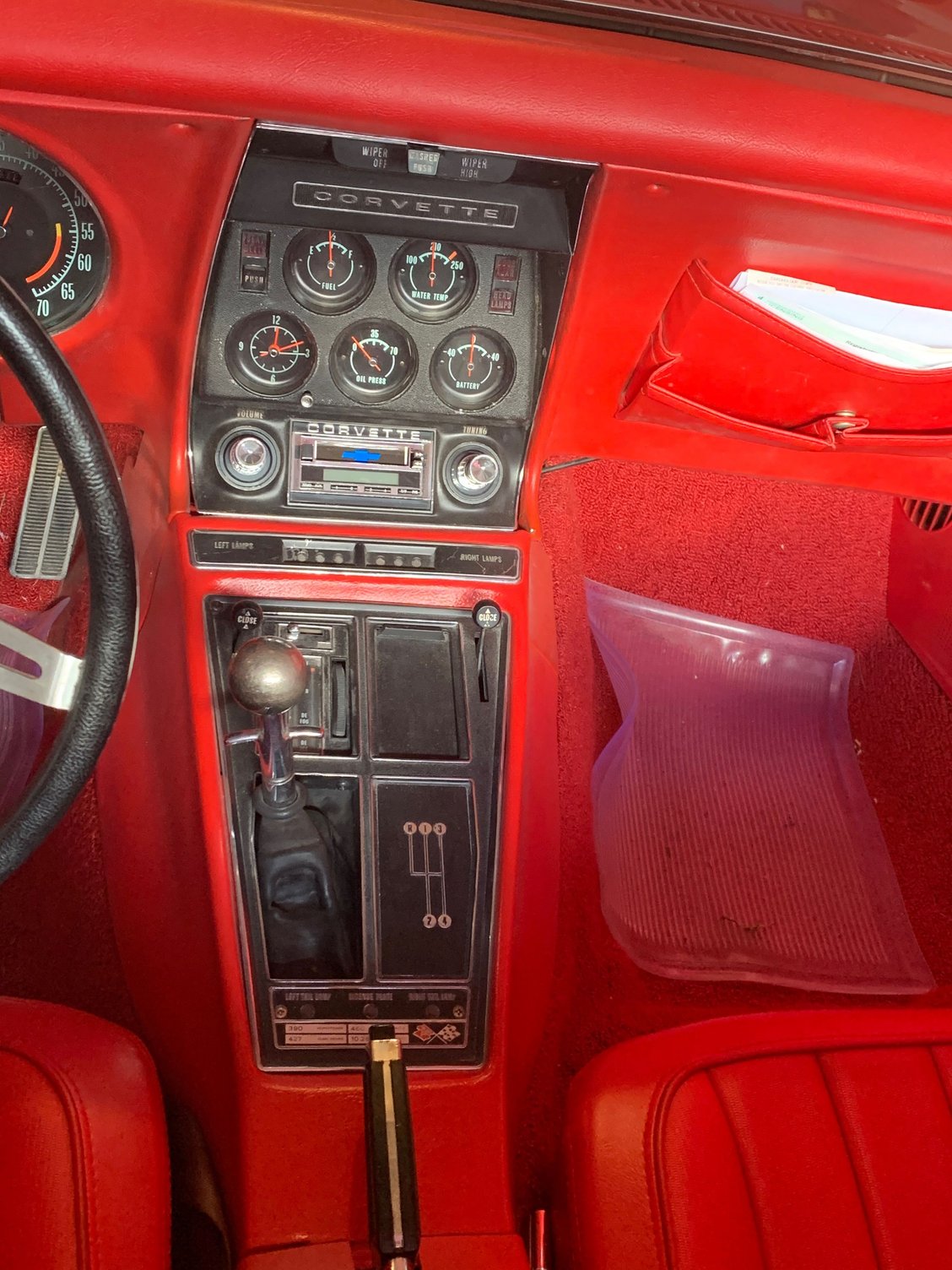

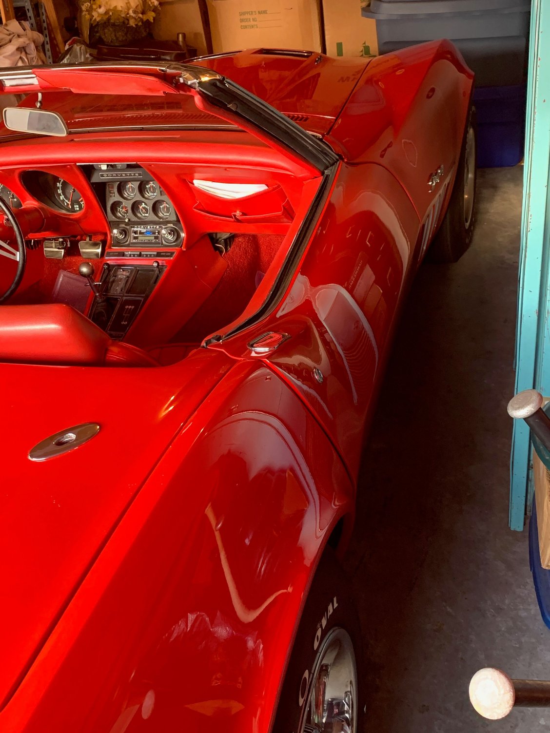

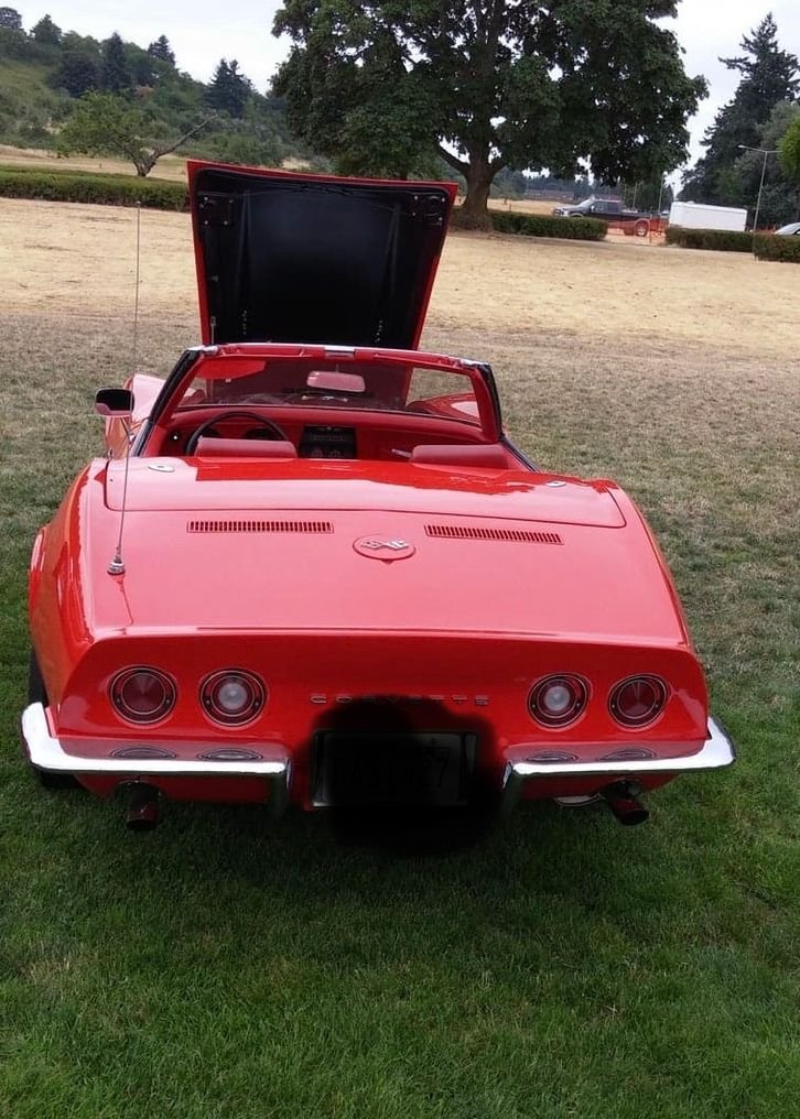

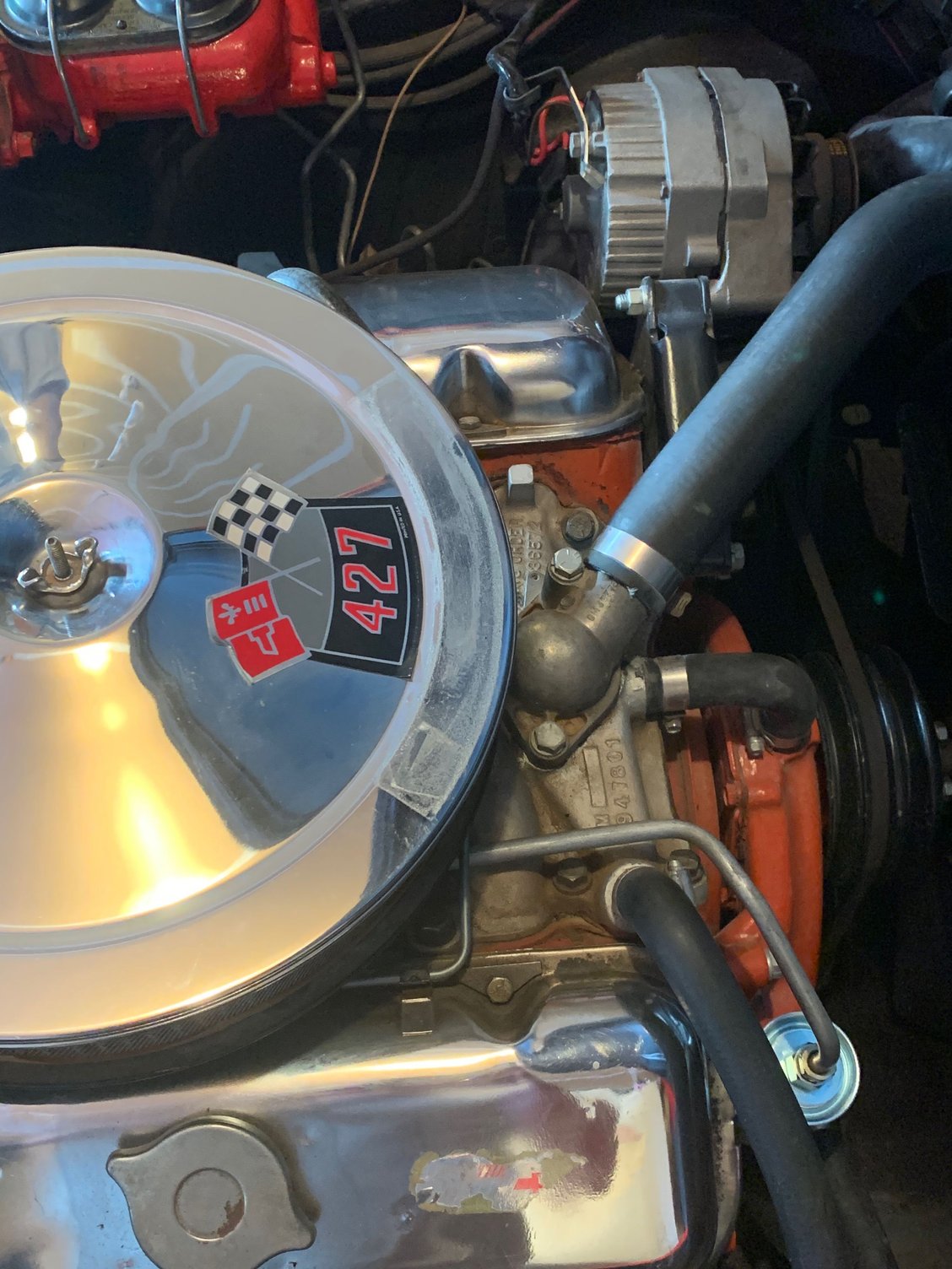

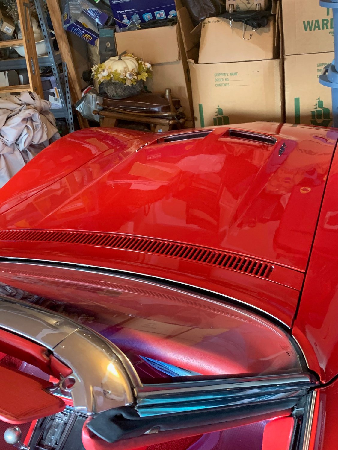

I haven’t seen it in person, but here are a few photos sent to me. Appreciate your thoughts.

worthless. the sticker is gone off the valve cover... looks very nice in these pics. body gaps look good. looks pretty original. downside is it does NOT look like it is owned by a clueless idiot that has no clue it is worth more than 10k... i guess you meant yourself as the wannabe. cuz a car like this is what most of us wannabe driving. tell the owners to get the crap out of the map pocket.

Current owner has had the car more than 20 years, and had it restored not long after purchasing. I don’t know how extensive the restoration was, but supposedly they have all records. Cosmetically it looks very nice. Engine bay is clean but not eat-off-it clean, and I would assume/hope underside is similar. Owner has only driven it sparingly since restoration because it’s a tight squeeze, and has kept it indoors under cover. From what I can see, besides the 427 it has power brakes. I can’t see in the photos anything to indicate power steering. Also looks like an aftermarket radio. I’m not looking for a steal here (nice as that would be); just what is fair for everyone.

As good as it looks if your offereing, I would offer upper 30's.. Its in great shape, I was looking at he panel gaps as well and looking for wires hanging out and anything out of place.........Is he selling becasue he doesnt use it anymore or is it a have to sell situation? If you really want to be fair have an appraiser come look at it or take the pictures you have to someone that has decades of experience. You'll get an honest assesment. zooming in its a 390HP car with no power window or AC so that puts it closer to the bottom of the expensive list but again, the owner looks like he did a great job on it....much better than mine.

As Rescue said above it's an lower optioned L36 427, appears to be in nice condition although you'll need to look it over in the air on a lift. There are some incorrect and missing items (smog pump for example), not sure if that matters to you if you wish to have it judged.

Wow, that's nice. Good luck with the negotiations.

I am not interested in having a car judged, but I Do prefer originality. I am curious what else you see in the photos that are missing or incorrect. Thanks for your thoughts.

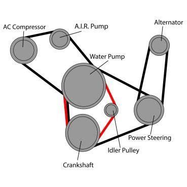

The missing smog pump was already mentioned. Tough to see in the image, but looking at the belt angles, is it possible there is a power steering pump, matching this routing diagram?
If you care about originality, I'd think you'd want to confirm that the numbers match. This is more than just checking that a partial VIN is stamped on the block. Make sure the three-letter engine code matches what is there, dates and numbers match on the carb, you don't have an engine that came with an automatic, only to now have a manual. Thing like that. If you are willing to pay a premium for originality, check all of that. This site has some codes to check.

Also, although it is red on red now, is that how it came from the factory? It may matter to you, it may not. Hopefully the trim tag is original, matches what is there, and is not counterfeit like many are on black cars.

Based on what I can see of the alternator belt, I think the car has power steering, in addition to power brakes. NO power windows, no A/C, aftermarket radio [but it says "CORVETTE"],
Oh...and the master cylinder is painted RED !! Well, nothing is perfect............
