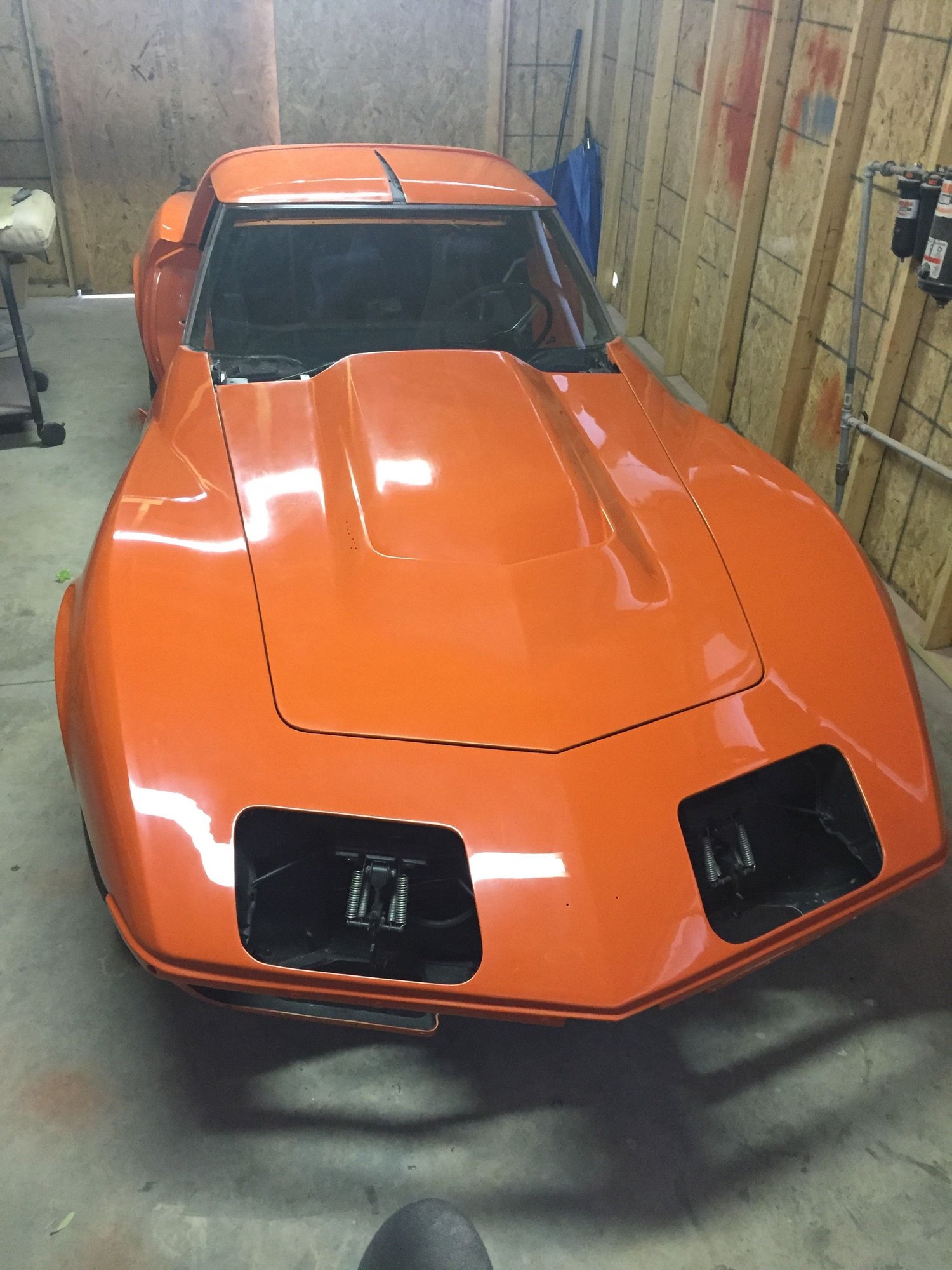

you can definately do it yourself i was a beginner and read tons of info on the subject.
Paint / materials / gun / compressor, etc cost me about 3,000.00
Painted it my self, single stage poly, cut and buffed....

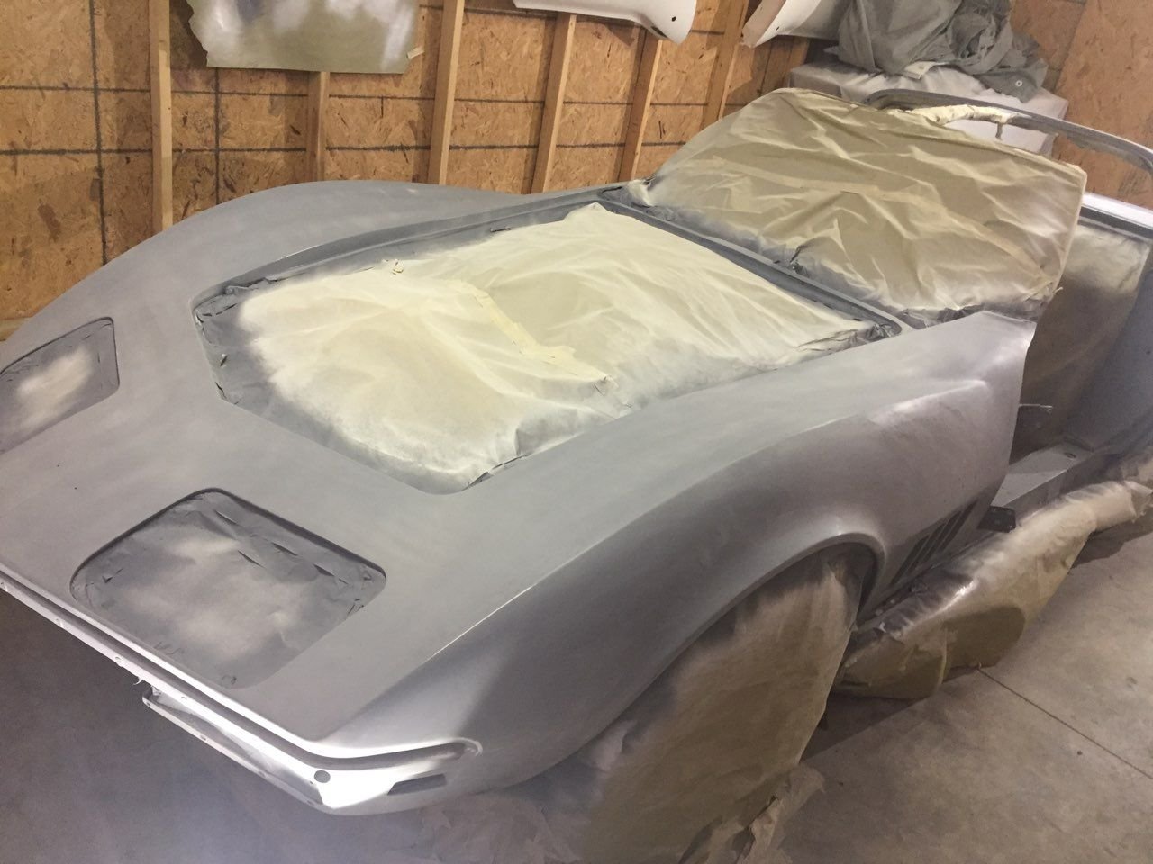

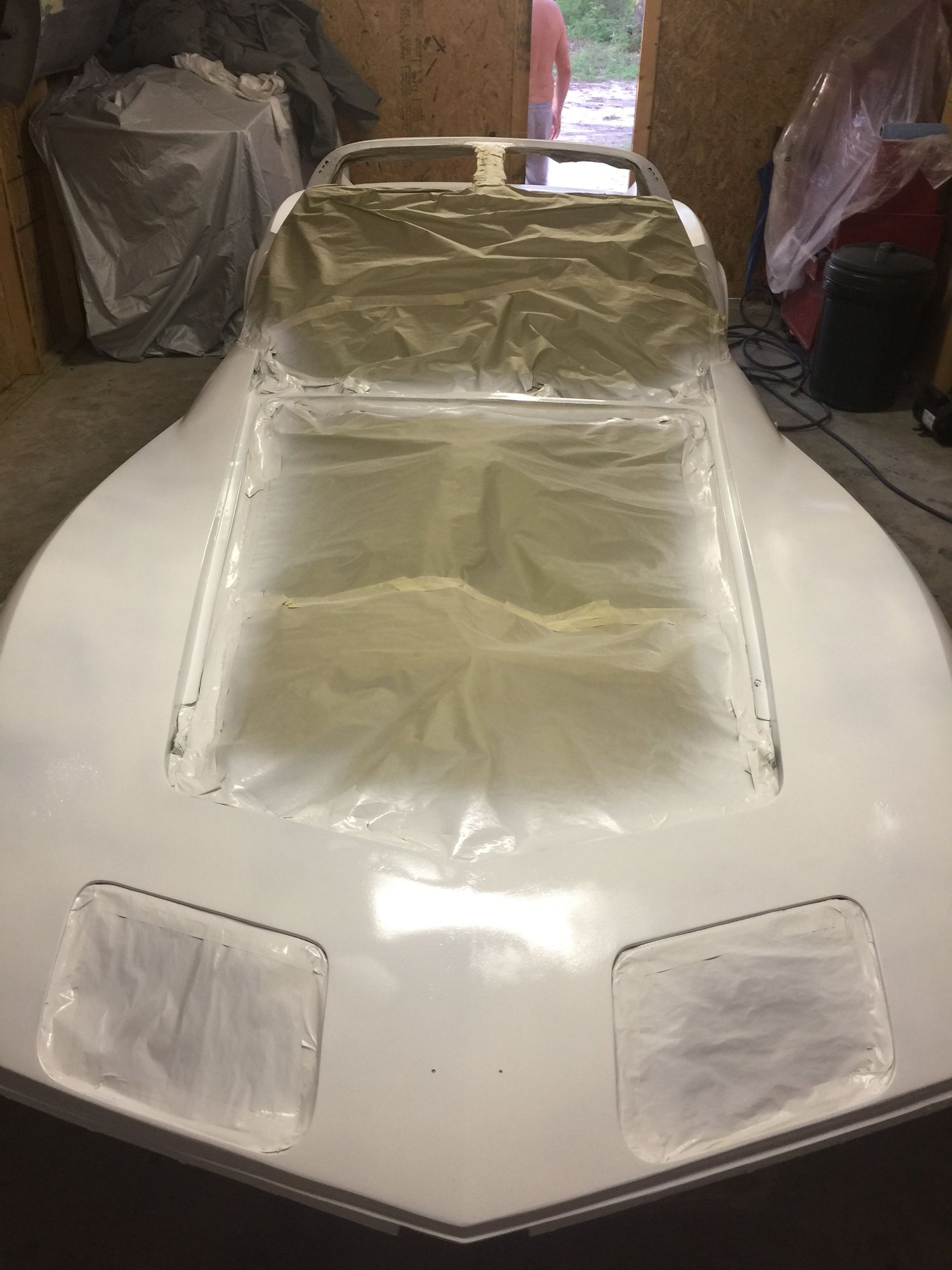

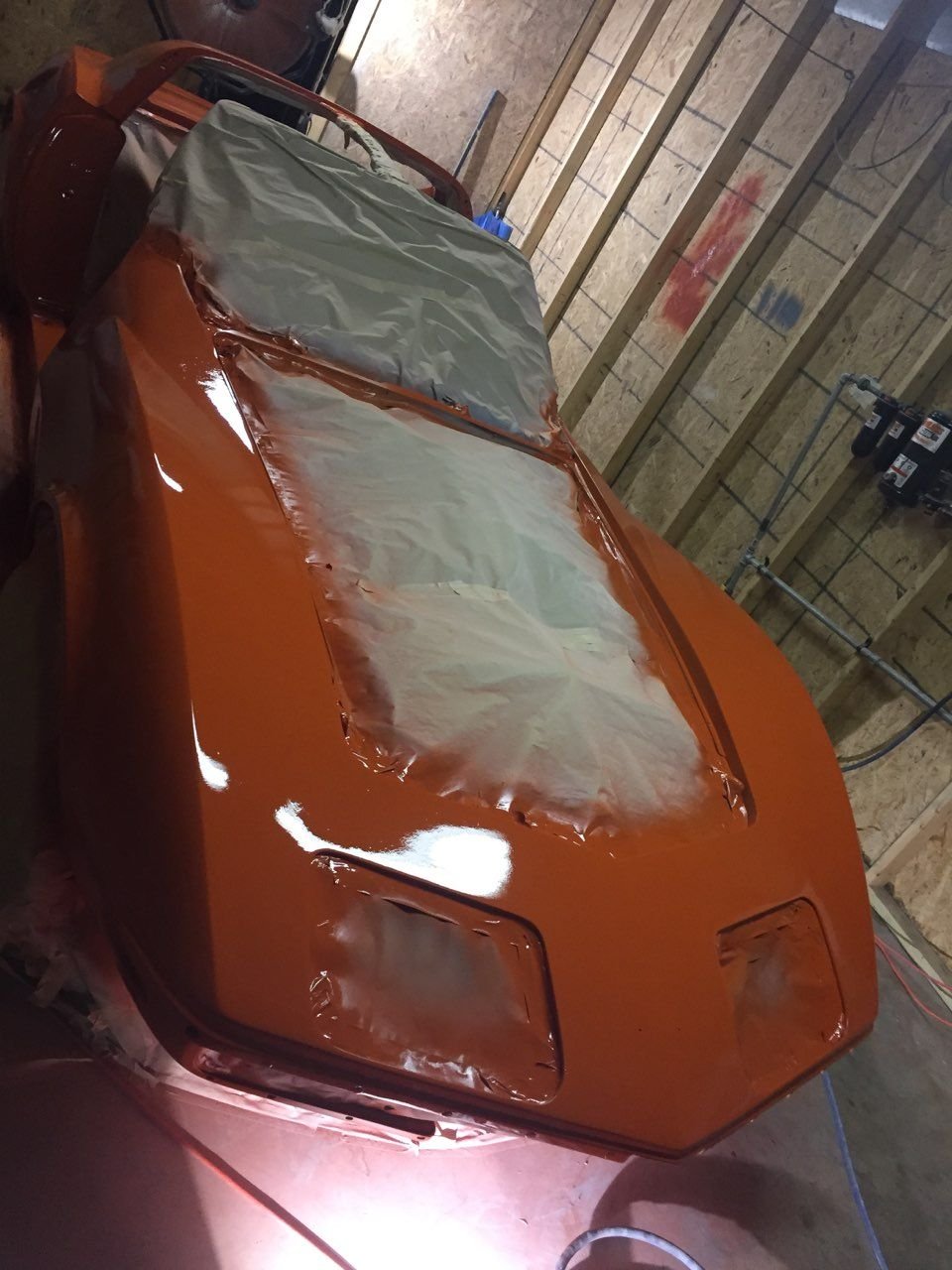

I just finished painting my 71 convertible...stripped to bare fiberglass, primer, base/clear, wet sanding to eliminate the orange peel from my 1st time paintjob, in my garage. It took months. From my perspective someone else doing the job is worth it, provided you are confident the work will be done well and on your timeline. I have a whole new respect for the people that do this type of work for a living. Having said all this there is no better feeling than having someone look at my finished product and ask who/where it was painted, and I can say I did it myself right here. Good luck!

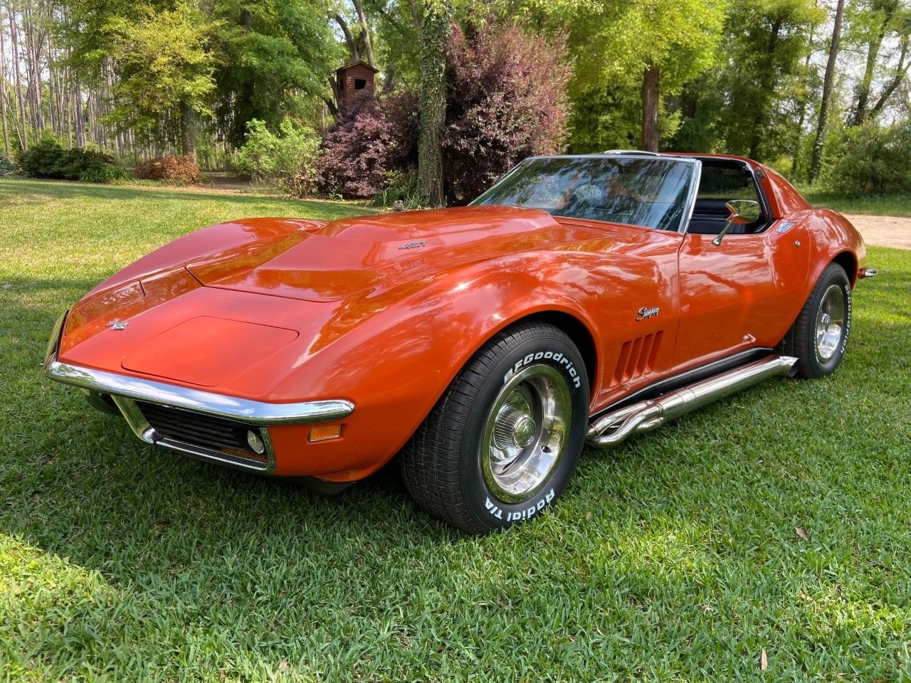

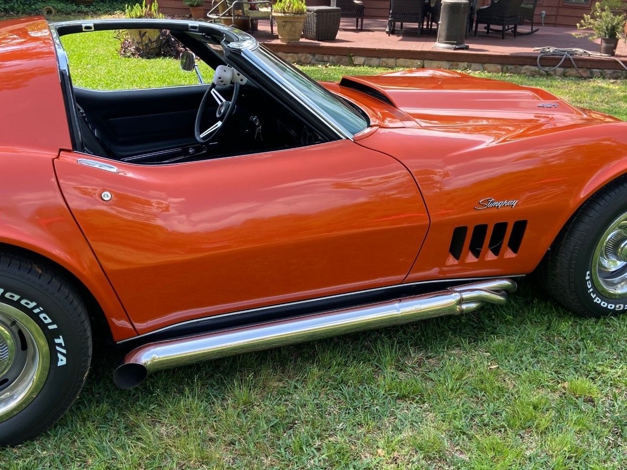

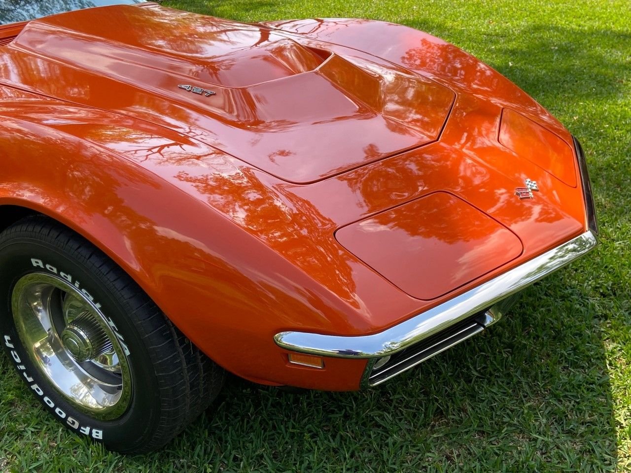

An excellent post. You didn't miss much. I did my car myself and it is near show quality. It can be done by an amateur. I would add two things:
(3)a DO NOT round over any creases in the fiberglass. So easy to make this mistake and you will never get that edge back.
and
Material costs alone are big numbers. For quality PPG paint and other supplies, I added up some $3600 in materials alone. I did recoup some costs reselling the leftovers.
