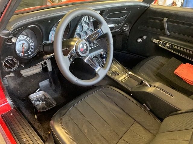

6'1" 220. need More Headroom.
Did this...........
Then This..................
All Gooder Now
Have a Great Day,
Bill
