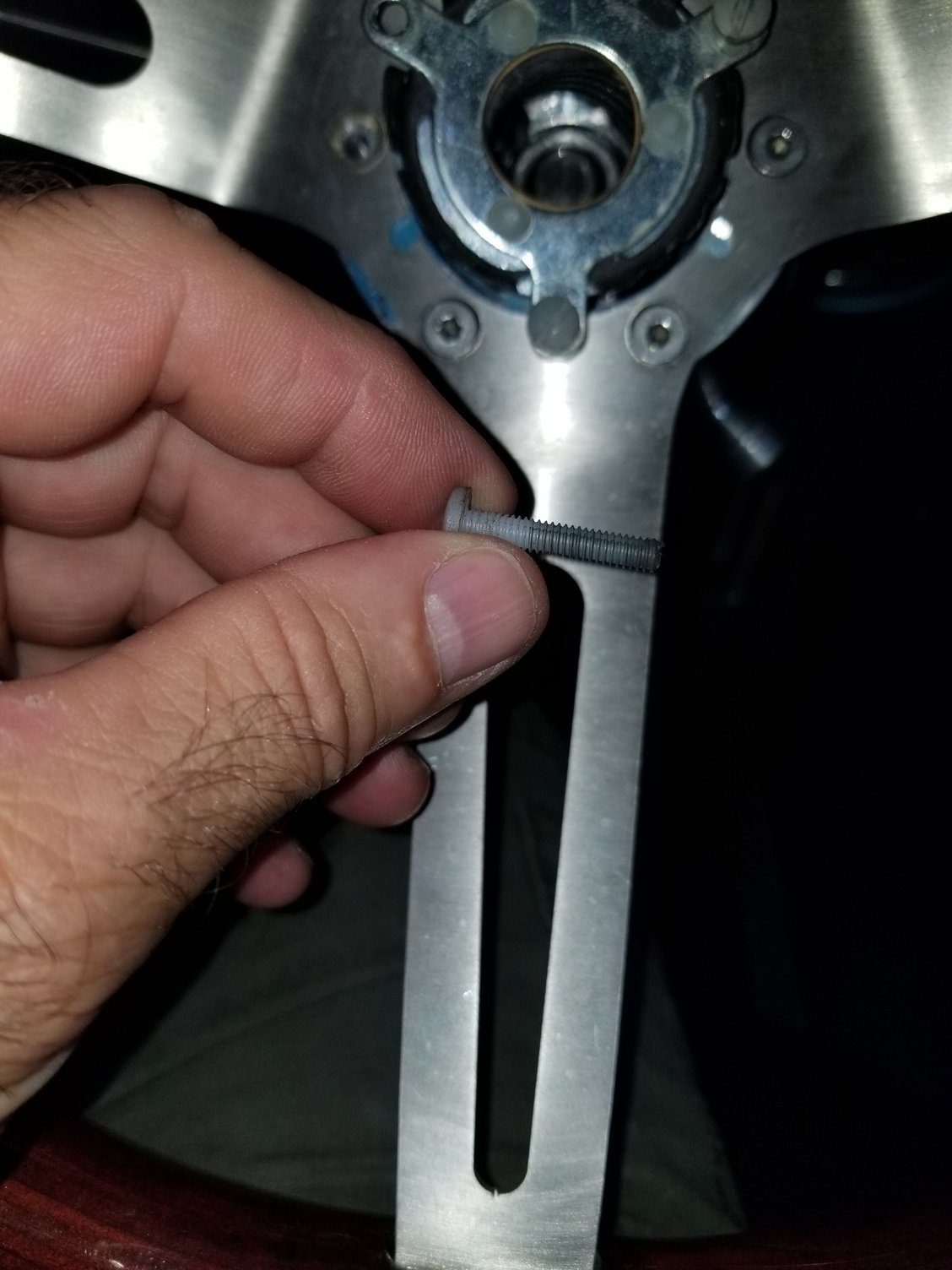

Kevin asked about how I hooked up my horn. It's mostly stock parts that pieced togther, my original was pretty Bubba'd by the po but I was able to get it to work with the IDIDIT column and steering wheel adapter.. Some extra insulation was needed due to the universal fit
Bottom horn contact. I had to insulate the tabs with gaff tape
You can see I added girth to the horn post due to the size of the hole in the adapter. The girth keeps it centered so the horn post doesn't fall off the spring loaded ground pin
You can see the hole diameter in the adapter would let the pin move enough to fall off this tiny post on the button contact
I used a short piece of hose to insulate the top of the pin and keep it centered in the IDIDIT adapter
An insulated spring to prevent grounding
How it looks installed
Installing the button with plastic screws I got at Ace hardware
