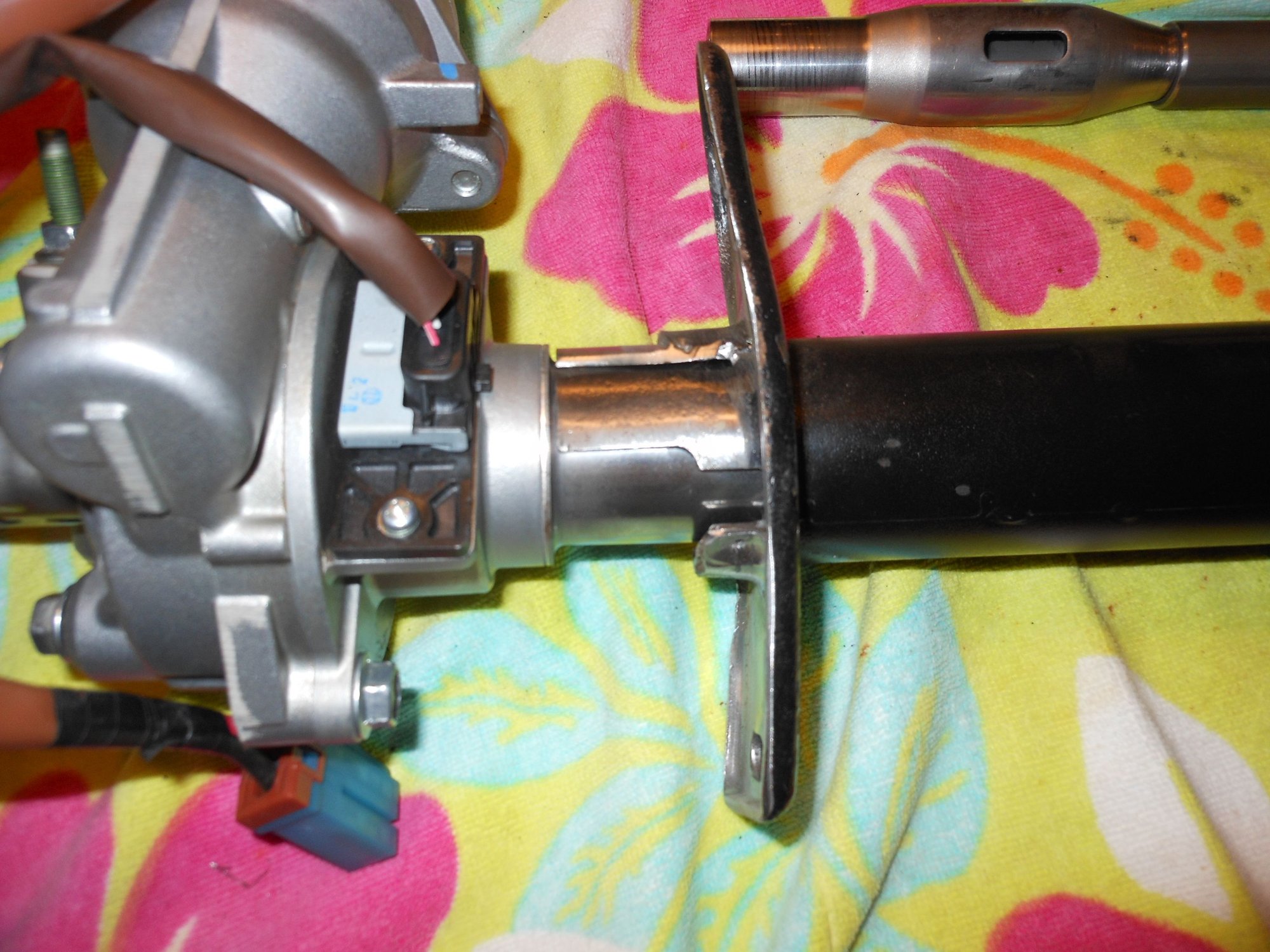

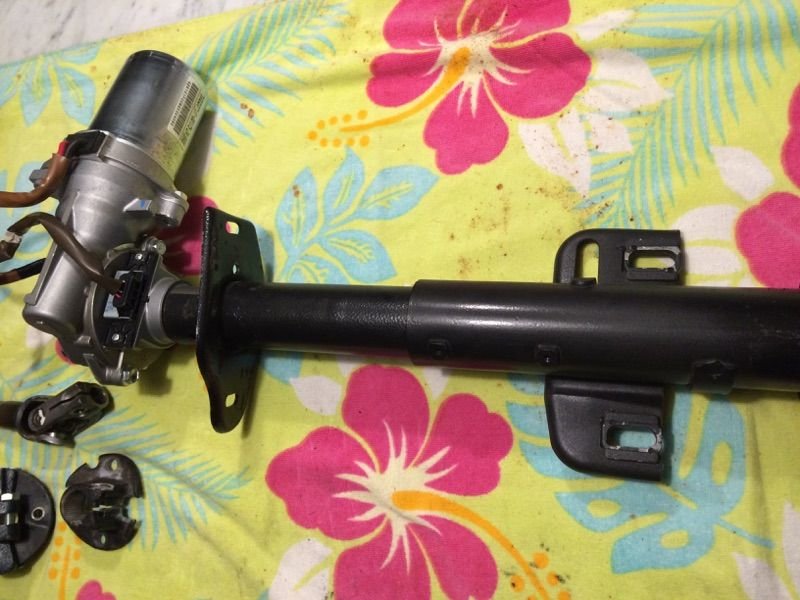

I made my own- About $100 all in.
2010 Nissan Cube- from the junkyard- $35 motor/shaft /control box
two u-joints about $70
I mounted it on the firewall-
I also went with a Flaming River manual Rack and Pinion.
New they are $1400- got one off a stalled project for $500
Anyway- I was a lot of fabbing and testing to make/design/cut/weld the steering column-
But the results turned out great!!!

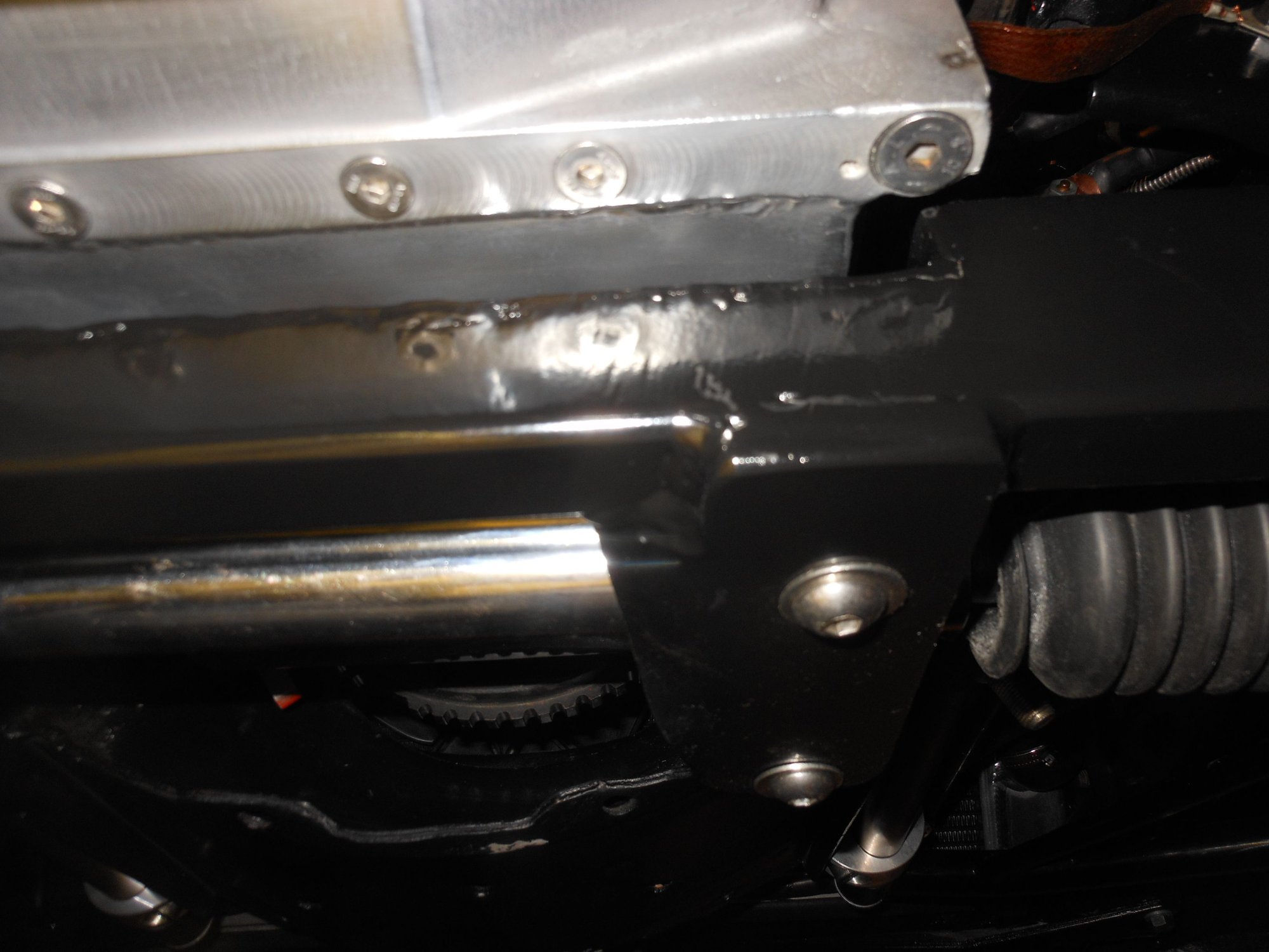

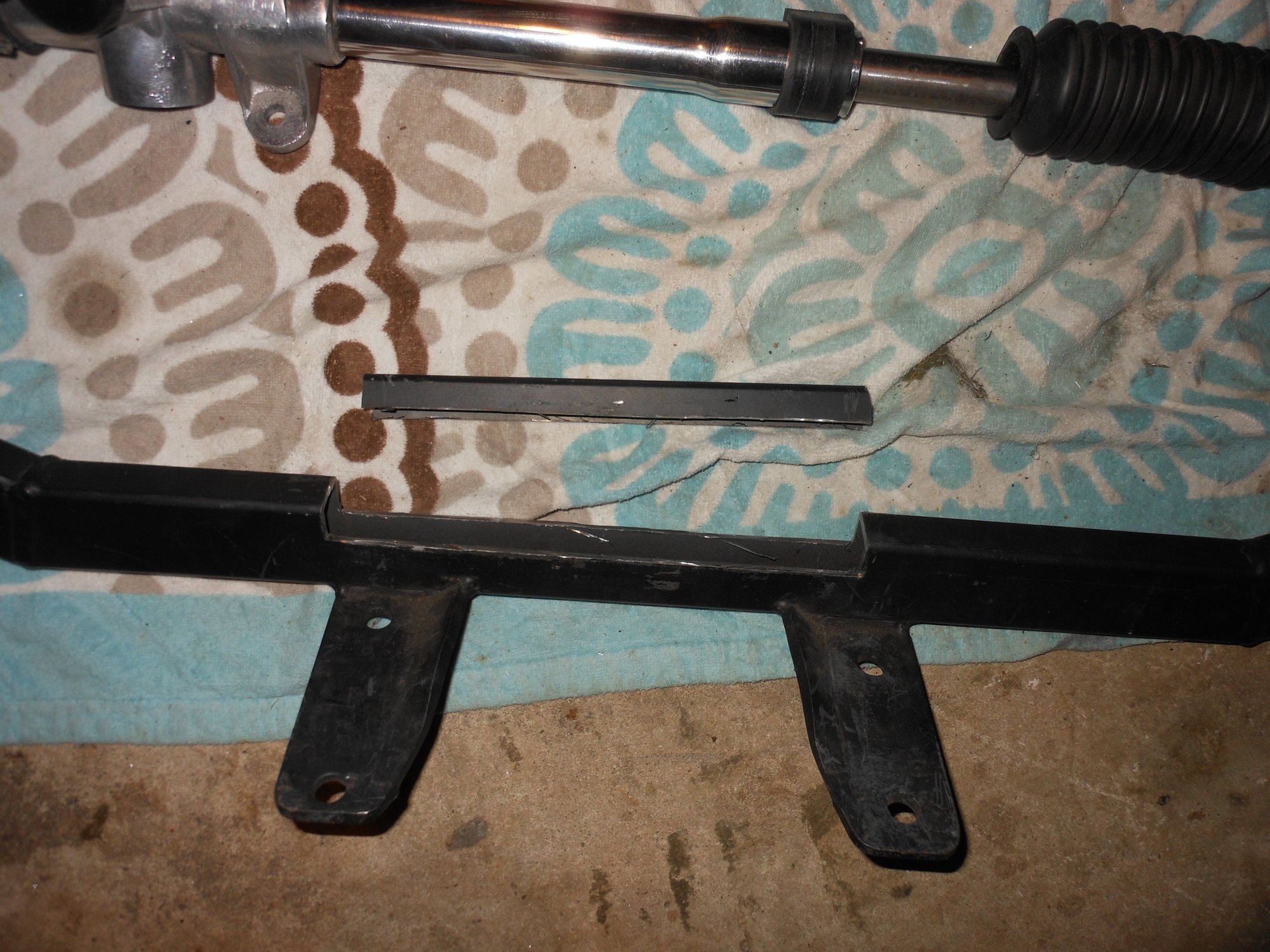

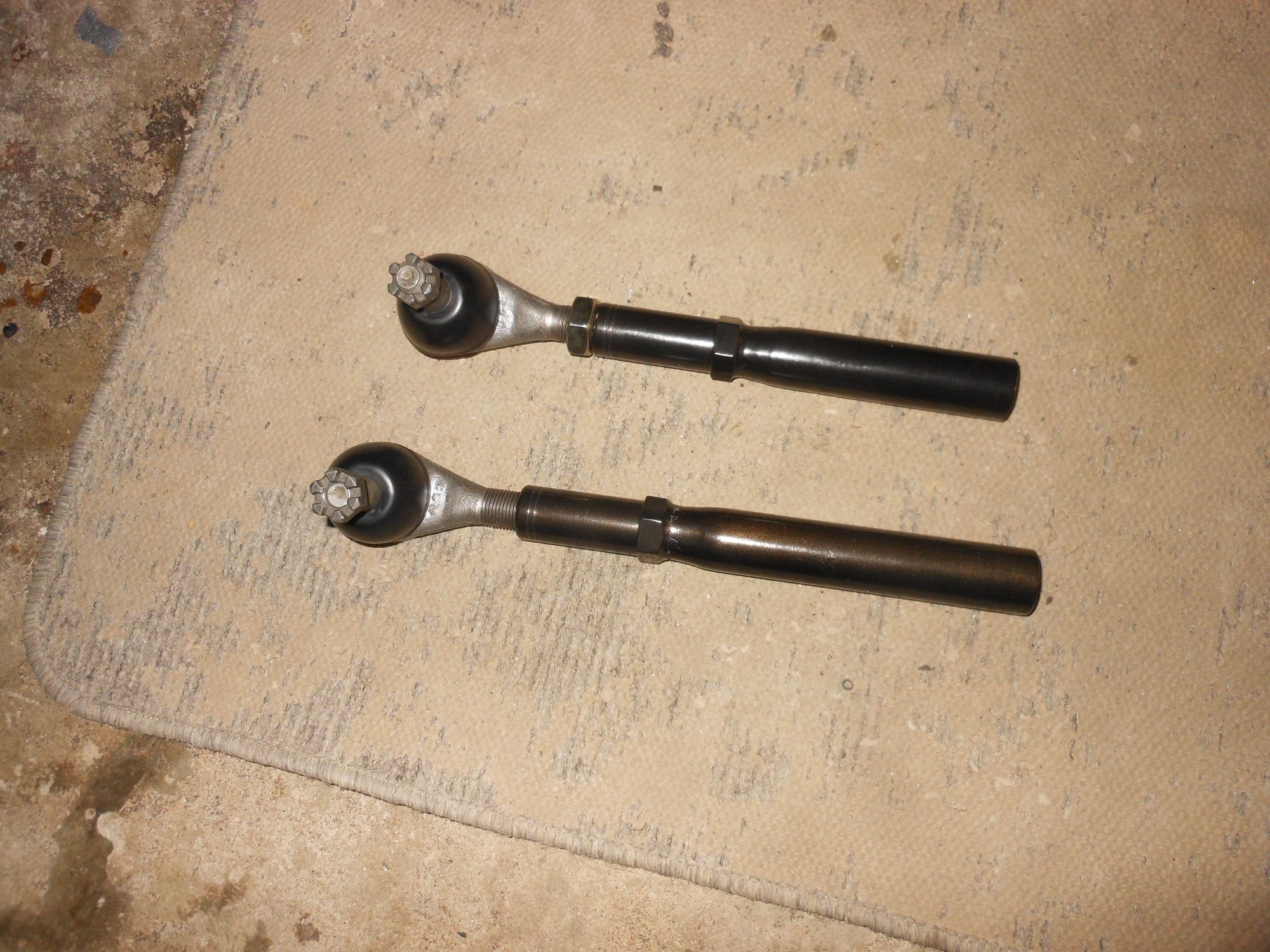

Had to teak the cradle for the Flaming River to get it to fit AND added tubing it the frame so it would not compress the it.
The threads are BOTH RH- so I bought some adapter to change to LH thread- welded them up- now I can correctly adjust the tie rods- the bumpsteer is almost perfect!!!

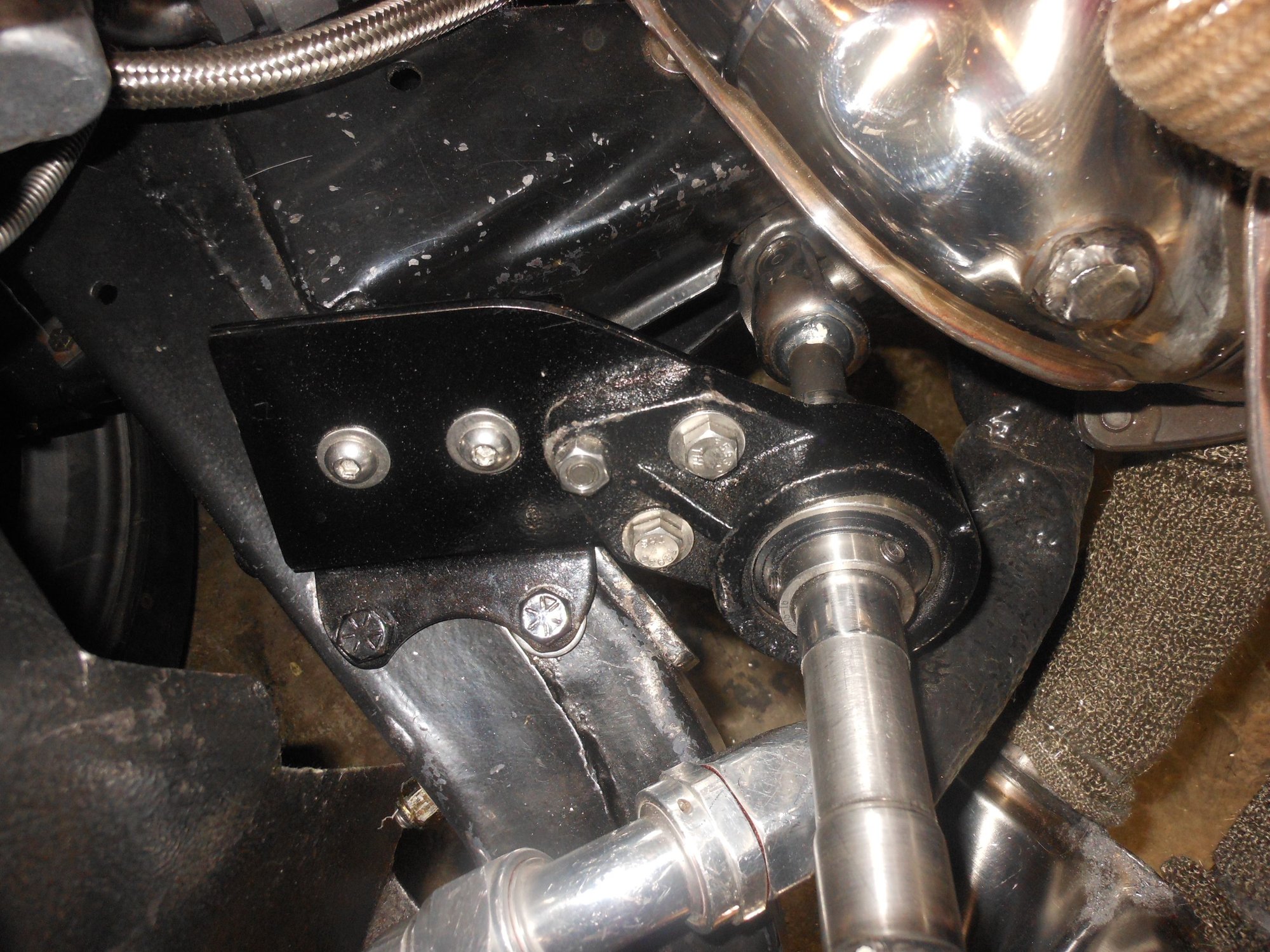

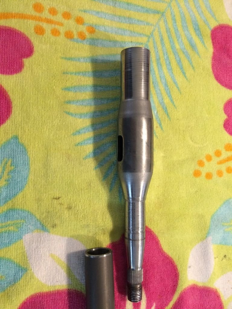

I also used a bearing for the steering shaft- so there is NO flex in the shaft-
One handed- holding the camera-
Flaming River R&P
Modded to fit my oil pan
Clearance Clarence
Tie rod ends

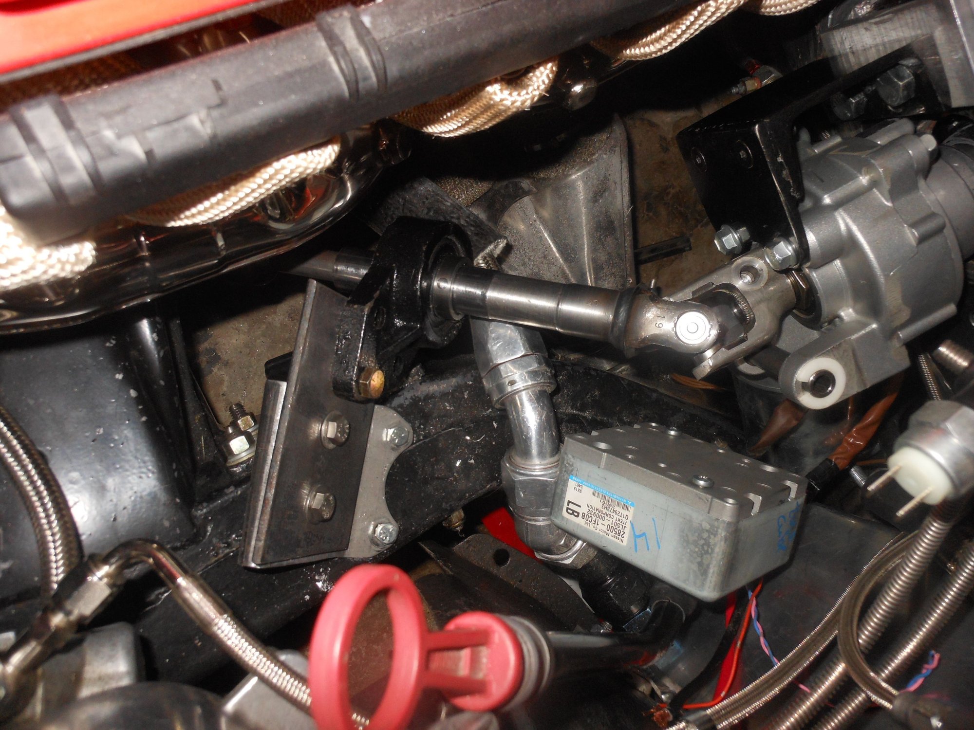

Bearing for steering shaft- shaft is collapsible
electric motor on end of sterling column
column
Adapter to stock steering shaft
Mounted on firewall- controller box is now mounted in car
