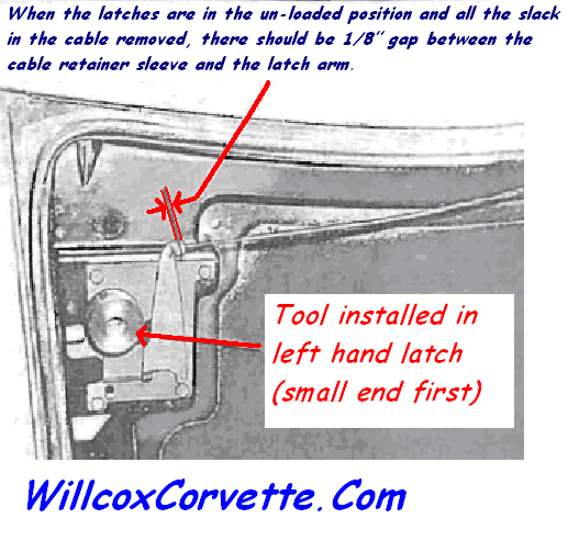

In the aim there is dimensions for making a wooden guide for the pin alignment. Willcox sells a machined aluminum guide I use every time my hood comes off. I also mark the hinge location to help as well

Assembly instruction Manual...its in notebook form with hard to read pictures and annotations. I was for the factory guys to assemble the cars. You can get reprints, some guys here have digital copies

heres the willcox page for sale
https://willcoxcorvette.com/hood-ali...tool-1968-1976
instructions
http://repairs.willcoxcorvette.com/1...ent-procedure/
