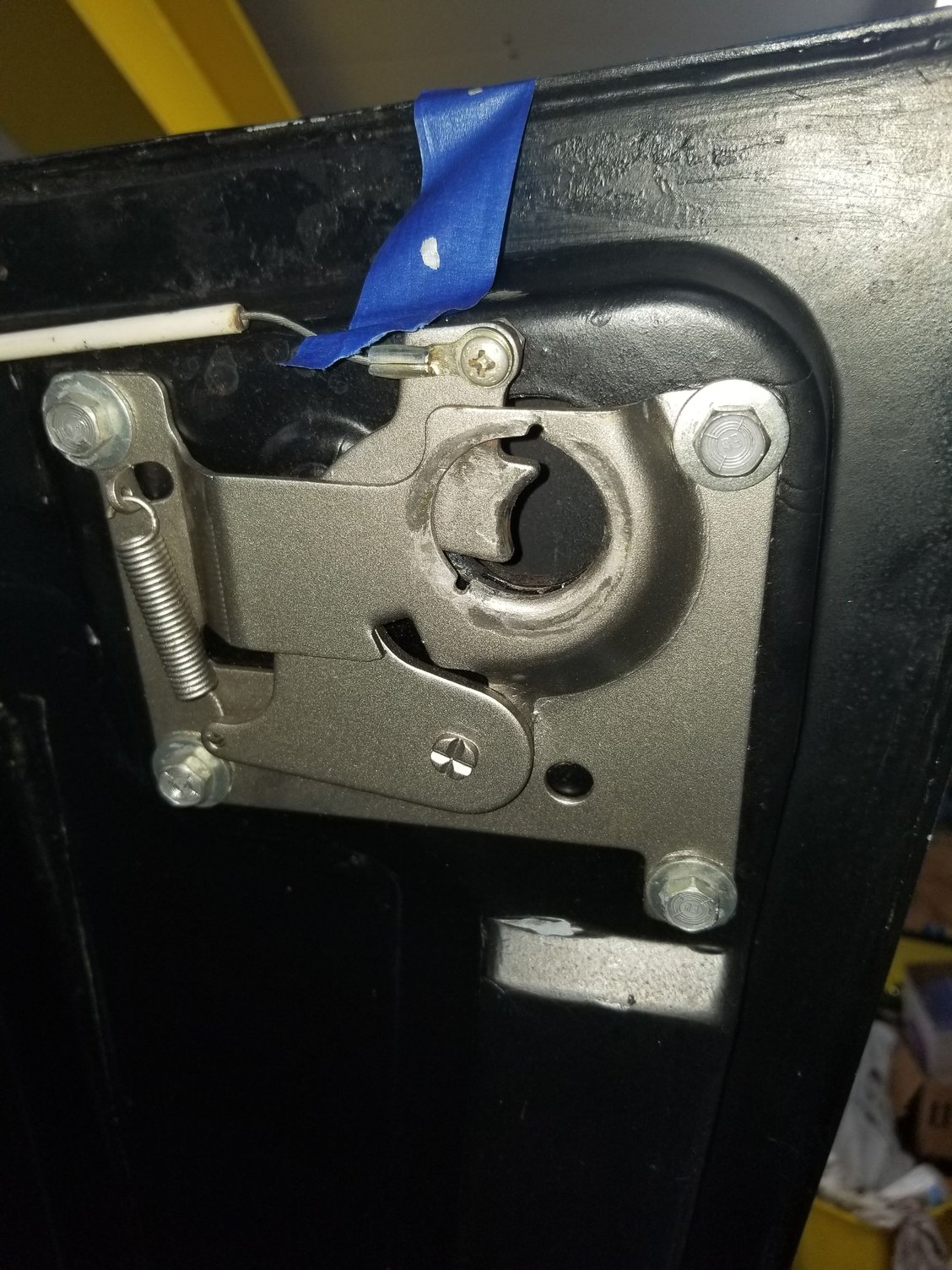

Hold on I'll go take some, that pic is not a 68 latch

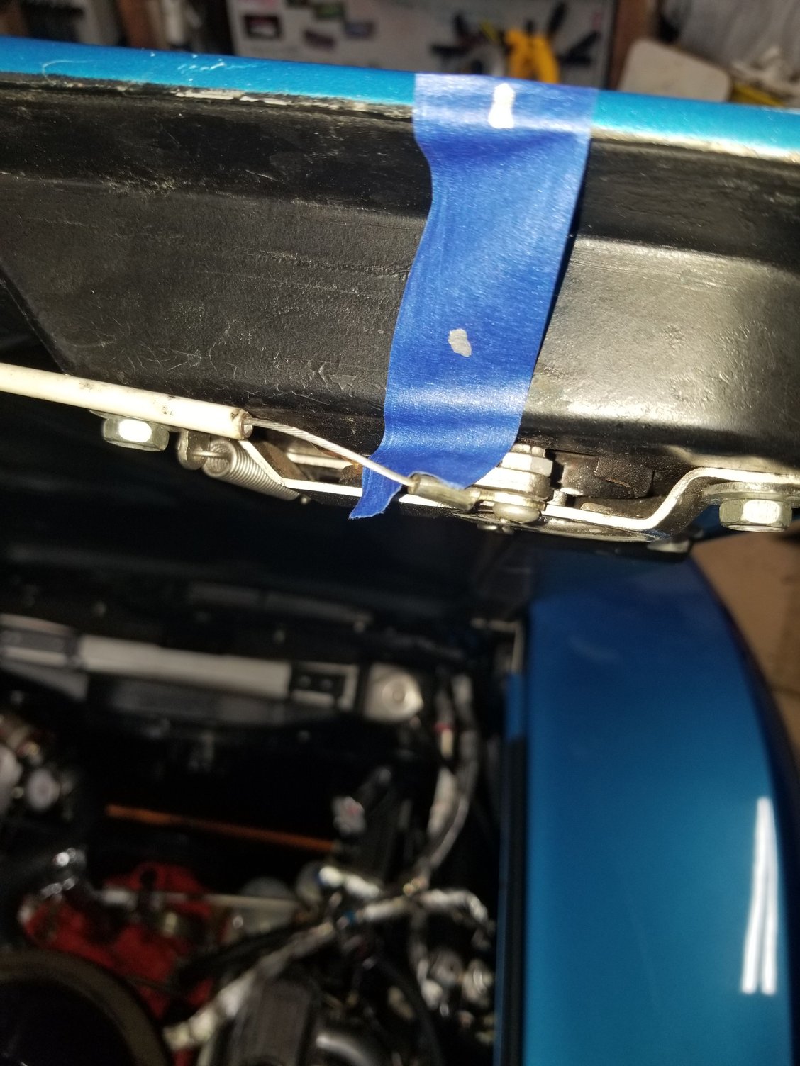

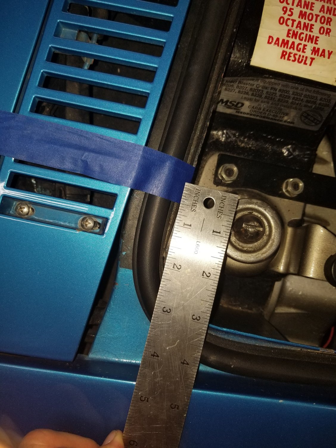

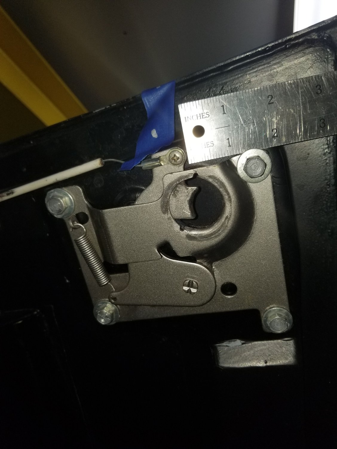

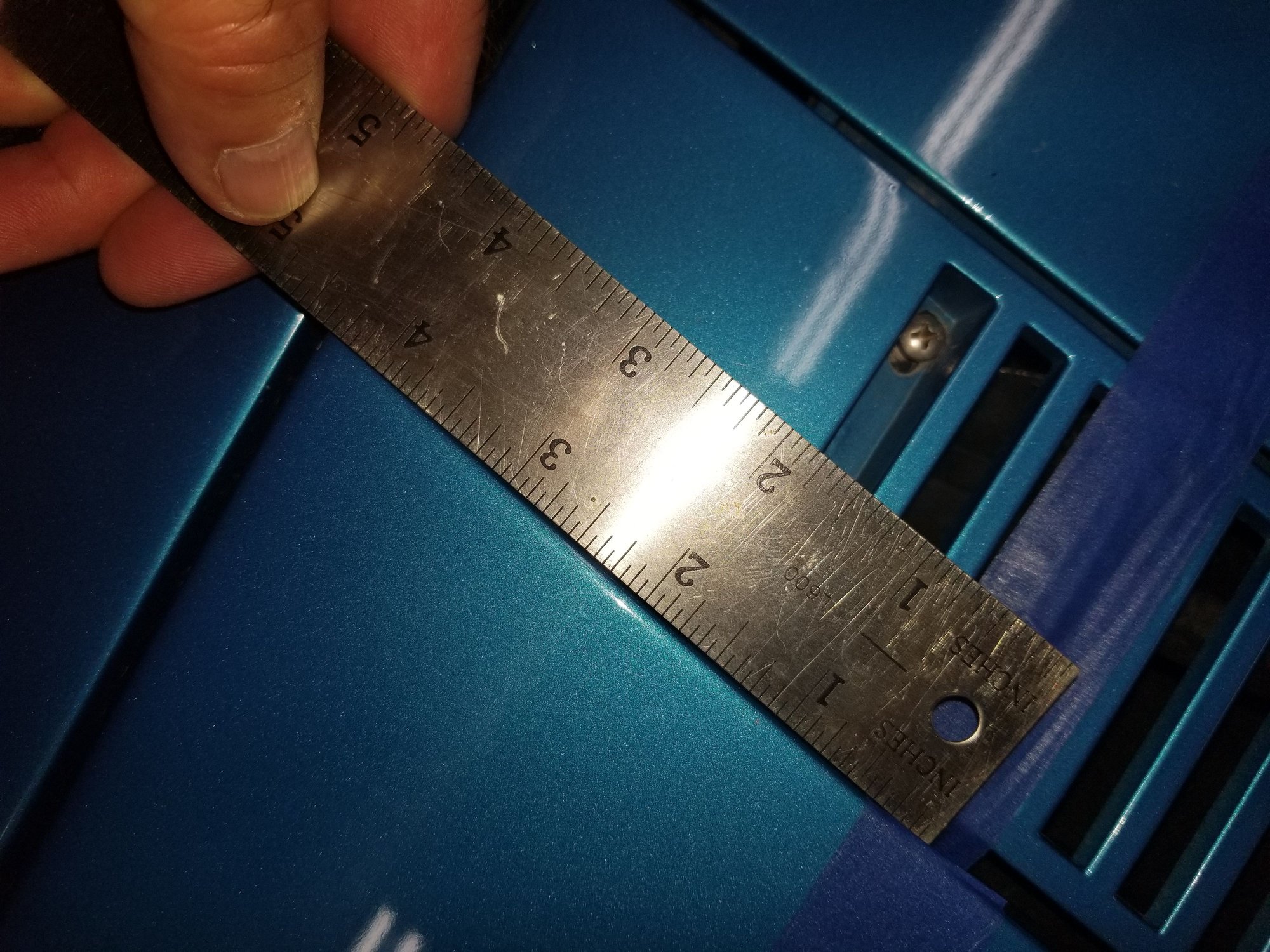

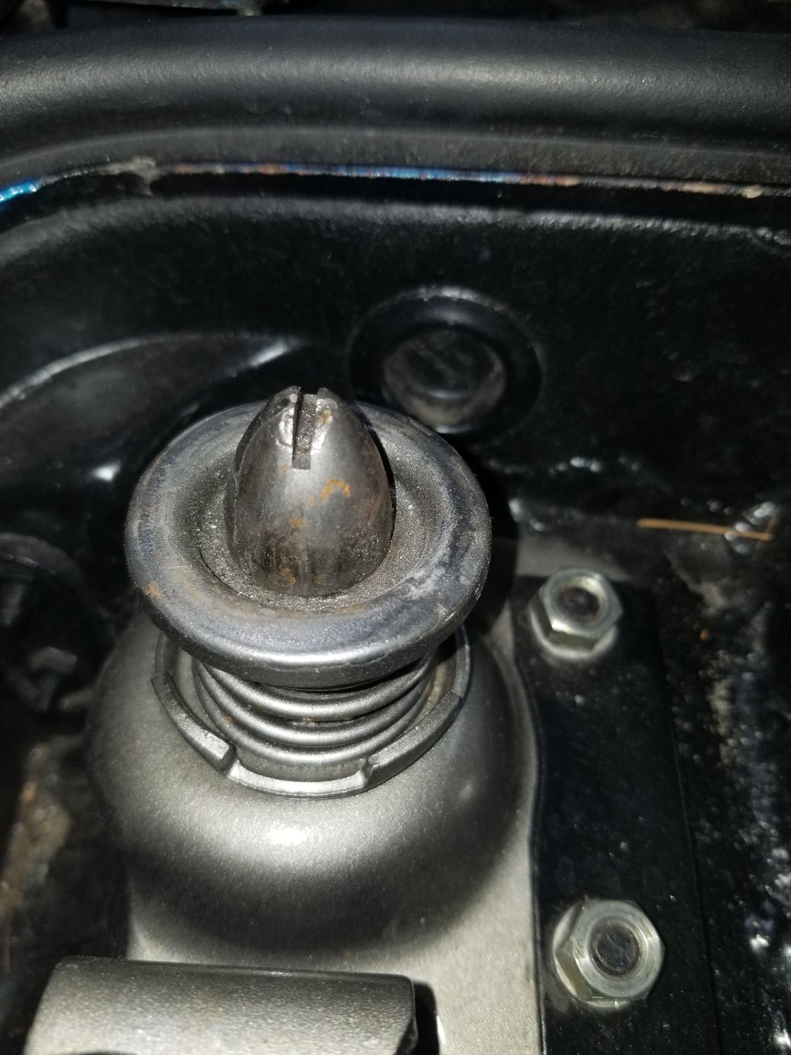

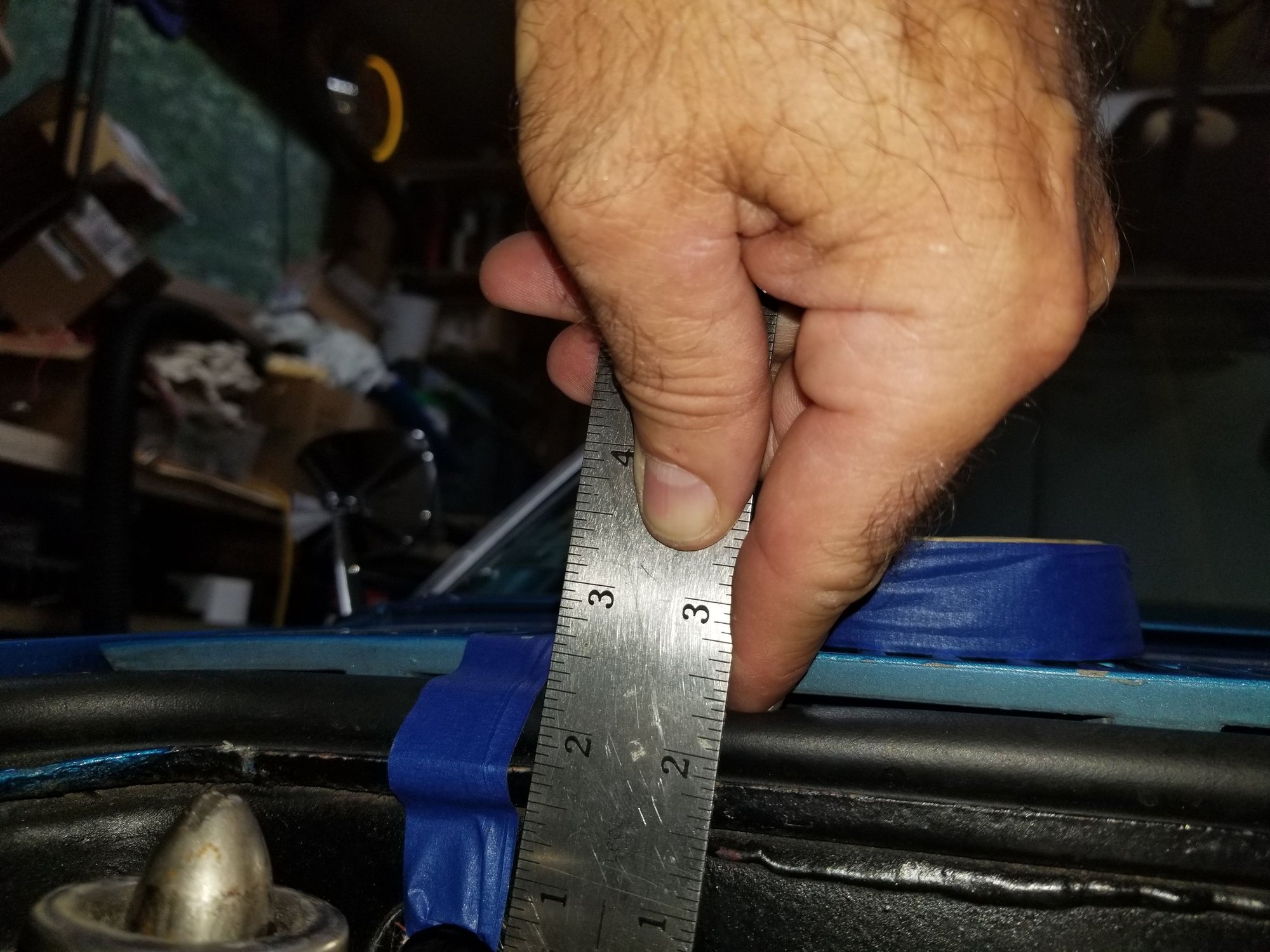

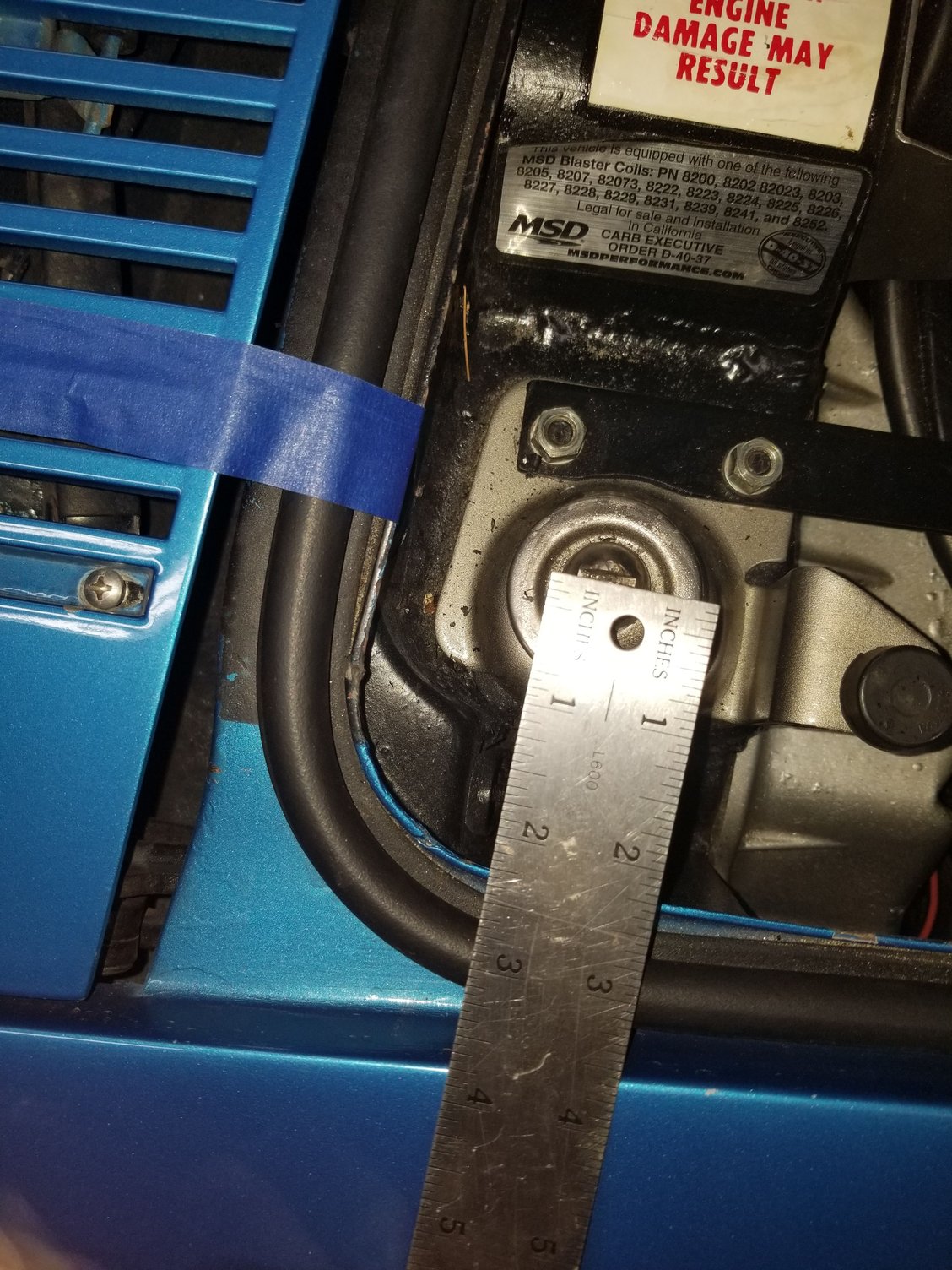

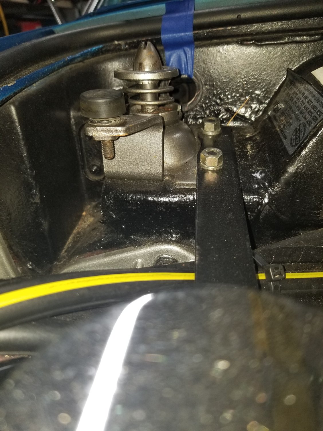

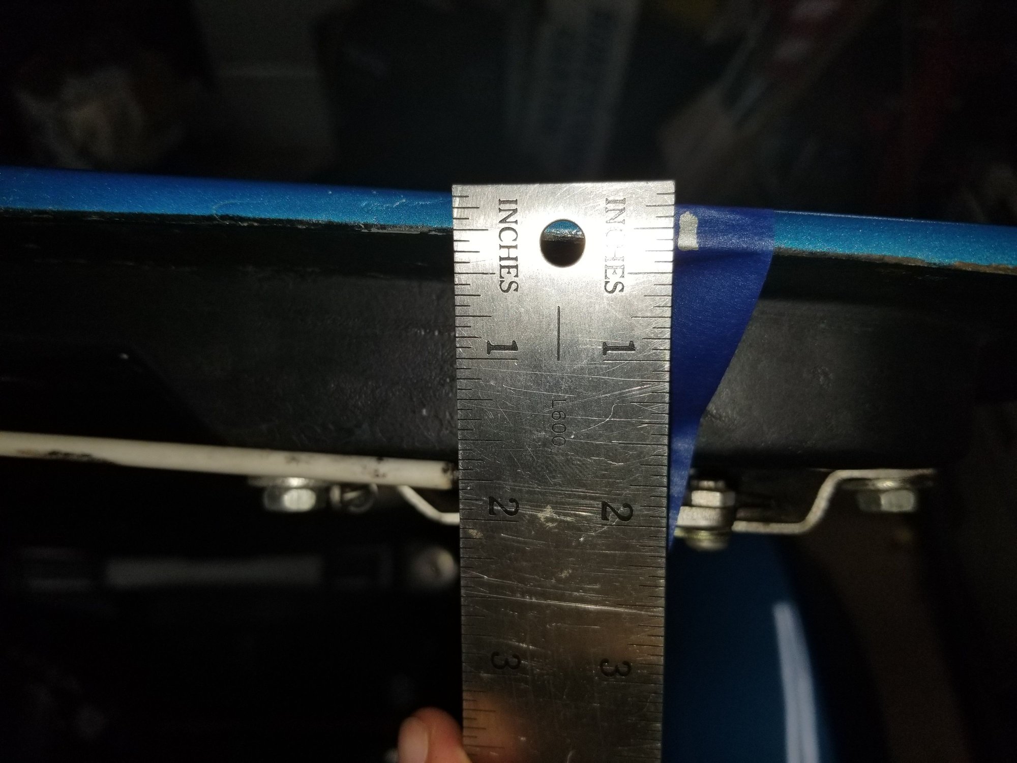

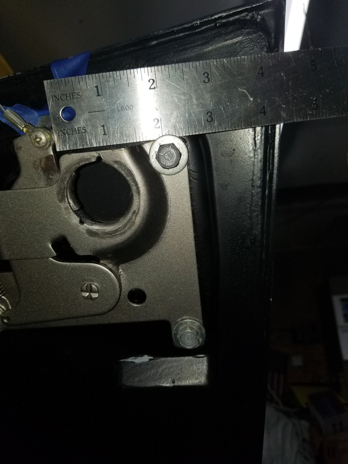

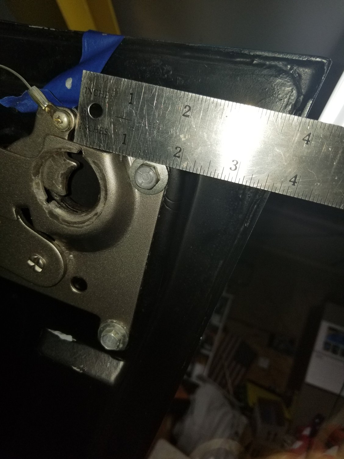

You can do it with a 6 inch haft screw driver on a 68...I added some measurements for anyone else with a, Quote Undesirable 68, end quote...from another thread by a clown
General placement of the hole..I'll add tape for reference Mark's .
Center of tape is center of the hole .
about 2 5/8 to the center
about 2 inches so you'll be angling up
so you need to angle up adn to the right with the flat edge of the blade vertical and would maybe need someone to press slightly down on the hood to relieve pressure on the lever
How far it has to move Its about half to 3/4 inch so your prying a good bit so dont pry against the firewall, its less than an 1/8th inch thick
