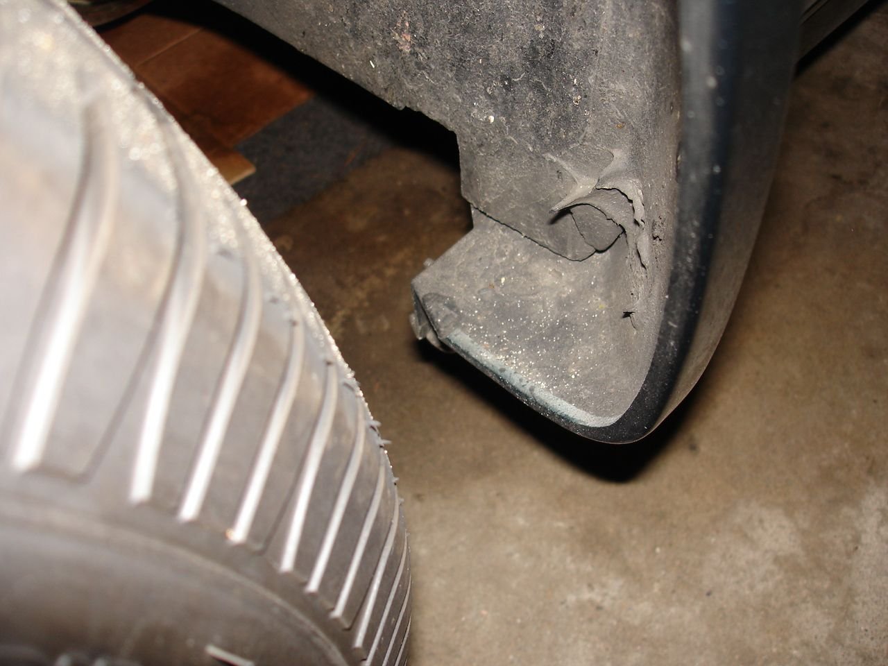

In 78 the standard was 225/70/15.
An option was the 255/60/15. If this was chosen the factory trimmed the front lip of the fender and the inside of the rear portion of the front fender opening. You could put 255/60/15 in the rear without a problem. The front is another question. If it was not trimmed it could mean a rub. Put your hand about 12 o'clock under the lip and run it forward. Does the lip disappear? is there a cut out on the rear portion like this, if so then the car probably came with 255/60/15:

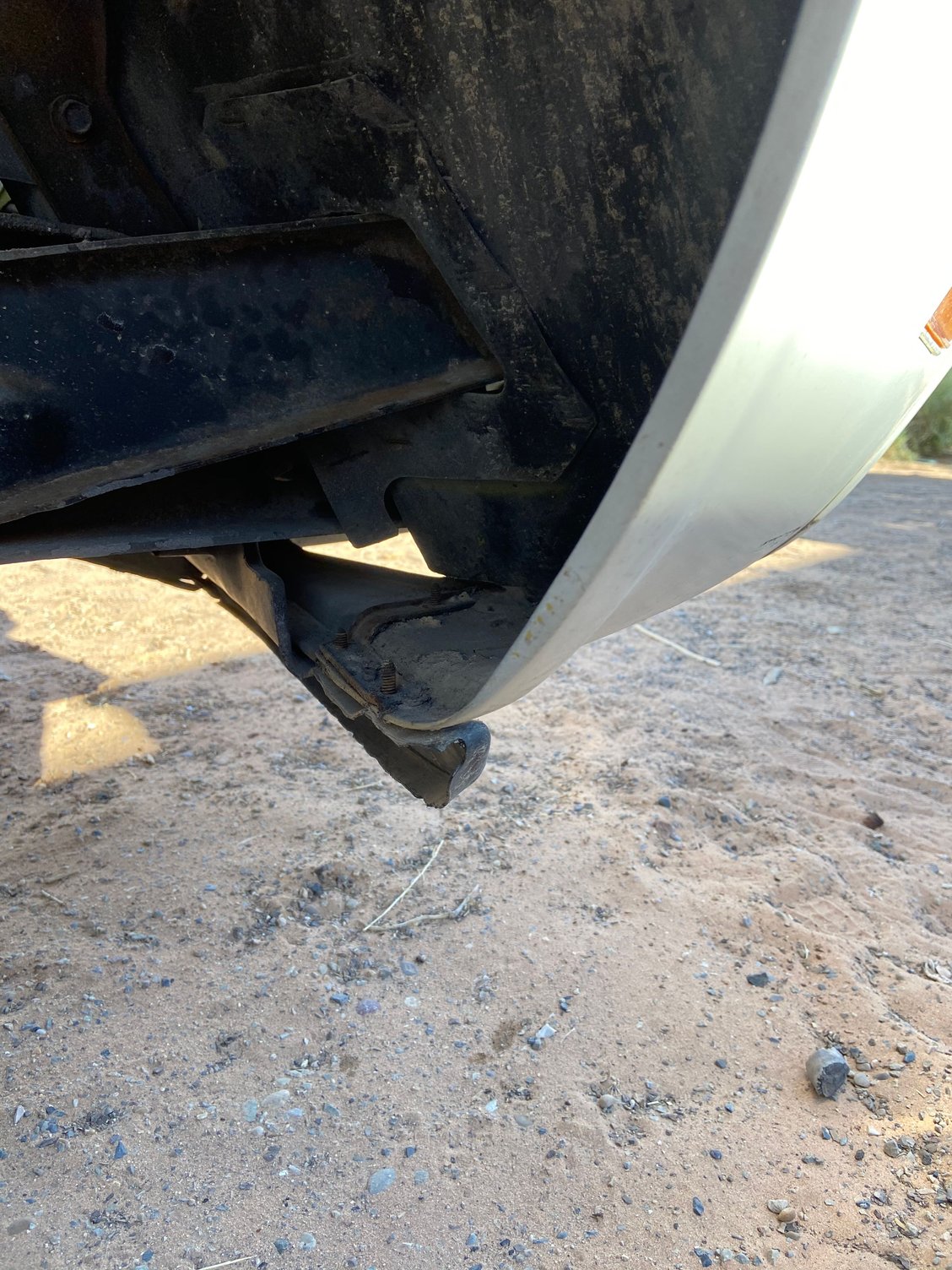

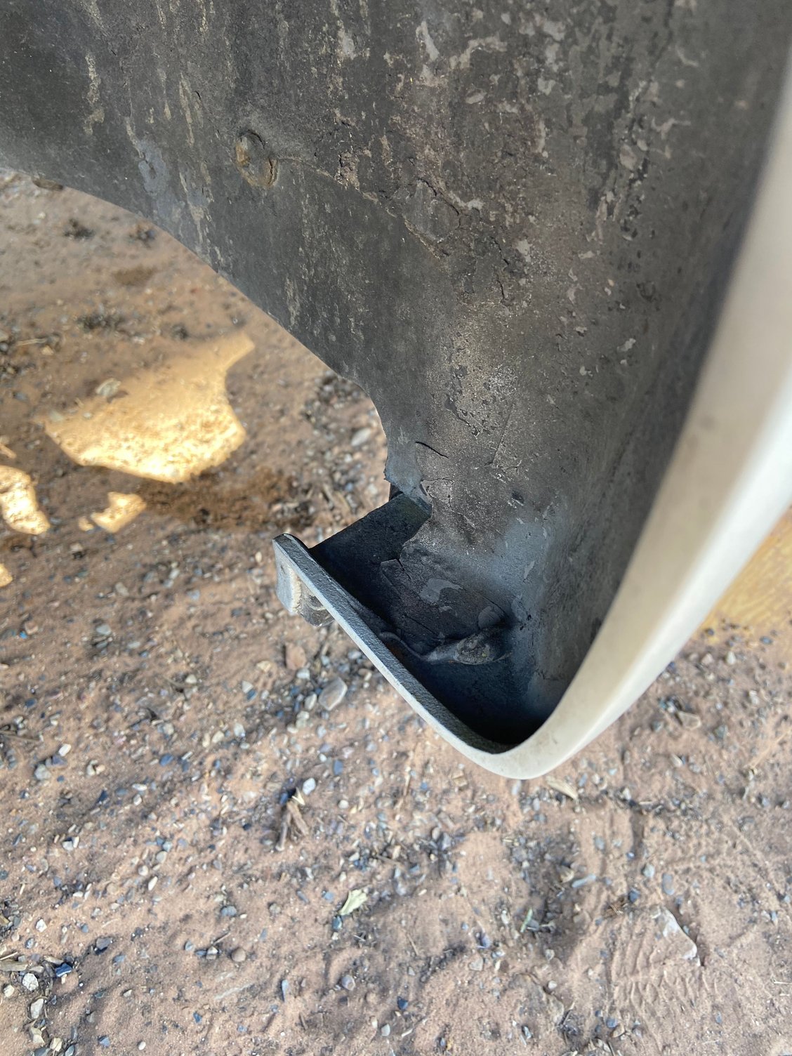

I’m going to go with the 235/60/15 all around, down the road I want to upgrade to fancier rims, I think that’s when I’ll put a bigger tire on the rear.
thanks for everyone’s input.
but I am curious if 255 would fit on the front
attached pics of the front fender
Front of front fender on passenger side
Back of front fender on drivers side

As you showed in the pics the fenders are not trimmed for 255/60s so that size not chosen at the time of the order. I could not find any explanation except to make clearance for turning. GM must have had some test results to have the workers take this extra step. In 80 they fixed the problem. So it is a crap shoot on whether they would be ok.
