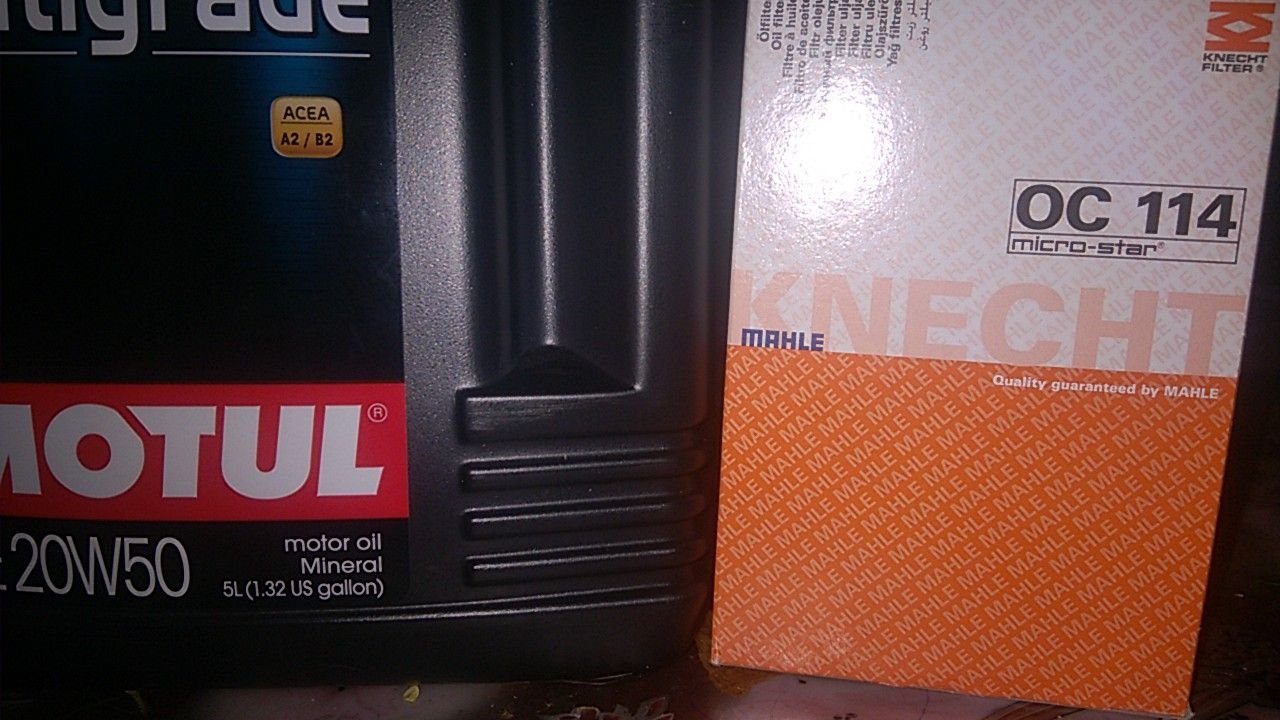

Old Aug 7, 2020 | 10:23 AM
planet-automobile's Avatar
planet-automobile
Joined: Mar 2018
Posts: 175
Likes: 5
From: France
Old Aug 7, 2020 | 10:34 AM
