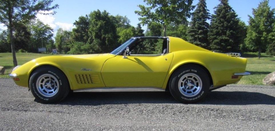

I had BFG Radial TA's 245/60-15 prior to replacing my wheels with 17" Torq Thrust II.
Had no problems with them, other than having them age out rather than wear out.

Same here, I ran the BF Goodrich P245R15's and loved them.
Switched to 17"ZR tires when I started exceeding the speed ratings of the 15".

235 mm wide tires are the widest that will not rub in front for ALL 1972 C3's. Lots of folks say they have 245's with no problem; some even get 255's to fit and not rub.
Personally, I like the look of 235R60-15's on my '71; 245R60-15's might fill the wheelwells a little better, but I don't want front tires to rub and I don't NEED anything wider than 235's.
