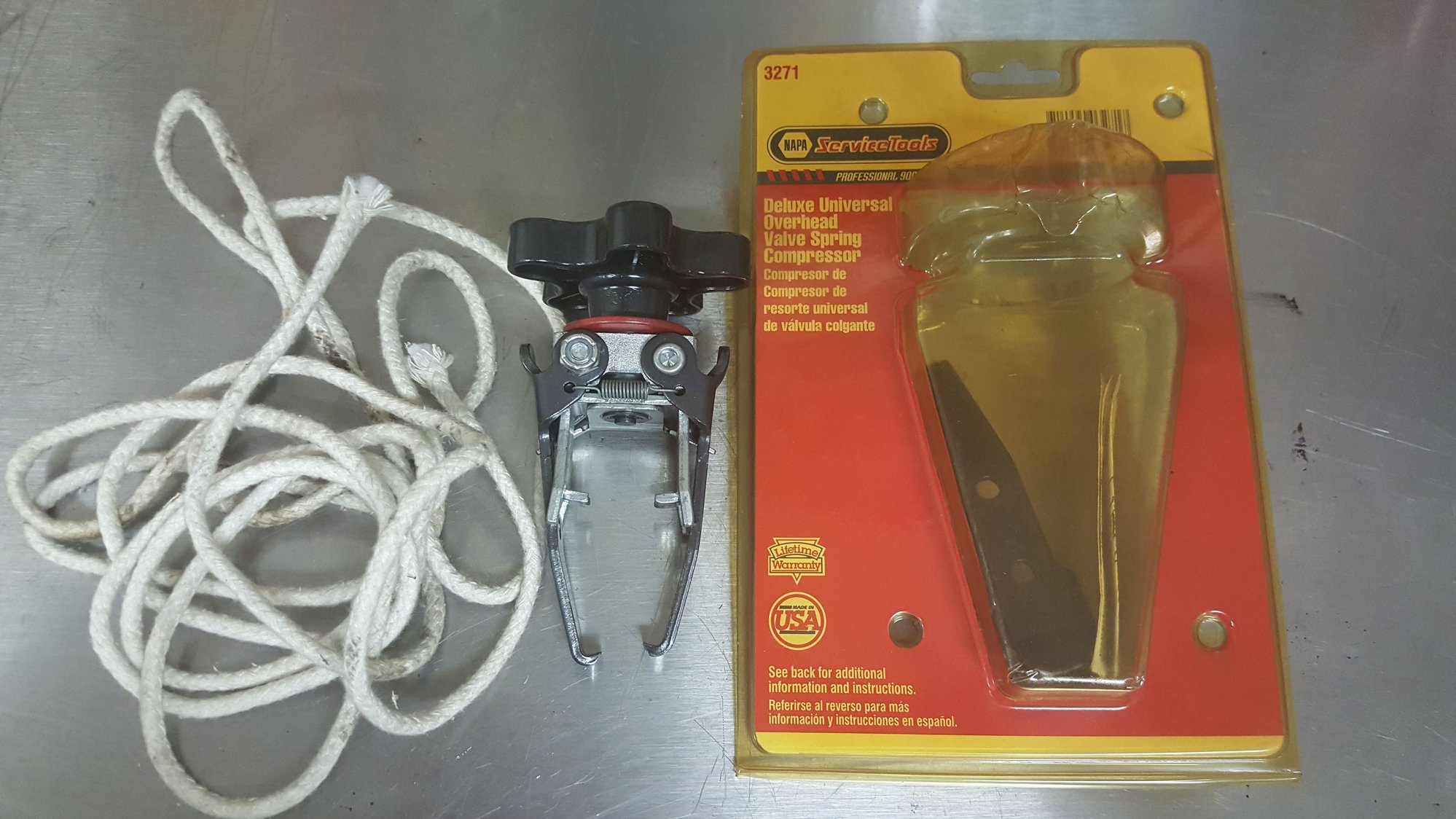

I would suggest using a piece of clothesline in the spark plug hole and rotating the engine until the piston compresses against the clothesline. Do one valve at a time so the rockers all go back on to the exact same valve.
I have quite a number of valve spring compressors but the one that has 2 claws that grab the bottom of the spring and screws down over the top of the valve to compress the spring is the right one to use here. MUCH better.
Cotton clothes line and spring compressor fom NAPA
