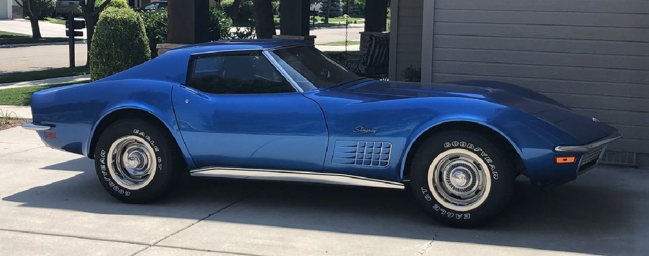

I too love the LT1/big block hoods. In doing some research, I found that aftermarket hoods very often have fitment issues. So I set out to find an actual GM LT1 hood (I didn't want to deal with filling the emblem holes on a BB hood). I finally got lucky and found a very nice one that I was able to get for a great price. Having it painted was the expensive part. To do it right the paint needs to be blended into the rest of the car. I ended up essentially repainting the entire front end and it cost me $2000. I didn't put LT1 stripes on it or anything. And I didn't do it because I thought it would enhance the value of the car (which it wont) or to try and make people think it had a BB. I did it because I like it.
Old Aug 17, 2020 | 11:40 AM
71 Green 454's Avatar
71 Green 454
Joined: Jun 2006
Posts: 6,400
Likes: 1,226
From: Tampa Florida
Looks great, love the blue!

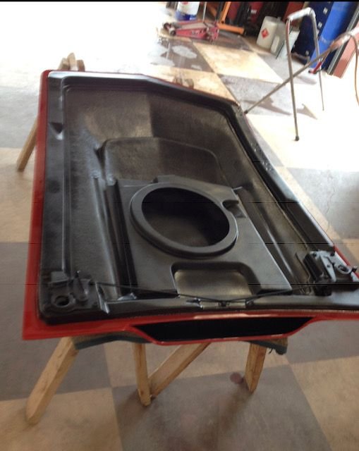

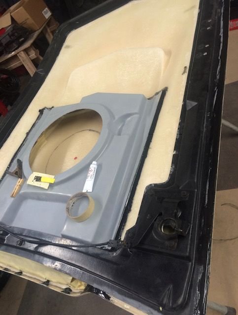

My good friend fitted and painted mine........we traded some work off but expect to pay about $1000-1200 to fit and spray......this is with the airbox.....which I recommend as it makes the hood much stronger and less flexy....if you look close at the one pic......he epoxied some Texas high fence wire along the back of the scoop for strength as this is an area known to droop......especially on the "long" L-88 hoods.....GM had a brace in there but it looks like **** to me......the wire/epoxy is ultra stiff......good idea on his behalf! He spent a lot of time around the back of the scoop and I requested that he did because you stare right at it driving.......
This is an A1 job.......I used to do this kind of work and wouldn't touch it for less than 1k.
BTW...this is an ACI hood and they are ALL I recommend after exhaustive research....the airbox came from Eckler's as ACI does not build one ironically.....
I kept the original hood in case someday I want to cut a hole in it for a tunnel ram
