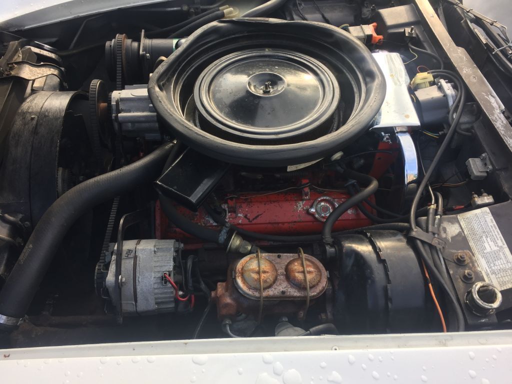

Definately paint. Gloss black ( but not to the point where you see your reflection)...it would match up with the power brake booster if the car has it. You wanted a bone stock original 74? Here's a really nice unrestored original (except for the belts). You can still see the gloss black on both the air cleaner assembly and PB booster. No decals on the original lids.

Great pics! Thank you!

Nothing in a C3 engine compartment was ever painted GLOSS black. All the 'components' were painted semi-gloss black and all 'surfaces' were painted semi-FLAT or satin black.
