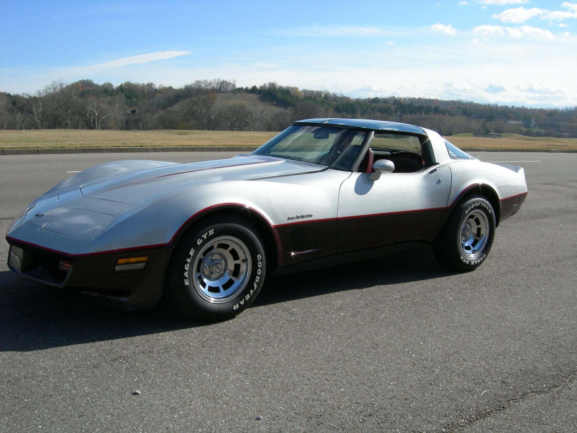

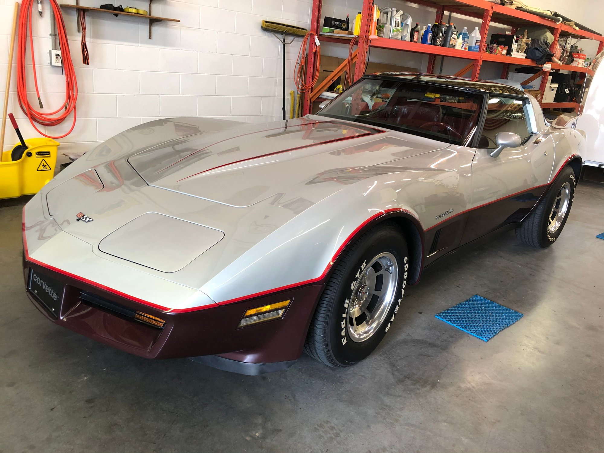

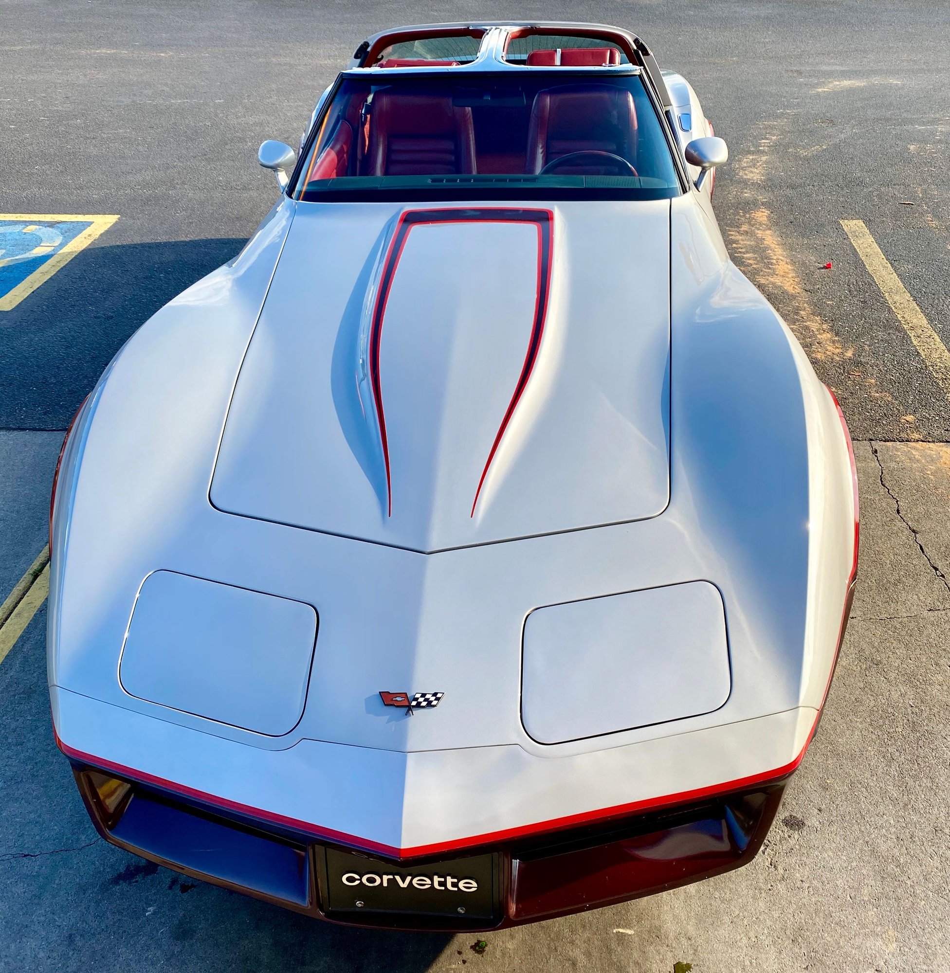

ordered Dewitt natural finish, would have preferred black. But mostly want it to work
1982 original paint n decals
friend had it for 29 years

Nice!!! What a great example of a C3 that's been well cared for. Beautiful car. You'll like the Dewitt's.
