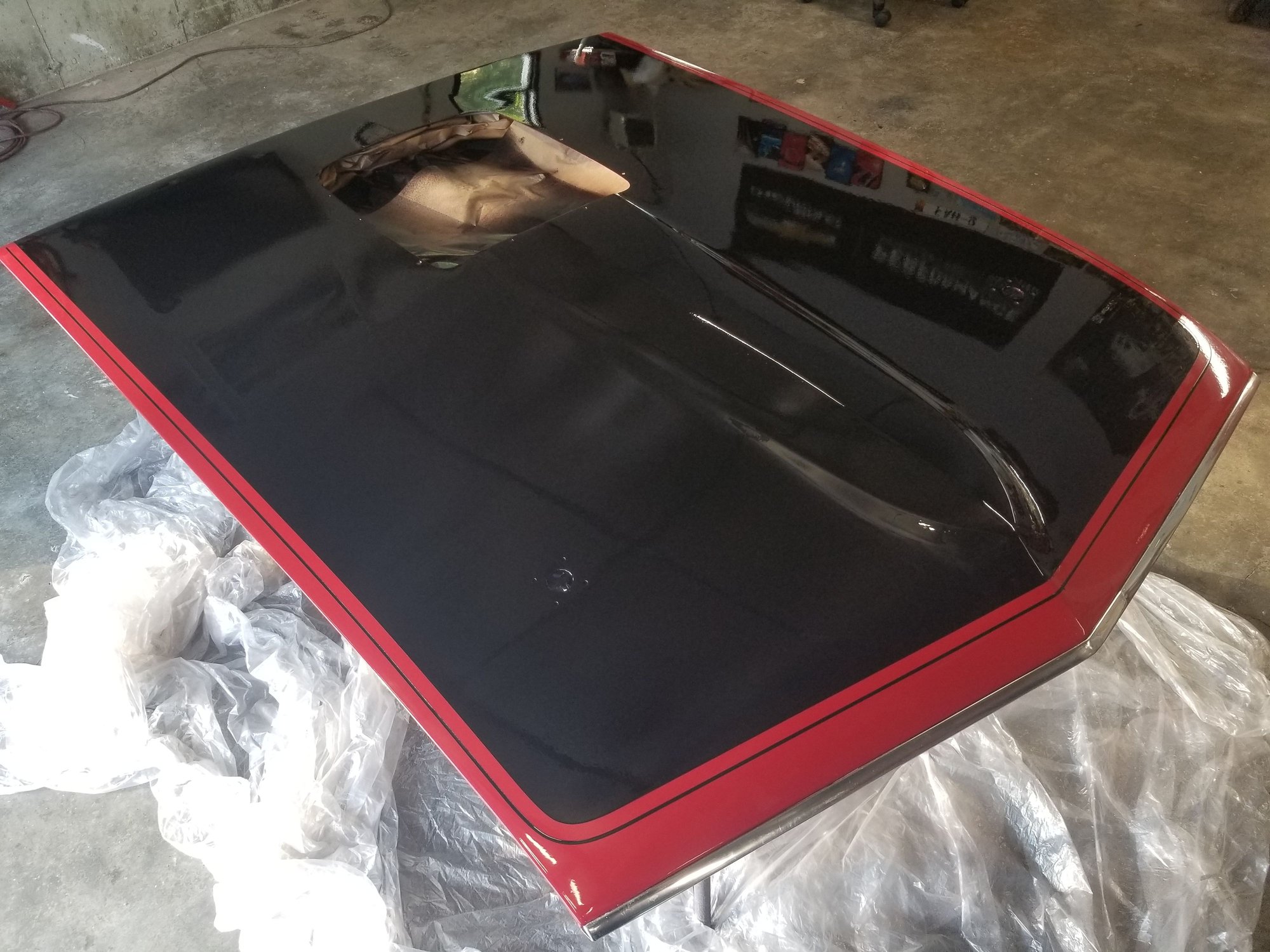

Originally Posted by Dynra Rockets
Laying color is the easiest part of a paint job. I had 240+ hours of prep work in another fiberglass car I own. Final spraying took only about 2 hours.
Orange peel management is about proper thinning and how hot the hardener is so the paint can flow before curing.
After getting ridiculous $ quotes from body shops I ended up doing it all in my garage myself. Watched some youtube vids and practiced on some junk I had laying around. Used urethane 2 stage. Color coat went on without issue. Clear did have some minor orange peel and "trash' in it but that is why you lay down 3 coats of clear so you can cut one off to make perfect.
R

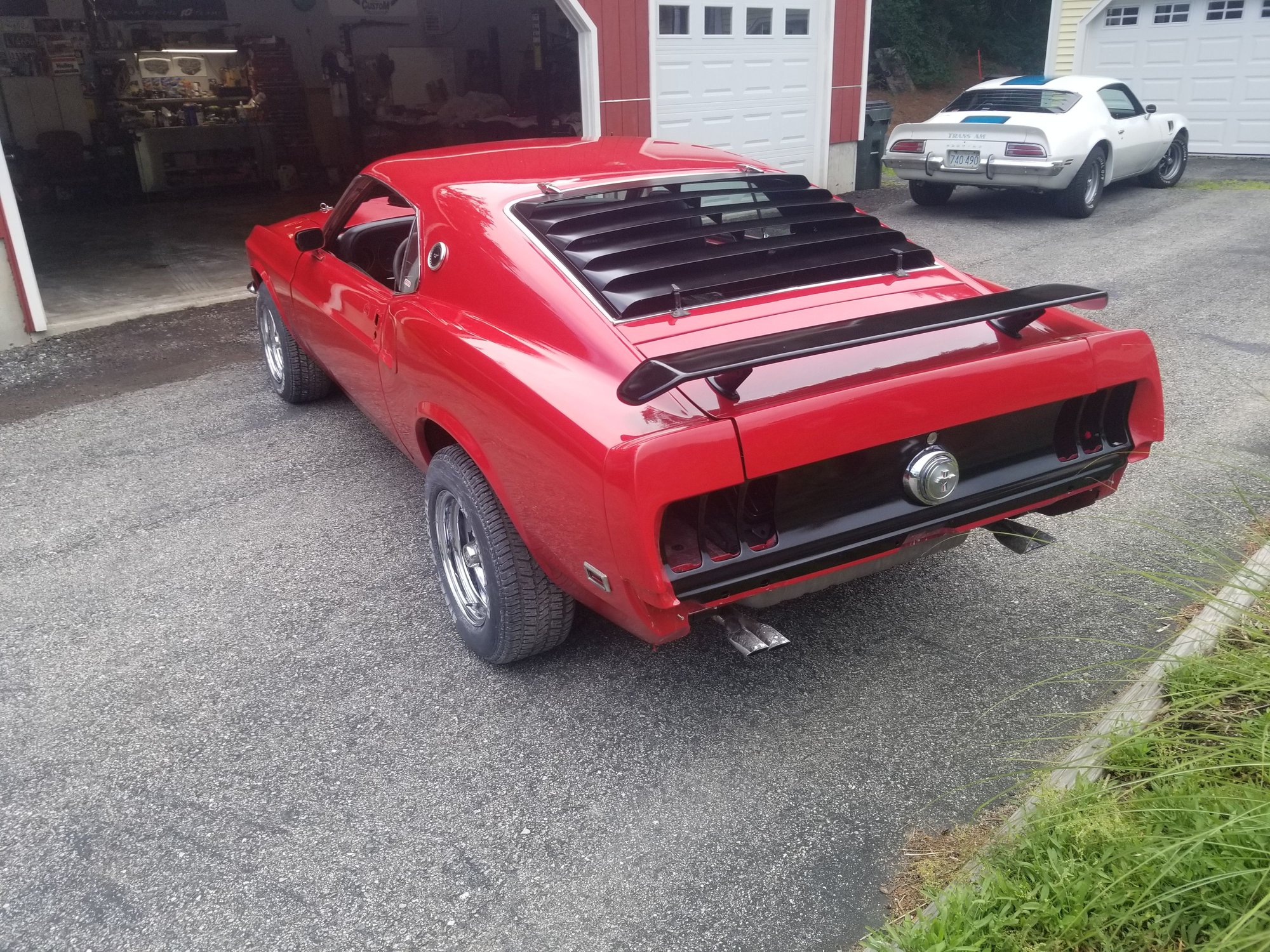

I did the exact same thing. Bought all my supplies locally and painted ot myself. Color laid down perfectly, the clear laid down with plenty of orange peel. Spent the weekend wet sanding and buffing.
Wow - I gotta tell you that those 69/70 Mustang fastbacks are some eye catching cars. Love them and the chrome bumper C3s - only later did I find out SHinoda had a hand in both designs.
