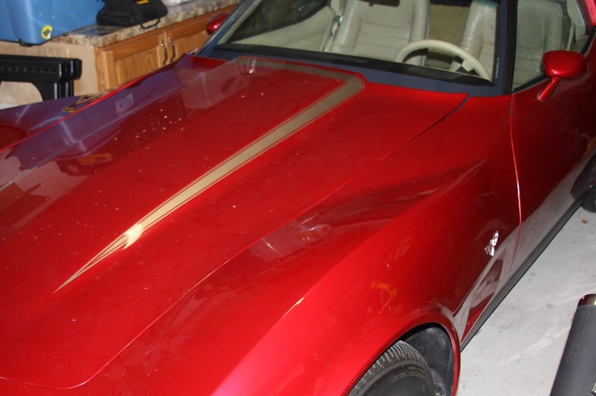

Looks like I'll need to take some pics in daylight after washing the car. Here's a quick pic, but the flash makes it look like a much lighter red, and the car is filthy. Can't reallt see much!

You are right pics always look better...
but that looks pretty good..you need to see how much clear is on it..
gently color sand peel and buff out a small area like lower fender..tape off sharp edges or be very careful with buffer...
start with 2000 grit and see if results acceptable to you...
the good part is if you cut through it wont rust 😳
matching that color will not be easy..a true candy has two clears first ne tinted and or flake..
the bumpers if they really bother you can be removed and replaced or fixed but matchingtough..again try sanding you may be satified enough

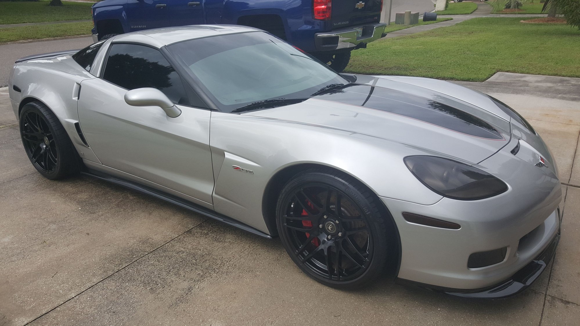

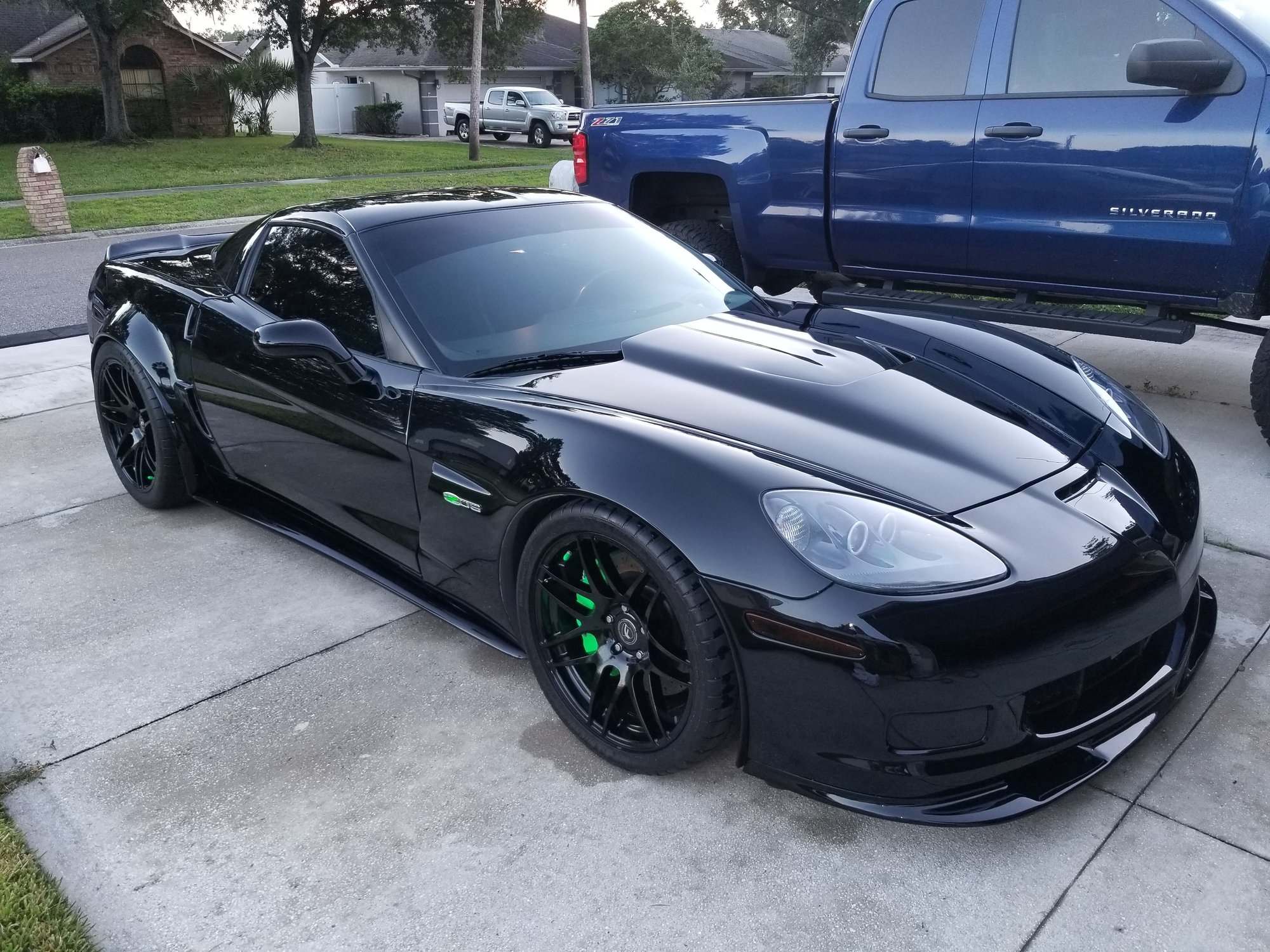

Ill start off with im just a wannabe a c3 guy, but since this isnt necessarily a generational thing ill put my 2 cents in.
Id cut and buff the paint you have, if for no other reason then to practice your skills and enjoy your car. If your still wanting it in black then I understand. Dont let anybody talk you out of it. I cant stress this enough, do not "cheap out" on any of the materials you use to make that paint job happen.
Use quality body filler, quality primer, quality sealer, quality gun and quality paint. Id recommend glasurit, ppg or house of kolor for your paint. Be patient with the prep and use a guide coat to block with so you know its straight. Lastly dont be afraid to try, remember its just paint. A good job can happen in your garage with the right materials and patience. Im attaching before and after photos of my c6, because like you I wanted black as well.
before
after
Good luck with your project.

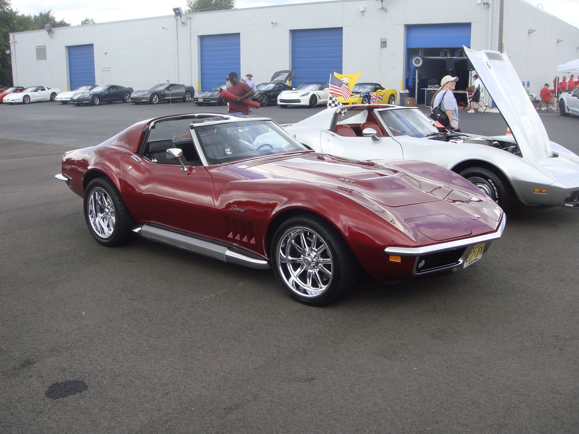

Maaco can do excellent paint jobs. After all they spray all the time. It's the prep work and the polish work you should have done somewhere else. That's where time makes a big difference. ( And that wetsand and polish work may not ever have been done to your car and may be all it currently needs)
Case in point. My friend's 69 was sprayed at the local Maaco, under direction from the local Corvette shop. After buffing, and detailing by an expert, it won first place at Corvette Carlisle in the modified category: The mods are subtle and stunning and so is the paint.
