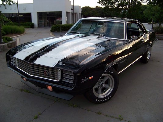

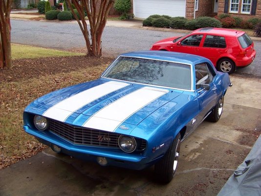

69 Z's are a lot of fun IF they were ordered with the correct gears and trans eg. M20's and 4.10's/4.56's...
Go from M20 and 4.10's to M21 and 3.73 and you will swear the EMERGENCY BRAKE IS ON... or someone threw out an anchor.
M21 with 3.73's gives you an effective first gear of 8.223 to 1.
M20 with 4.10's gives you an effective first gear of 10.332 to 1 --- 25% better first gear to get the mass moving!
Both of my 69 Z's had M20 4.10 combos.. all this talk about DZ's has me itching for another 69 Z.... damn it man!
