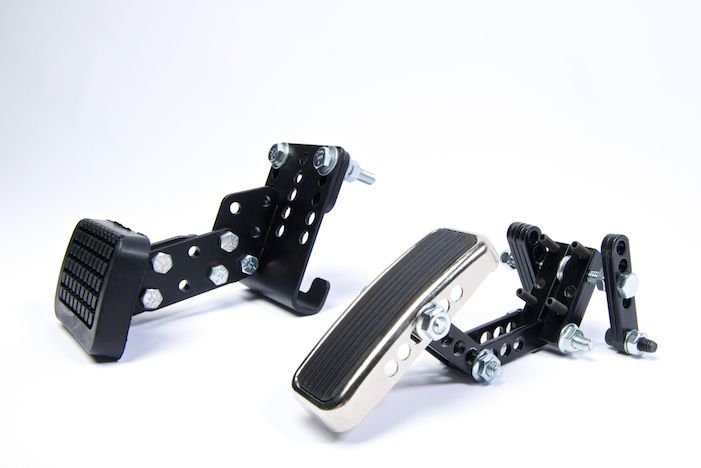

Here's something you might look into.
https://www.creativemobilitygroup.co...pedal-mates-2/
Old Sep 1, 2020 | 09:09 PM
7T1vette's Avatar
7T1vette
Posts: 37,637
Likes: 3,117
From: Crossville TN
There you go! Legitimate and SAFE pedal extensions....
